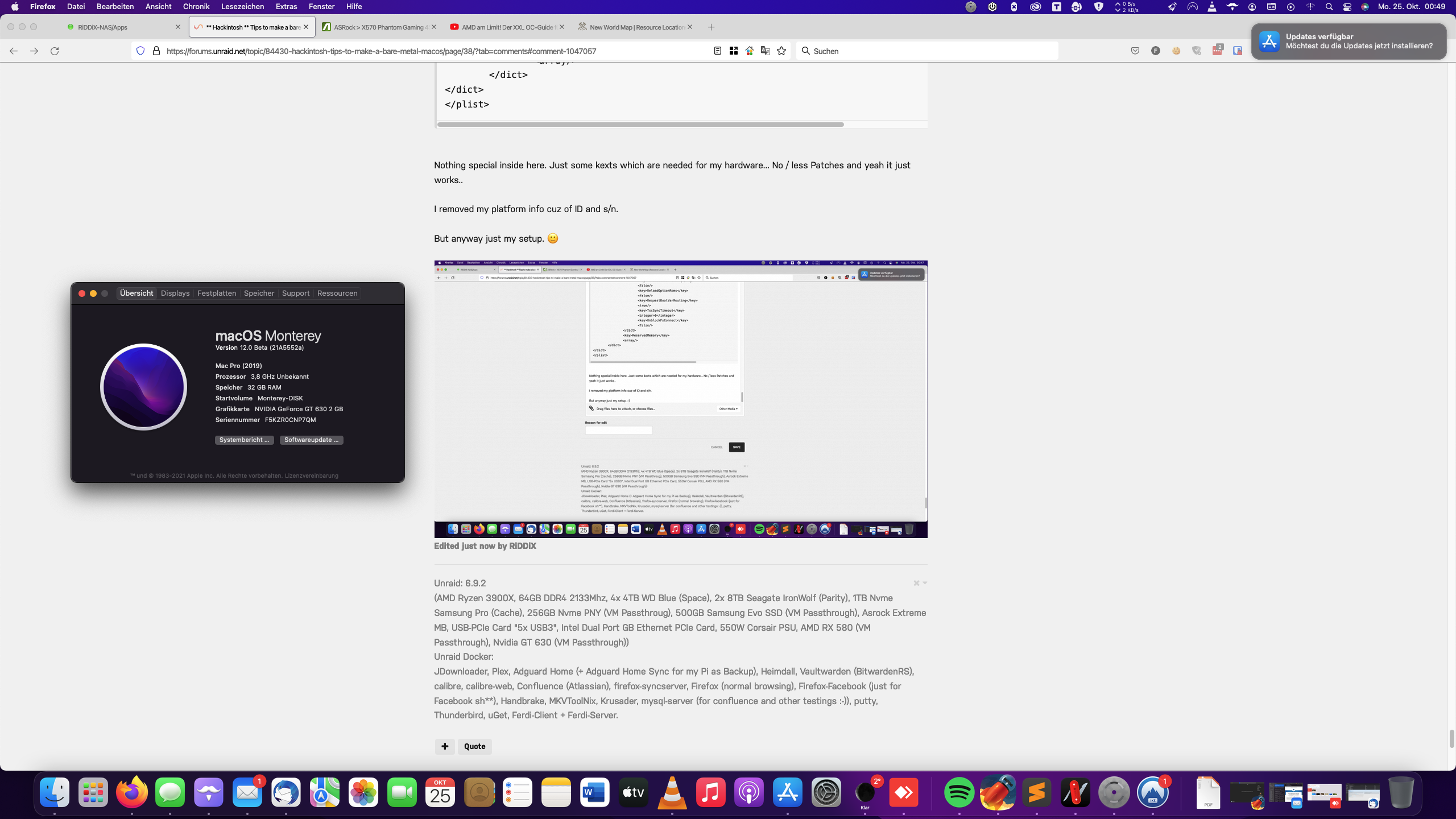

  14. <?xml version="1.0" encoding="UTF-8"?> <!DOCTYPE plist PUBLIC "-//Apple//DTD PLIST 1.0//EN" "http://www.apple.com/DTDs/PropertyList-1.0.dtd"> <plist version="1.0"> <dict> <key>ACPI</key> <dict> <key>Add</key> <array> <dict> <key>Comment</key> <string></string> <key>Enabled</key> <true/> <key>Path</key> <string>SSDT-PLUG.aml</string> </dict> <dict> <key>Comment</key> <string></string> <key>Enabled</key> <true/> <key>Path</key> <string>SSDT-GFX.aml</string> </dict> <dict> <key>Comment</key> <string></string> <key>Enabled</key> <true/> <key>Path</key> <string>SSDT-ARPT.aml</string> </dict> <dict> <key>Comment</key> <string></string> <key>Enabled</key> <true/> <key>Path</key> <string>SSDT-XGE.aml</string> </dict> <dict> <key>Comment</key> <string></string> <key>Enabled</key> <true/> <key>Path</key> <string>SSDT-NVME.aml</string> </dict> <dict> <key>Comment</key> <string></string> <key>Enabled</key> <true/> <key>Path</key> <string>SSDT-XHC.aml</string> </dict> <dict> <key>Comment</key> <string></string> <key>Enabled</key> <true/> <key>Path</key> <string>SSDT-EC-USBX-DESKTOP.aml</string> </dict> </array> <key>Delete</key> <array/> <key>Patch</key> <array/> <key>Quirks</key> <dict> <key>FadtEnableReset</key> <false/> <key>NormalizeHeaders</key> <false/> <key>RebaseRegions</key> <false/> <key>ResetHwSig</key> <false/> <key>ResetLogoStatus</key> <true/> <key>SyncTableIds</key> <false/> </dict> </dict> <key>Booter</key> <dict> <key>MmioWhitelist</key> <array/> <key>Patch</key> <array/> <key>Quirks</key> <dict> <key>AllowRelocationBlock</key> <false/> <key>AvoidRuntimeDefrag</key> <true/> <key>DevirtualiseMmio</key> <false/> <key>DisableSingleUser</key> <false/> <key>DisableVariableWrite</key> <false/> <key>DiscardHibernateMap</key> <false/> <key>EnableSafeModeSlide</key> <true/> <key>EnableWriteUnprotector</key> <false/> <key>ForceBooterSignature</key> <false/> <key>ForceExitBootServices</key> <false/> <key>ProtectMemoryRegions</key> <false/> <key>ProtectSecureBoot</key> <false/> <key>ProtectUefiServices</key> <false/> <key>ProvideCustomSlide</key> <true/> <key>ProvideMaxSlide</key> <integer>0</integer> <key>RebuildAppleMemoryMap</key> <true/> <key>SetupVirtualMap</key> <true/> <key>SignalAppleOS</key> <false/> <key>SyncRuntimePermissions</key> <true/> </dict> </dict> <key>DeviceProperties</key> <dict> <key>Add</key> <dict/> <key>Delete</key> <dict/> </dict> <key>Kernel</key> <dict> <key>Add</key> <array> <dict> <key>Arch</key> <string>Any</string> <key>BundlePath</key> <string>Lilu.kext</string> <key>Comment</key> <string></string> <key>Enabled</key> <true/> <key>ExecutablePath</key> <string>Contents/MacOS/Lilu</string> <key>MaxKernel</key> <string></string> <key>MinKernel</key> <string></string> <key>PlistPath</key> <string>Contents/Info.plist</string> </dict> <dict> <key>Arch</key> <string>Any</string> <key>BundlePath</key> <string>WhateverGreen.kext</string> <key>Comment</key> <string></string> <key>Enabled</key> <true/> <key>ExecutablePath</key> <string>Contents/MacOS/WhateverGreen</string> <key>MaxKernel</key> <string></string> <key>MinKernel</key> <string></string> <key>PlistPath</key> <string>Contents/Info.plist</string> </dict> <dict> <key>Arch</key> <string>Any</string> <key>BundlePath</key> <string>BlueToolFixup.kext</string> <key>Comment</key> <string></string> <key>Enabled</key> <true/> <key>ExecutablePath</key> <string>Contents/MacOS/BlueToolFixup</string> <key>MaxKernel</key> <string></string> <key>MinKernel</key> <string></string> <key>PlistPath</key> <string>Contents/Info.plist</string> </dict> <dict> <key>Arch</key> <string>Any</string> <key>BundlePath</key> <string>AppleALC.kext</string> <key>Comment</key> <string></string> <key>Enabled</key> <true/> <key>ExecutablePath</key> <string>Contents/MacOS/AppleALC</string> <key>MaxKernel</key> <string></string> <key>MinKernel</key> <string></string> <key>PlistPath</key> <string>Contents/Info.plist</string> </dict> <dict> <key>Arch</key> <string>Any</string> <key>BundlePath</key> <string>RestrictEvents.kext</string> <key>Comment</key> <string></string> <key>Enabled</key> <true/> <key>ExecutablePath</key> <string>Contents/MacOS/RestrictEvents</string> <key>MaxKernel</key> <string></string> <key>MinKernel</key> <string></string> <key>PlistPath</key> <string>Contents/Info.plist</string> </dict> </array> <key>Block</key> <array/> <key>Emulate</key> <dict> <key>Cpuid1Data</key> <data>VwYFAAAAAAAAAAAAAAAAAA==</data> <key>Cpuid1Mask</key> <data>/////wAAAAAAAAAAAAAAAA==</data> <key>DummyPowerManagement</key> <false/> <key>MaxKernel</key> <string></string> <key>MinKernel</key> <string></string> </dict> <key>Force</key> <array/> <key>Patch</key> <array/> <key>Quirks</key> <dict> <key>AppleCpuPmCfgLock</key> <false/> <key>AppleXcpmCfgLock</key> <false/> <key>AppleXcpmExtraMsrs</key> <false/> <key>AppleXcpmForceBoost</key> <false/> <key>CustomSMBIOSGuid</key> <false/> <key>DisableIoMapper</key> <false/> <key>DisableLinkeditJettison</key> <true/> <key>DisableRtcChecksum</key> <false/> <key>ExtendBTFeatureFlags</key> <false/> <key>ExternalDiskIcons</key> <false/> <key>ForceSecureBootScheme</key> <false/> <key>IncreasePciBarSize</key> <false/> <key>LapicKernelPanic</key> <false/> <key>LegacyCommpage</key> <false/> <key>PanicNoKextDump</key> <false/> <key>PowerTimeoutKernelPanic</key> <false/> <key>ProvideCurrentCpuInfo</key> <true/> <key>SetApfsTrimTimeout</key> <integer>-1</integer> <key>ThirdPartyDrives</key> <false/> <key>XhciPortLimit</key> <false/> </dict> <key>Scheme</key> <dict> <key>CustomKernel</key> <false/> <key>FuzzyMatch</key> <true/> <key>KernelArch</key> <string>x86_64</string> <key>KernelCache</key> <string>Auto</string> </dict> </dict> <key>Misc</key> <dict> <key>BlessOverride</key> <array/> <key>Boot</key> <dict> <key>ConsoleAttributes</key> <integer>0</integer> <key>HibernateMode</key> <string>None</string> <key>HideAuxiliary</key> <false/> <key>LauncherOption</key> <string>Disabled</string> <key>LauncherPath</key> <string>Default</string> <key>PickerAttributes</key> <integer>1</integer> <key>PickerAudioAssist</key> <false/> <key>PickerMode</key> <string>Builtin</string> <key>PickerVariant</key> <string>Acidanthera\Syrah</string> <key>PollAppleHotKeys</key> <false/> <key>ShowPicker</key> <true/> <key>TakeoffDelay</key> <integer>0</integer> <key>Timeout</key> <integer>5</integer> </dict> <key>Debug</key> <dict> <key>AppleDebug</key> <true/> <key>ApplePanic</key> <true/> <key>DisableWatchDog</key> <true/> <key>DisplayDelay</key> <integer>0</integer> <key>DisplayLevel</key> <integer>2147483648</integer> <key>SerialInit</key> <false/> <key>SysReport</key> <false/> <key>Target</key> <integer>3</integer> </dict> <key>Entries</key> <array/> <key>Security</key> <dict> <key>AllowNvramReset</key> <true/> <key>AllowSetDefault</key> <true/> <key>AllowToggleSip</key> <false/> <key>ApECID</key> <integer>0</integer> <key>AuthRestart</key> <false/> <key>BlacklistAppleUpdate</key> <true/> <key>DmgLoading</key> <string>Signed</string> <key>EnablePassword</key> <false/> <key>ExposeSensitiveData</key> <integer>6</integer> <key>HaltLevel</key> <integer>2147483648</integer> <key>PasswordHash</key> <data></data> <key>PasswordSalt</key> <data></data> <key>ScanPolicy</key> <integer>0</integer> <key>SecureBootModel</key> <string>Disabled</string> <key>Vault</key> <string>Optional</string> </dict> <key>Tools</key> <array/> </dict> <key>NVRAM</key> <dict> <key>Add</key> <dict> <key>4D1EDE05-38C7-4A6A-9CC6-4BCCA8B38C14</key> <dict> <key>DefaultBackgroundColor</key> <data>AAAAAA==</data> <key>UIScale</key> <data>AQ==</data> </dict> <key>4D1FDA02-38C7-4A6A-9CC6-4BCCA8B30102</key> <dict> <key>revcpu</key> <integer>1</integer> <key>rtc-blacklist</key> <data></data> </dict> <key>7C436110-AB2A-4BBB-A880-FE41995C9F82</key> <dict> <key>ForceDisplayRotationInEFI</key> <integer>50</integer> <key>SystemAudioVolume</key> <data>Rg==</data> <key>boot-args</key> <string>-v keepsyms=1 debug=0x100 alcid=1</string> <key>csr-active-config</key> <data>7w8AAA==</data> <key>run-efi-updater</key> <string>No</string> </dict> </dict> <key>Delete</key> <dict> <key>4D1EDE05-38C7-4A6A-9CC6-4BCCA8B38C14</key> <array> <string>UIScale</string> <string>DefaultBackgroundColor</string> </array> <key>4D1FDA02-38C7-4A6A-9CC6-4BCCA8B30102</key> <array> <string>rtc-blacklist</string> </array> <key>7C436110-AB2A-4BBB-A880-FE41995C9F82</key> <array> <string>boot-args</string> <string>ForceDisplayRotationInEFI</string> </array> </dict> <key>LegacyEnable</key> <false/> <key>LegacyOverwrite</key> <false/> <key>LegacySchema</key> <dict> <key>7C436110-AB2A-4BBB-A880-FE41995C9F82</key> <array> <string>EFILoginHiDPI</string> <string>EFIBluetoothDelay</string> <string>LocationServicesEnabled</string> <string>SystemAudioVolume</string> <string>SystemAudioVolumeDB</string> <string>SystemAudioVolumeSaved</string> <string>bluetoothActiveControllerInfo</string> <string>bluetoothInternalControllerInfo</string> <string>flagstate</string> <string>fmm-computer-name</string> <string>fmm-mobileme-token-FMM</string> <string>fmm-mobileme-token-FMM-BridgeHasAccount</string> <string>nvda_drv</string> <string>prev-lang:kbd</string> </array> <key>8BE4DF61-93CA-11D2-AA0D-00E098032B8C</key> <array> <string>Boot0080</string> <string>Boot0081</string> <string>Boot0082</string> <string>BootNext</string> <string>BootOrder</string> </array> </dict> <key>WriteFlash</key> <true/> </dict> <key>PlatformInfo</key> <dict> <key>Automatic</key> <true/> <key>CustomMemory</key> <false/> <key>Generic</key> <dict> </dict> <key>UpdateDataHub</key> <true/> <key>UpdateNVRAM</key> <true/> <key>UpdateSMBIOS</key> <true/> <key>UpdateSMBIOSMode</key> <string>Create</string> <key>UseRawUuidEncoding</key> <false/> </dict> <key>UEFI</key> <dict> <key>APFS</key> <dict> <key>EnableJumpstart</key> <true/> <key>GlobalConnect</key> <false/> <key>HideVerbose</key> <true/> <key>JumpstartHotPlug</key> <false/> <key>MinDate</key> <integer>0</integer> <key>MinVersion</key> <integer>0</integer> </dict> <key>AppleInput</key> <dict> <key>AppleEvent</key> <string>Builtin</string> <key>CustomDelays</key> <false/> <key>GraphicsInputMirroring</key> <false/> <key>KeyInitialDelay</key> <integer>0</integer> <key>KeySubsequentDelay</key> <integer>5</integer> <key>PointerSpeedDiv</key> <integer>1</integer> <key>PointerSpeedMul</key> <integer>1</integer> </dict> <key>Audio</key> <dict> <key>AudioCodec</key> <integer>0</integer> <key>AudioDevice</key> <string>PciRoot(0x0)/Pci(0x1b,0x0)</string> <key>AudioOut</key> <integer>0</integer> <key>AudioSupport</key> <false/> <key>MinimumVolume</key> <integer>20</integer> <key>PlayChime</key> <string>Auto</string> <key>ResetTrafficClass</key> <false/> <key>SetupDelay</key> <integer>0</integer> <key>VolumeAmplifier</key> <integer>0</integer> </dict> <key>ConnectDrivers</key> <true/> <key>Drivers</key> <array> <dict> <key>Arguments</key> <string></string> <key>Comment</key> <string></string> <key>Enabled</key> <true/> <key>Path</key> <string>AudioDxe.efi</string> </dict> <dict> <key>Arguments</key> <string></string> <key>Comment</key> <string></string> <key>Enabled</key> <true/> <key>Path</key> <string>OpenCanopy.efi</string> </dict> <dict> <key>Arguments</key> <string></string> <key>Comment</key> <string></string> <key>Enabled</key> <true/> <key>Path</key> <string>OpenHfsPlus.efi</string> </dict> <dict> <key>Arguments</key> <string></string> <key>Comment</key> <string></string> <key>Enabled</key> <true/> <key>Path</key> <string>OpenRuntime.efi</string> </dict> </array> <key>Input</key> <dict> <key>KeyFiltering</key> <false/> <key>KeyForgetThreshold</key> <integer>5</integer> <key>KeySupport</key> <true/> <key>KeySupportMode</key> <string>Auto</string> <key>KeySwap</key> <false/> <key>PointerSupport</key> <false/> <key>PointerSupportMode</key> <string>ASUS</string> <key>TimerResolution</key> <integer>50000</integer> </dict> <key>Output</key> <dict> <key>ClearScreenOnModeSwitch</key> <false/> <key>ConsoleMode</key> <string></string> <key>DirectGopRendering</key> <false/> <key>ForceResolution</key> <false/> <key>GopPassThrough</key> <string>Disabled</string> <key>IgnoreTextInGraphics</key> <false/> <key>ProvideConsoleGop</key> <true/> <key>ReconnectOnResChange</key> <false/> <key>ReplaceTabWithSpace</key> <false/> <key>Resolution</key> <string>Max</string> <key>SanitiseClearScreen</key> <false/> <key>TextRenderer</key> <string>BuiltinGraphics</string> <key>UgaPassThrough</key> <false/> </dict> <key>ProtocolOverrides</key> <dict> <key>AppleAudio</key> <false/> <key>AppleBootPolicy</key> <false/> <key>AppleDebugLog</key> <false/> <key>AppleEg2Info</key> <false/> <key>AppleFramebufferInfo</key> <false/> <key>AppleImageConversion</key> <false/> <key>AppleImg4Verification</key> <false/> <key>AppleKeyMap</key> <false/> <key>AppleRtcRam</key> <false/> <key>AppleSecureBoot</key> <false/> <key>AppleSmcIo</key> <false/> <key>AppleUserInterfaceTheme</key> <false/> <key>DataHub</key> <false/> <key>DeviceProperties</key> <false/> <key>FirmwareVolume</key> <false/> <key>HashServices</key> <false/> <key>OSInfo</key> <false/> <key>UnicodeCollation</key> <false/> </dict> <key>Quirks</key> <dict> <key>ActivateHpetSupport</key> <false/> <key>DisableSecurityPolicy</key> <false/> <key>EnableVectorAcceleration</key> <true/> <key>ExitBootServicesDelay</key> <integer>0</integer> <key>ForceOcWriteFlash</key> <false/> <key>ForgeUefiSupport</key> <false/> <key>IgnoreInvalidFlexRatio</key> <false/> <key>ReleaseUsbOwnership</key> <false/> <key>ReloadOptionRoms</key> <false/> <key>RequestBootVarRouting</key> <true/> <key>TscSyncTimeout</key> <integer>0</integer> <key>UnblockFsConnect</key> <false/> </dict> <key>ReservedMemory</key> <array/> </dict> </dict> </plist> Nothing special inside here. Just some kexts which are needed for my hardware... No / less Patches and yeah it just works.. I removed my platform info cuz of ID and s/n. But anyway just my setup. 🙂
  15. It is so sad. That this problem persists without any logs -.- I am getting mad and sad....
  16. I am using "MacPro7,1" as SMBIOS. Because yeah the raw power of my CPU / Cores and RAM. Also I just use OpenCore Configurator when I am lazy. But you should avoid using it. (Mostly atm it breaks things/settings). Also shows your "log" that you malformatted your config.plist (Maybe OpenCore Configurator related).
