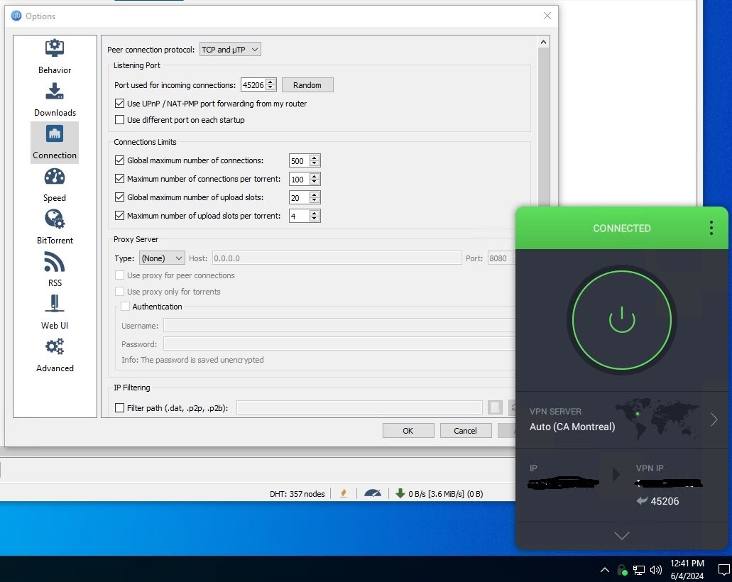

  9. Here's my Docker run and log file again. Seems to maybe have gotten lost in the shuffle. Anyone have suggestions for helping clear the firewalled status of my qBT? I did figure out that my VM isn't really involved, although it's firewalled as well. I'm actually running 2 instances of qBT. One is the one that's hosted by this docker, and is accessed via the webUI. It's connected to my *arrs. The other is a desktop client I have installed within a VM, that I use for various random manual downloads like Linux distros and such. I had confused myself by forgetting that I had it set up that way. lol Regardless, they are both listed as 'firewalled' now, so something has changed recently on the backend. I'm guessing it might be related to my change over from Mullvad to PIA, except that it's been working with PIA just fine for the past couple weeks, and the firewall icon has only appeared in the last couple days. The only changes I'm aware of have been container updates to this docker. Docker Run Command execution docker run -d --name='binhex-qbittorrentvpn' --net='bridge' --privileged=true -e TZ="America/New_York" -e HOST_OS="Unraid" -e HOST_HOSTNAME="Tower" -e HOST_CONTAINERNAME="binhex-qbittorrentvpn" -e 'VPN_ENABLED'='yes' -e 'VPN_USER'='----' -e 'VPN_PASS'='----' -e 'VPN_PROV'='pia' -e 'VPN_CLIENT'='wireguard' -e 'VPN_OPTIONS'='' -e 'STRICT_PORT_FORWARD'='yes' -e 'ENABLE_PRIVOXY'='no' -e 'WEBUI_PORT'='8080' -e 'LAN_NETWORK'='192.168.11.0/24' -e 'NAME_SERVERS'='84.200.69.80,37.235.1.174,1.1.1.1,37.235.1.177,84.200.70.40,1.0.0.1' -e 'VPN_INPUT_PORTS'='45206' -e 'VPN_OUTPUT_PORTS'='' -e 'DEBUG'='false' -e 'UMASK'='000' -e 'PUID'='1001' -e 'PGID'='100' -l net.unraid.docker.managed=dockerman -l net.unraid.docker.webui='http://[IP]:[PORT:8080]/' -l net.unraid.docker.icon='https://raw.githubusercontent.com/binhex/docker-templates/master/binhex/images/qbittorrent-icon.png' -p '6881:6881/tcp' -p '6881:6881/udp' -p '8080:8080/tcp' -p '8118:8118/tcp' -v '/mnt/user/downloads/':'/data':'rw' -v '/mnt/user/appdata/binhex-qbittorrentvpn':'/config':'rw' --sysctl="net.ipv4.conf.all.src_valid_mark=1" 'binhex/arch-qbittorrentvpn' 684f731f8e6dbd0002b0a66958de5b7dd1b130baad6e8b790c809907c8cd432e The command finished successfully! supervisord.log EDIT: OK, super weird. I just checked, and the webUI for this container is now showing connected, no firewalled icon. However, the one on my VM is still firewalled. I've checked that I have the correct forwarded port (from PIA) entered into qBT. Not sure what else I'd need to do...

  13. Perhaps I don't! I only tried that as a troubleshooting step, when I noticed that qBT was reporting that it was firewalled. I'm not really running the docker in a VM, I'm just accessing the UI through a VM. Is that not the normal way? It's been working great for quite a while, but recently I noticed that after changing from Mullvad to PIA, which is supposed to be easier and 'plug and play', it hasn't been connecting properly. I'm sure I have something configured wrong, I just don't know enough to begin tracking down what that may be.
  14. I apologize if my question was forbidden. Please tell me where I should ask for help...
  15. Hi all, Please bear with me, because I'm certain this has been covered many times before. I'm struggling with getting my qBT unfirewalled. I'm using PIA VPN, running this docker on my unraid (of course), and running qBT UI in a VM, which is running the PIA app. I (think) I have the port forwarding set up correctly in my pfsense firewall/router, but I still can't get the little orange flame "firewalled" icon to go away in qBT. Also, if I open a browser in the VM, and check the forwarded port at canyouseeme.org, it comes up as not open. I'm not really sure where to go from here. I know I'm missing something obvious...
