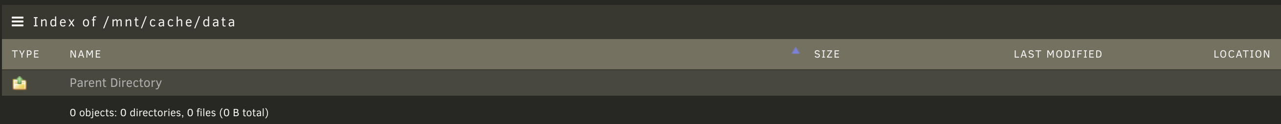

  21. I ran an extended SMART test and it passed just fine... I tried this on a different port on the backplane (this is in an r730xd system). SMART passed without any issues (no errors logged), and it runs into the same issue when trying to zero with the preclear...

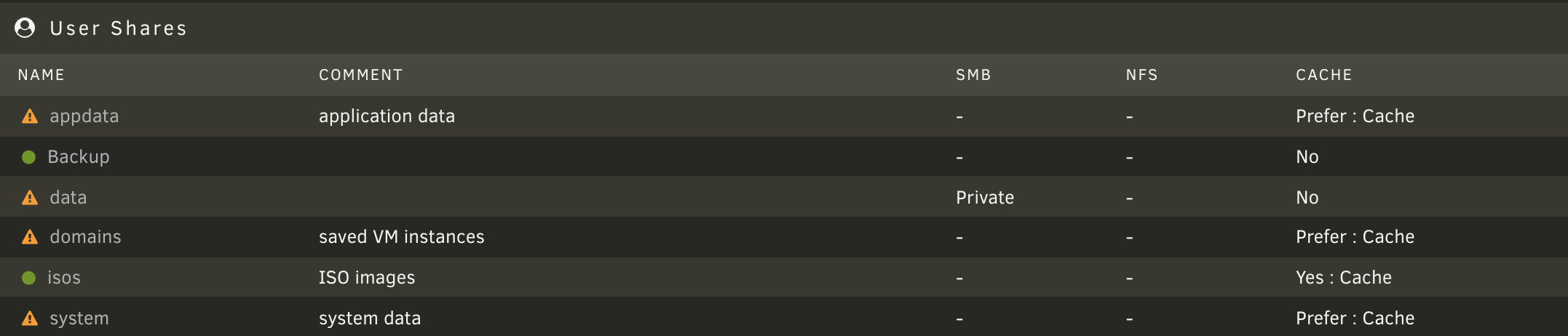

  23. Removing that folder at /mnt/cache/ did the trick. Couldn't tell you why it was created. I don't recall creating it, but I guess I must have. Thank you.

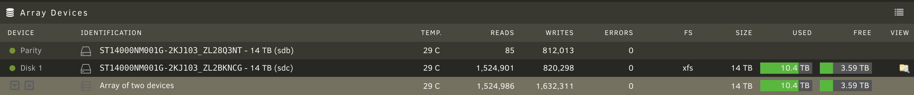

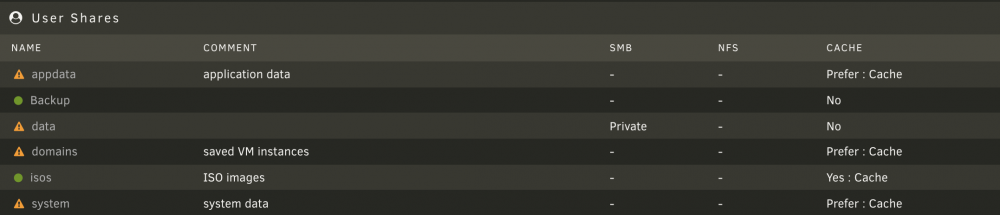

  24. I'm on Unraid 6.9.2. I understand the warnings for appdata as some/most of the data is on the cache drive, but I don't see why it would show that for the data share? If I browse the cache, there is no data in the data folder. So what does this warning mean exactly? It's a 2 drive array btw, so parity should be fine: Thank you.
