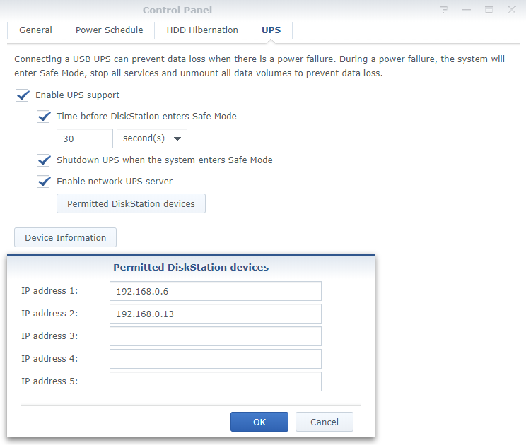

Thats really cool! didn't know that was possible found it used another IP than my primary "bonded" IP with Thrunk? Changing the IP and it works! THANKS
UPS Settings (network UPS server on synology)

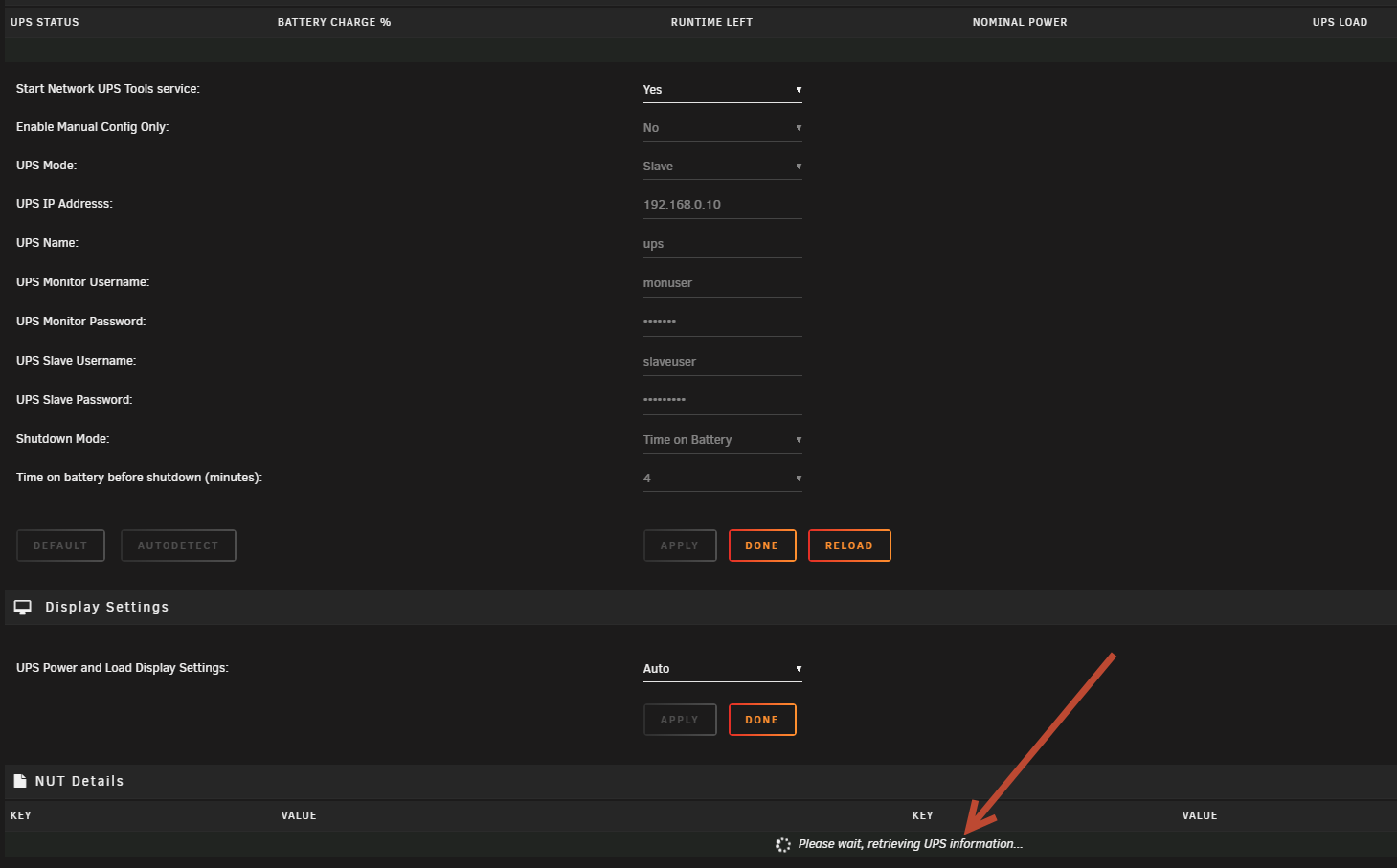

Thanks @petecemi I can not see any difference between your setup and mine... What passwords are you using for mouser and slaveuser? (Standard ones?) Status never changes: UPDATE: I found that my Synology was using another IP for the UPS server? not my main "Bond" IP... [monuser] password = secret upsmon master [monuser2] password = mylittlesecret upsmon slave Looks like its connected now... THANKS for all your help!

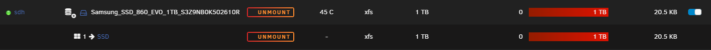

Your right!!! of course as root user you can do anything.... Didnt think about unraid root being the solution Deleted all temp files (After a preclear I could format the SSD - I know preclear is not for SSD but I couldnt get UAD to show the format option I then was able to format the drive and copy the files to this seperate SSD for my appdata so hope this solves this for the time being

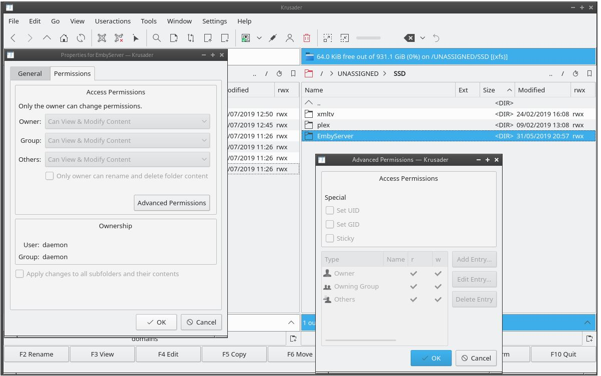

Hi All I have a problem accessing files on a mounted unassigned drive (But only for data containing the Appdata for Emby) Also I can not unmount the drive? But the mount dosent work correctly because I cannot access the drive as a SMB share? The drive is full: Trying to access the files so I can delete these file (Initial thought is was Plex) in Crusader I can see that the files are locked And that Emby have generated a temp file that is 235G !!! because of this I can not run my servers Normally I would correct any file rights in Unraid but that does not work for assigned devices? Please help, my last reboot hang up the system and I had to cut the power....
[Support] Linuxserver.io - Plex Media Server
Hi @saarg I found the problem, but need some help to solve it.... I have the appdata folder on a seperate SSD for Plex Looking on the SSD i can see a temp file in the cash that just explodes in size? (239G in a single file - think its TV recording going crazy ) I have stopped the Plex server, but I cant delete any of the files, even using Krusader? How can I delete files on a UAD SSD when I cant change the access rights? (Tried in Krusader) Normally I would do a fix all R/W rights on Unraid for all drives, but in this case I can't do that when its Unassigned device

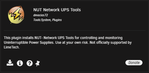

I am still struggeling to get this working... Anyone with at Synology NAS and the plugin above have this working? And if they do please tell me how? 👍

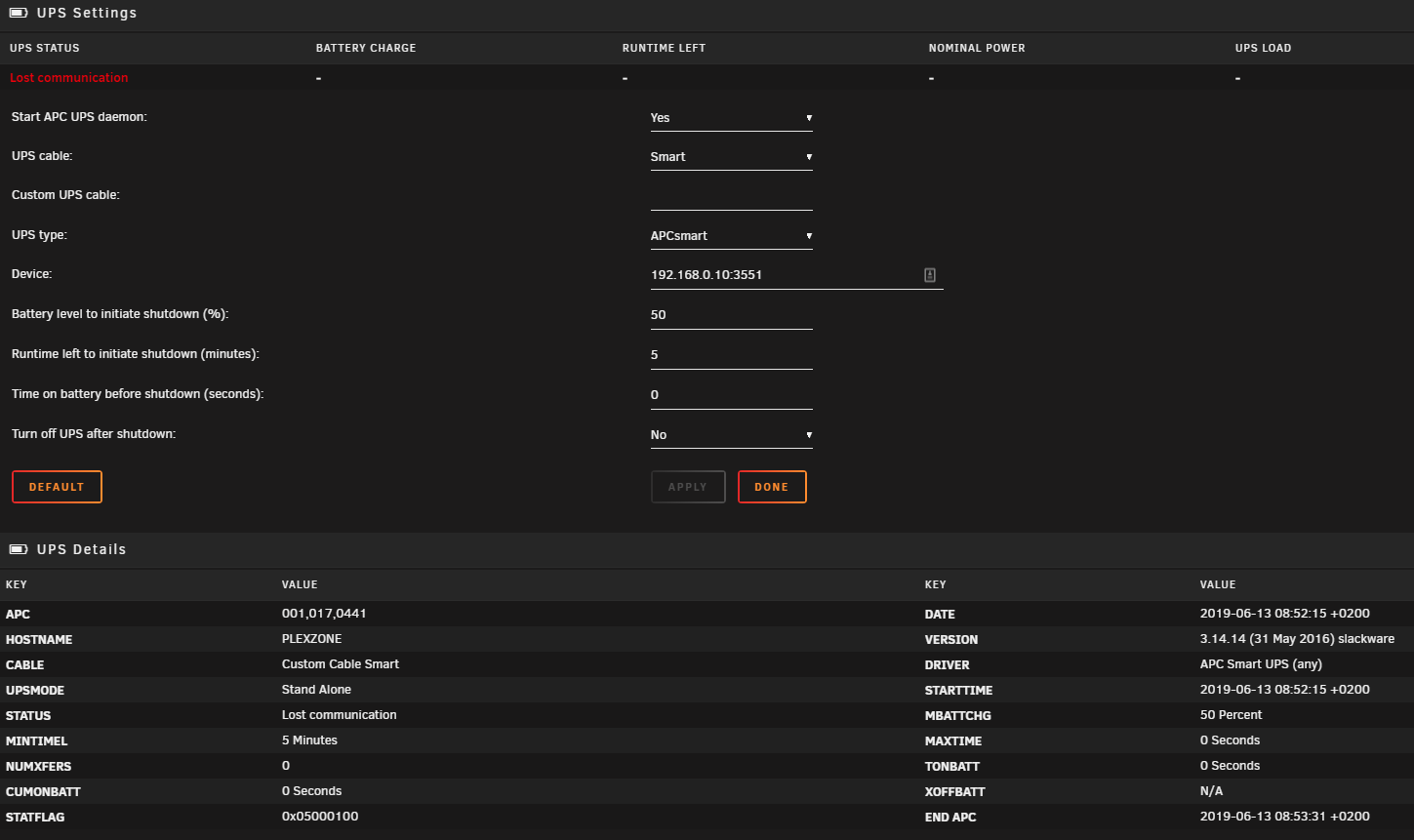

I am trying to setup the same configuration but I am getting lost connection? The synology UPS server is running on 192.168.0.10 And I have added the Unraid IP to the UPS server list So what am I missing?
