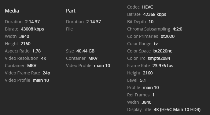

Strange, it seems to be encode bottlenecked from any probing I do. Disk read speed according to iotop for the process toggles between ~200kb/s to ~1.5mb/s with the main page unable to even show which disk is being hit (though I know which disk it is by finding it on the disk.) IO Tests on the disk show it capable of reading at ~150-200mb/s sequential, and no other activity is on that disk. So that should mean the Disk, and interface is good. The transcode directory is in tmpfs so DDR4-2133 shouldn't be the bottleneck either. The connection *is* slow, but I am streaming using a preset that works on other video files (720p 2mb/s) I'll have to dig at logs some more to see if I can find a "real reason" for it to not transcode this just fine, as it should be able to according to the specs on paper.

I need some assistance troubleshooting poor transcoding performance. I've been struggling with this since I built my new server late last year. I figured the issue was a lack of understanding on the capabilities of the components I selected for the server. Plex was an afterthought, so I wasn't too upset with making a mistake with component selection. Server specs are as follows: SuperMicro X10DRL-IO 2x Xeon E5-2658v3 64gb DDR4-2133 Fully Buffered ECC quad channel (4x16gb sticks - in the correct slots, board reports quad channel) 1x nvidia Quadro P2000 added recently for transcoding via the new nvidia plugin. 24x8TB Western Digital RED drives connected to an HP SAS Expander at 3gb/s (not 6gb/s, limitation of this strange SAS Expander) Raid controller is a 9211-8i 2xIntel 1tb 660p NVME SSD for cache Since this is a dual socket system, paying attention to CPU/PCI-E Lane associations is important. Thankfully this board only has ONE slot on CPU2. Slot arrangement is as follows: 660p SSD's are on a carrier card in the TOP PCI-E x8 slot, which is CPU1 Slot 6 Port Expander is in the lowest x8 slot which is a PCI-E 2.0x4 slot, on the chipset (not on either CPU) - but should only be pulling power from the slot. Raid Controller is in the slot above that, which is PCI-E 3.0x8 and is CPU1 Slot 2 Graphics card is in the only x16 slot on the board which is CPU1 Slot 5 Any time I go to transcode certain 4k files to any resolution the client reports that the server is not powerful enough to transcode for smooth playback. This seems bonkers since I have 48 CPU Threads and a dedicated GPU for transcoding. I figured originally since the CPU has no QuickSync Video that this was the problem, and that I'd need some sort of extra acceleration to get things done. So I threw the P2000 in, tossed unraid-nvidia in it, configured the container to use the new GPU and also added the nvdec parameter to the Plex Transcoder so that I could use the GPU for decoding and encoding. Video files are stored on the rotational media, fwiw though it shouldn't matter at this bitrate even. I get 15 seconds in to this file: And then it starts buffering and says the server isn't powerful enough. Checking nvidia-smi shows that the card is being used for encoding: And checking further shows that it is also being used for decoding: CPU Usage in this circumstance is quite low, suggesting that the audio stream shouldn't be bottlenecking. The video quality also suffers substantially, colors are washed out and there is significant banding. I'm at a loss for what to try to solve this. The target transcode is 720p, for reference, though streaming 1080p at 1080p works just fine on this same machine, even before adding the GPU for transcoding.
