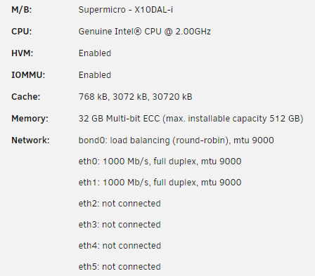

  17. Currently rocking this: The extra NIC is for planned expansion, but may end up scraping and going with a single 10gbe and shifting the network to 10gbe instead. The two CPUs detect that way because they are engineering samples; 12 core, 24 thread Xeon E5-2658v3 CPUs.
