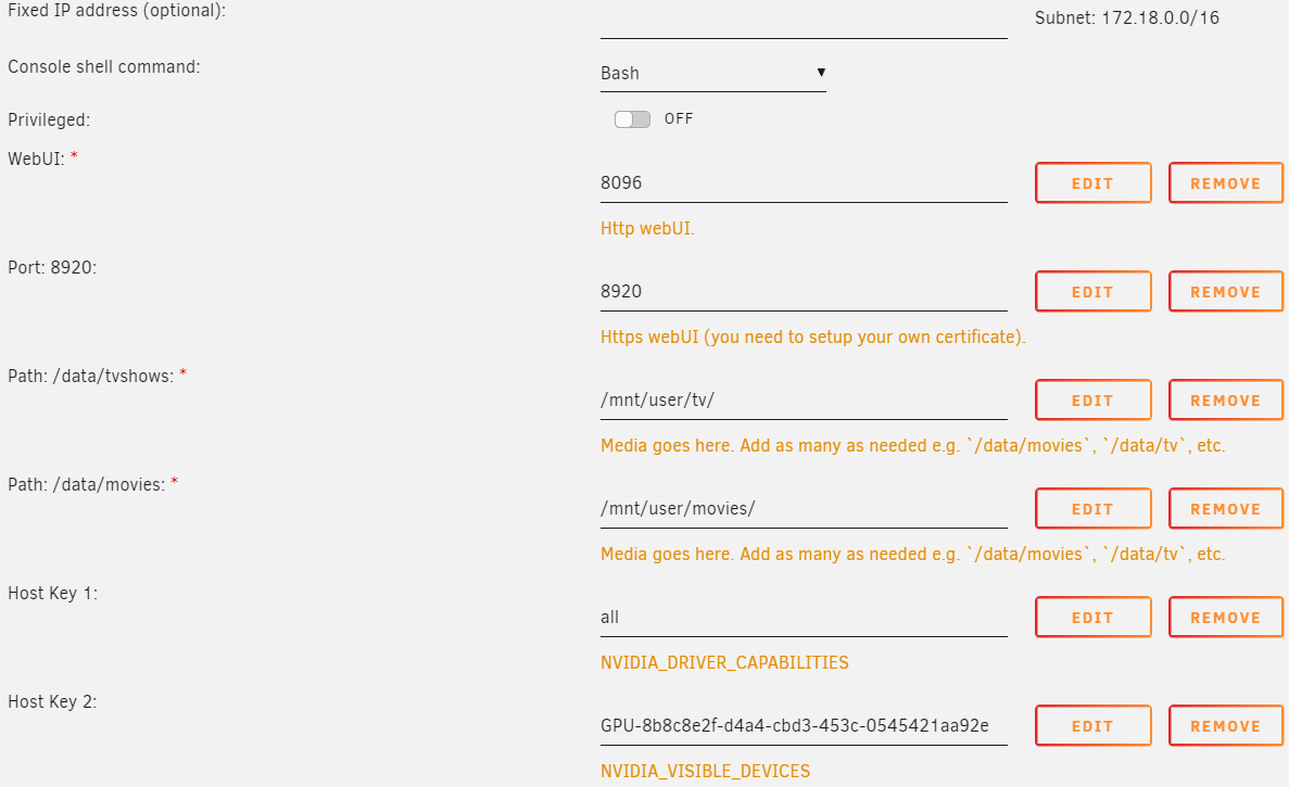

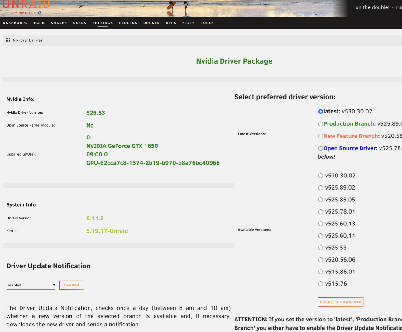

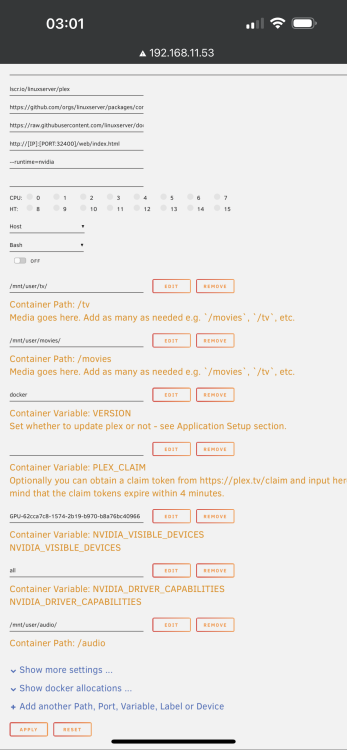

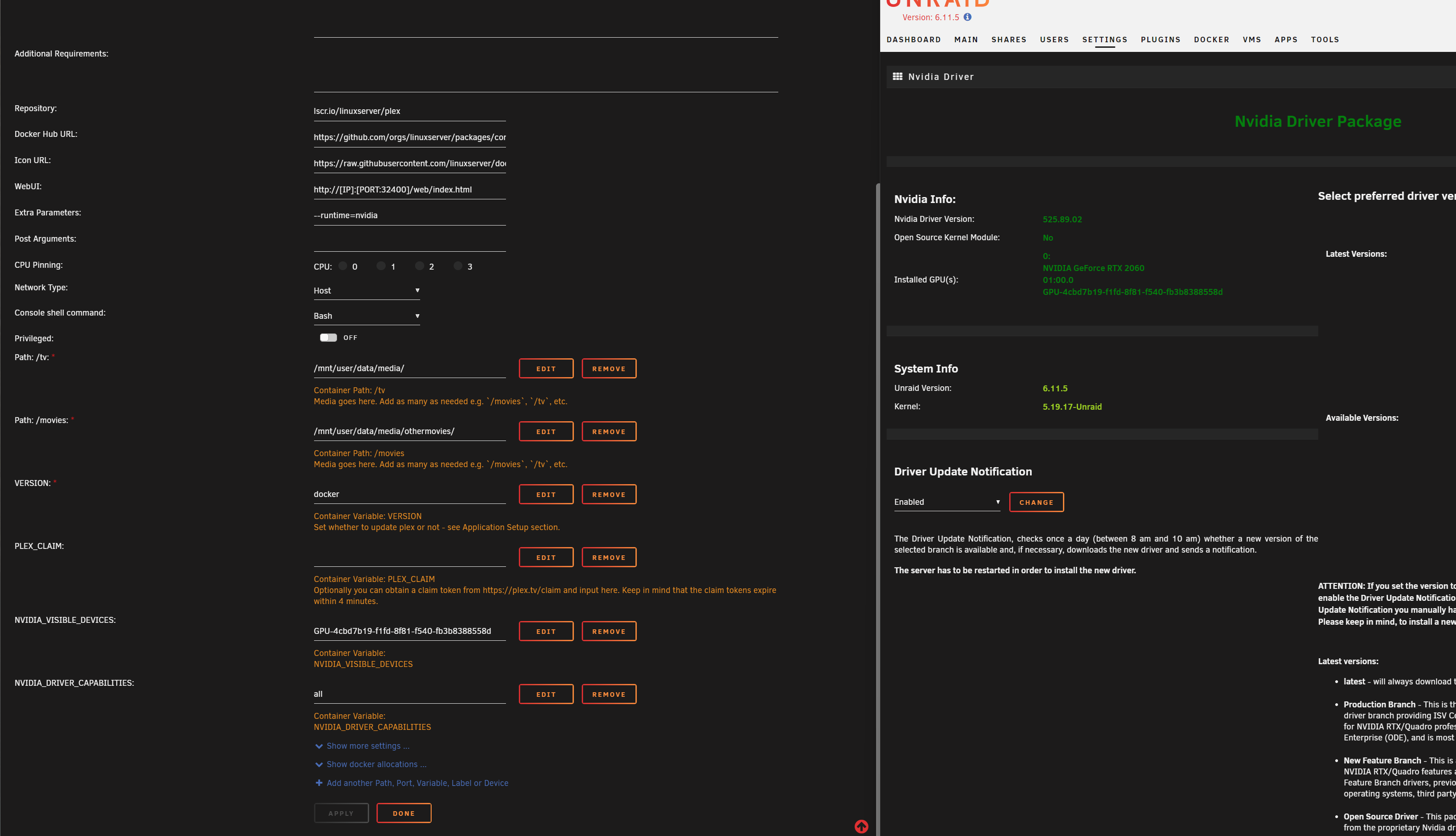

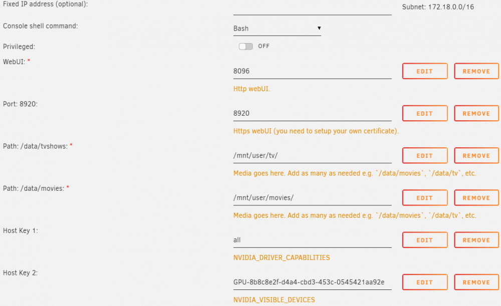

I've got an AMD CPU and motherboard, and NVIDIA GeForce GTX 750 Ti, so these hardware transcoding steps didn't work.
Nice write up thanks!!!
@dkerlee Thank you for the nice comments.
Regarding your hardware may I suggest to have a look at the NVIDIA driver plugin (coomunity apps) from the amazing @ich777. This is a link to the forum post https://forums.unraid.net/topic/98978-plugin-nvidia-driver/
This allows you to use the nvidia driver into the docker container. Just follow the instructions, then use emby settings to use the gpu for transcoding and you shouldn't have any issue. Let me/us know how it goes and if you had to take any particular steps to make it working so other can benefit as well.

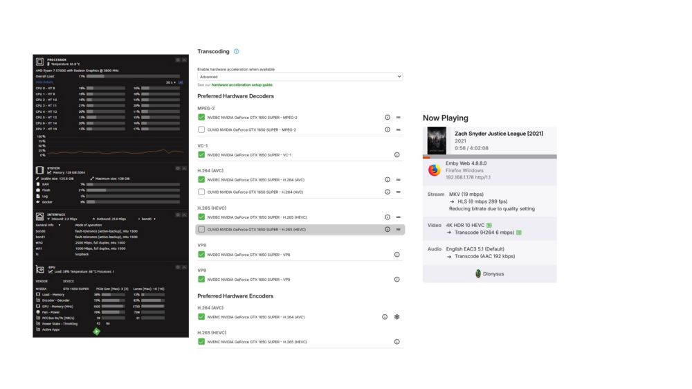

  • the binhex-emby docker didn't work with hardware encoding. I ended up using linuxserver.io emby
  • There are two spaceinvader videos, I used both:
  • https://www.youtube.com/watch?v=VkC5Hi-rO2c&t=13m41s 3/2/21, Ed goes a bit off the rails here with an nVidia commercial; but he's also chosen to detail the process for "unlocking" consumer nVidia GPUs for multiple encoding threads, which I also did. I left a time-code in the URL to get to the meat and potatoes. The docker he uses here (linuxserver.io emby) has also been changed. I had to Remove the raspberryPi encoding items, they were giving me errors.
  • https://www.youtube.com/watch?v=GOhHiFAXwOE&t=6m14s 2/12/19, also helpful. Here he goes into the Advanced tab of the docker, adds three items (extra parameters, and two variables), all of which I had to add to get it all working

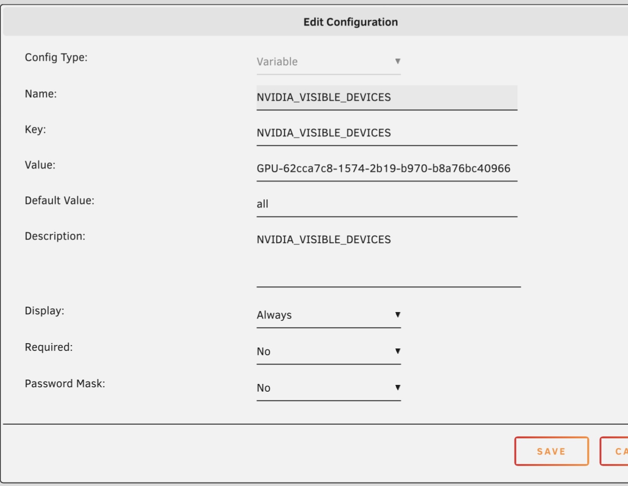

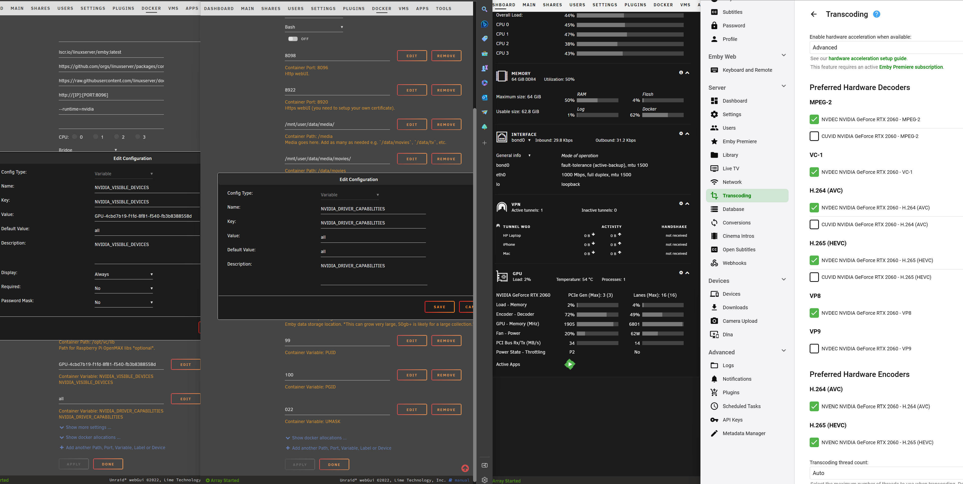

  • nVidia drivers shows up in Apps, but then lives inside Settings rather than a Docker. It's the ich777 nvidia driver package.
  • added GPU
  • getting SWAG passthrough working for a docker, Ed's nextcloud video is good https://youtu.be/id4GcVZ5qBA?t=830
  • As I recall there:
  • I had to put the name of the docker into the conf file, "emby" (ya know, that might be the default now that I think about it)
  • I created a subdomain CNAME in my webhost, emby.mysite.com
  • added the subdomain, "emby" to the subdomains to pass through on SWAG container Edit. I'll slap a pic of my docker settings in here. You can't see the linuxserver name, but that's what it is, the Rpi stuff is gone, and the two Variables are at the bottom, cribbed from Spaceinvader video up top.

The Nvidia_Driver_Capabilites and the Nvidia_Visable_Devices are no longer included in the docker container.  I understand I need the extra variable of --runtime=nvidia, but where do I put my GPU ID  if the two Nvida fields are no longer included in the Docker?  There is a field where it wants me to map a location of dev/dri I tried inserting my gpu id here, but the installation fails.
@Grant123 You can always add extra parameter in the docker by using the appropriate menù. It's at the end of the page. Also consider that some stuff have changed with the latest release since I wrote this guide. I am quite busy at moment, whenever I'll find the time I'll try to update this guide with the latest infos.

your guide is clear and concise but don't believe it's working for me.
My Emby (Premiere), is not showing hardware encoding. If I change my transcoding to Advanced, there are no hardware encoders, and in GPU Stats, i have zero processes.
Did you have to do anything special other than the --runtime=nvidia, and the two variables ? Your screenshot has them as Host Keys, his video had them as Variables.
Ta
@elmuziko I went back to the Plex docker. It’s been okay, and it’s paid for.
it was working for me when I wrote that post, using the screen shots I’d grabbed; but like Mik3 said up there: more things have likely changed and the instructions might not be concise or even correct at this point!

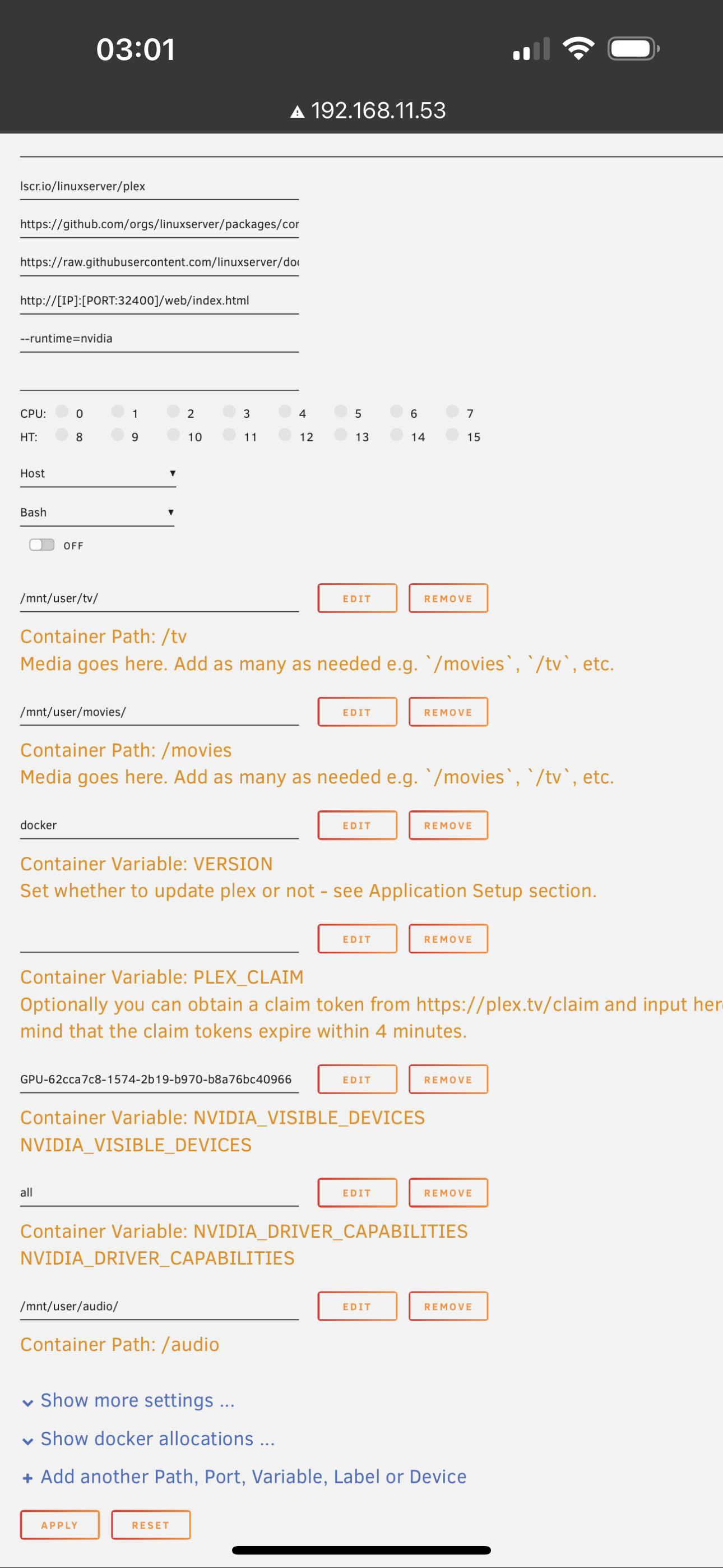

@rutherford
Thanks for your very quick response.
Are you using the same set up for Plex to? I'm trying it there with the same settings, as seen in my screenshot, but it's not working there either. Which kind of gives me hope I can get it working for Emby, just need to figure out the bigger issue.
Thank you in advance.
Yeah, mine looks the same as yours. ???
have you tried several different episodes? Sometimes the encoding that’s used for specific episodes doesn’t fly with our gpu. I think it’s something like the NVEC or color depth I think? I have noticed that several episodes go over to the cpu for encoding, but most are the (hw) in there. And you want to make sure on your test player, you turn down the kbps for the stream, and double check that’s what you’re seeing, the lower kbps version.
sorry I can’t be of more help!

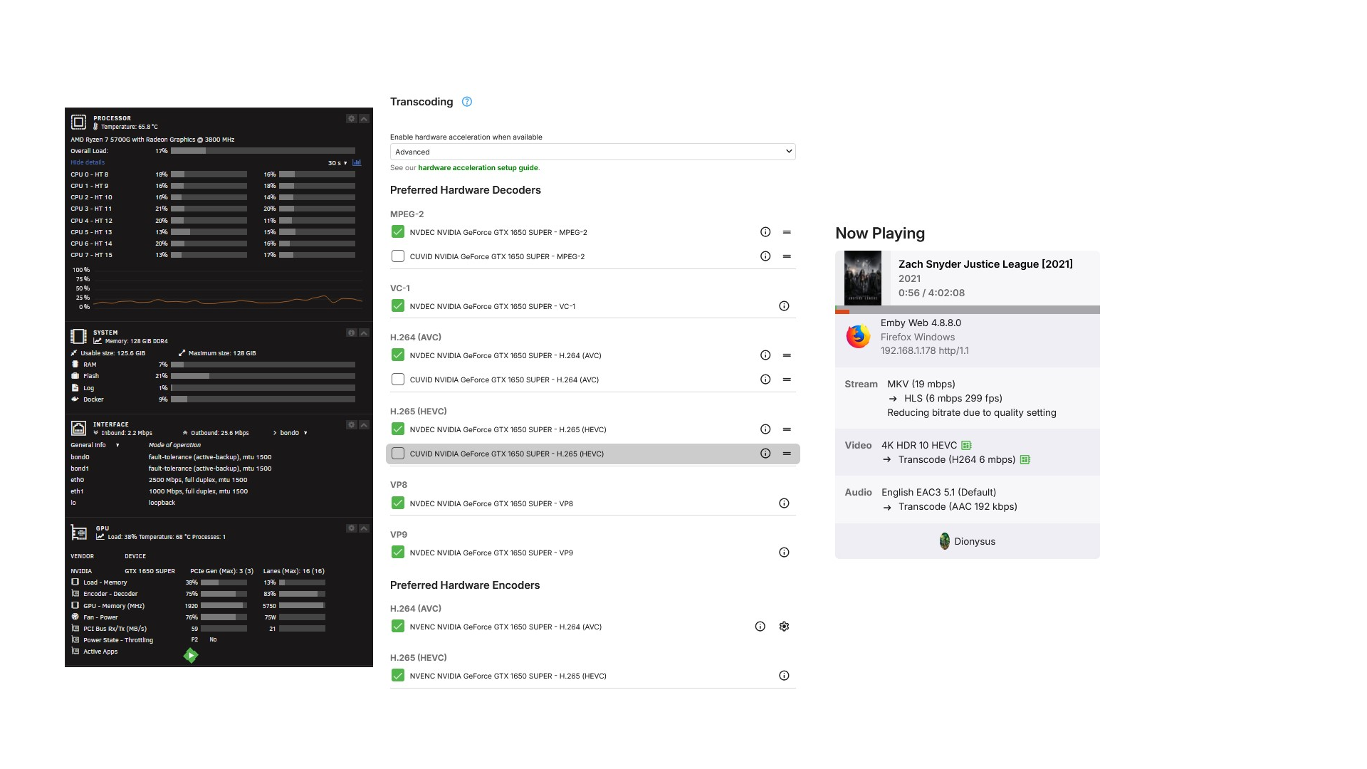

Holy crap, I've got it working with Emby!
Couldn't get it working with Plex. I'd change the video encode and watch the Processes on the unRAID dashboard change to one, then immediately see it revert to zero, and the stream hang. By that account, it proved my hardware was being recognised.
Then I noticed you @rutherford set the values differently to how Space Invader sets them in his video. He only does the Name, Description, and Value. Whilst you added Key and Default Value.
I went back to my linux distro of Emby and added them. Voila. Working like a treat.
What’s more than that, I just fired it up with the binhex distro and it’s working there too.
Below is a screenshot of my settings if anyone else is wanting to get it working in Emby.
As an update, it looks like the Binhex Emby container has been fixed.  Using these same exact settings, the Binhex Emby container is successfully transcoding with my GPU.
