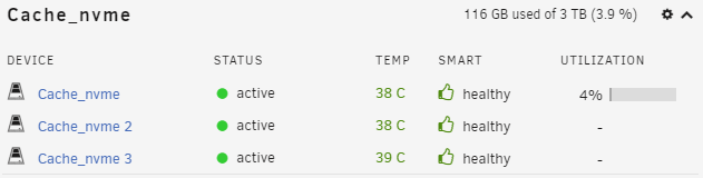

30 minutes ago, ich777 said:
Is it possible that your Cache is maybe full and the mover moved the file off of the Cache?
i checked my cache pool, but there is much space left.
the filesize of library.db-journal is 100MB and it is in the appdata folder.

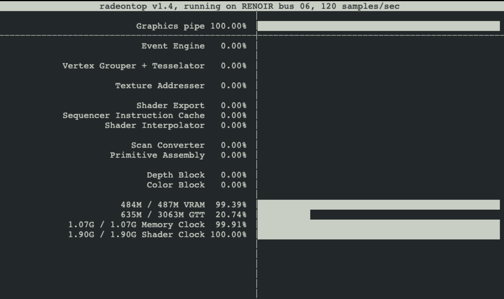

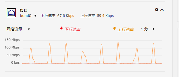

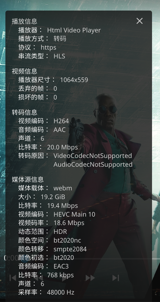

I had a 5600g APU, When I'm trying to play 4k(120mbps or 60mbps) or 1080p by hardware encoding, it was failed, My GPU usage went full.And my unraid 6.10.rc4 stopped and OOM.
I can get more info and logs later,because my unraid stopped at home but i'm at work......
btw, i had tryed emby, it worked, but it does not play smoothly......
Just now, Peelson said:
Sorry for my English.
When i'm using emby, my gpu usage is low(i' sure that it using hardware encoding, bucause of 30% usage of cpu).
There is s2841650380830__pic.jpg.cd1d2cf2dd11da79f9636e96b1df45eb.jpgomething that I really don't understand, this is network usage when i'm using emby,It shows some patterns...
I think there must be a bottleneck somewhere between decoding and streaming
