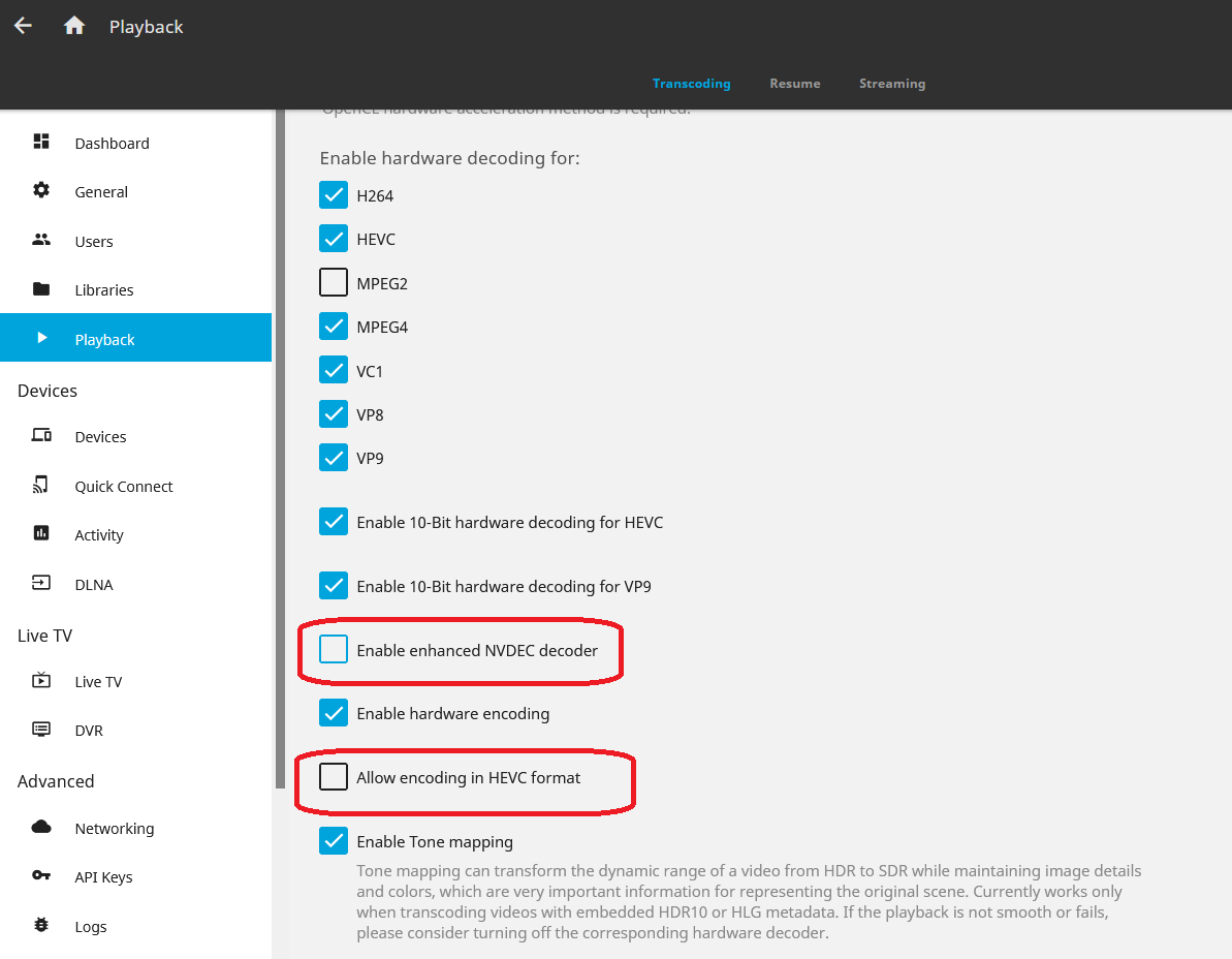

Can you try to transcode a file for 30 seconds or so and then send me the log, you'll find the logs in the Server Dashbaord -> at the bottom Logs and then it should start with FFmpeg...
What is set at Playback in the Jellyfin settings? Do you set it to NVENC? Also did you start over completely fresh or do you still use your old folder structure?
Do you now use my container?
I am using your Jellyfin container. It has its own file structure under my current appdata folder. Here is a sample of my log file. The entire file is pretty big, but it just keeps repeating this.
Please try to disable these two options in Jellyfin and try it again:
Btw what card are you using for HW transcoding?
That got it. You are the man. Do you know if there is a way i can import my user accounts to your container from my old container? After all your great help and support i would like to continue using your docker.
