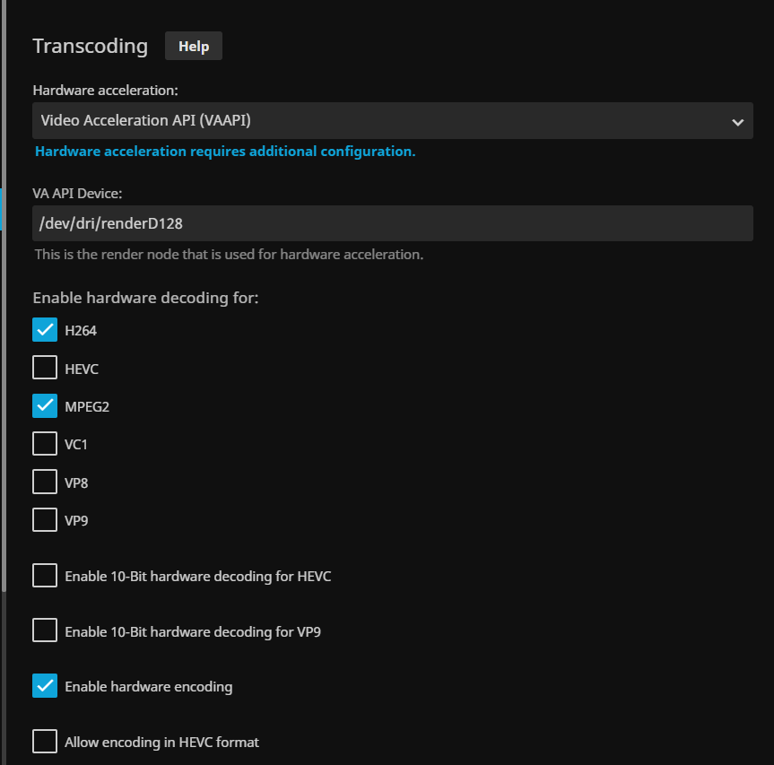

Please go to the Jellyfin settings and enable only H264.
7 hours ago, Tery said:
It doesn't change anything and same message log.
Can you maybe try a different file?
Please send over a screenshot from your Playback settings in Jellyfin.
