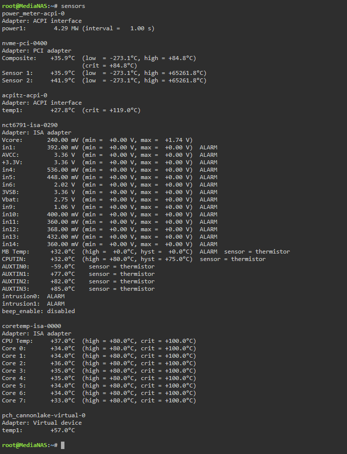

If you go to the terminal and type "sensors" what do you see?  On my board it is the Nuvoton nct6791 providing voltage info.
Here is what I see for my board and I am running unRAID 6.9.1:
Here is what it says, looks like it has the motherboard voltages but not the CPU voltage / current.

I used to see 2 separate sections in netdata, one would have the motherboard voltages and the other would have the CPU voltage and current. These are the same values as the motherboard readings.
I could be wrong, just find it odd that the voltage and current disappeared at the same time that turbo boost stopped working.
Honestly I plan to switch motherboards in the semi-near future anyways, mostly reporting this issue in case others have it.
Although the random restarts earlier today were not comforting.
