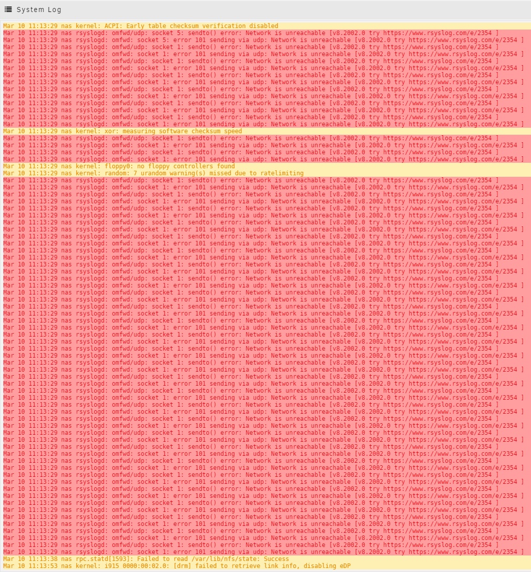

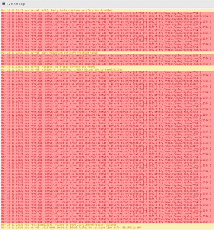

After updating from 6.9.0 to 6.9.1 the following warnings and error messages are in the syslog.
The rsyslogd entries are "normal" after a reboot.. The syslogdeamon is trying to send data before the network is up..
