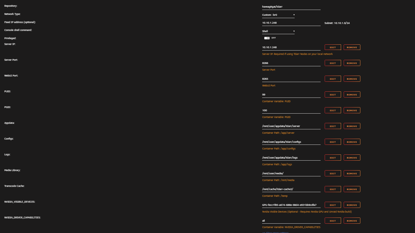

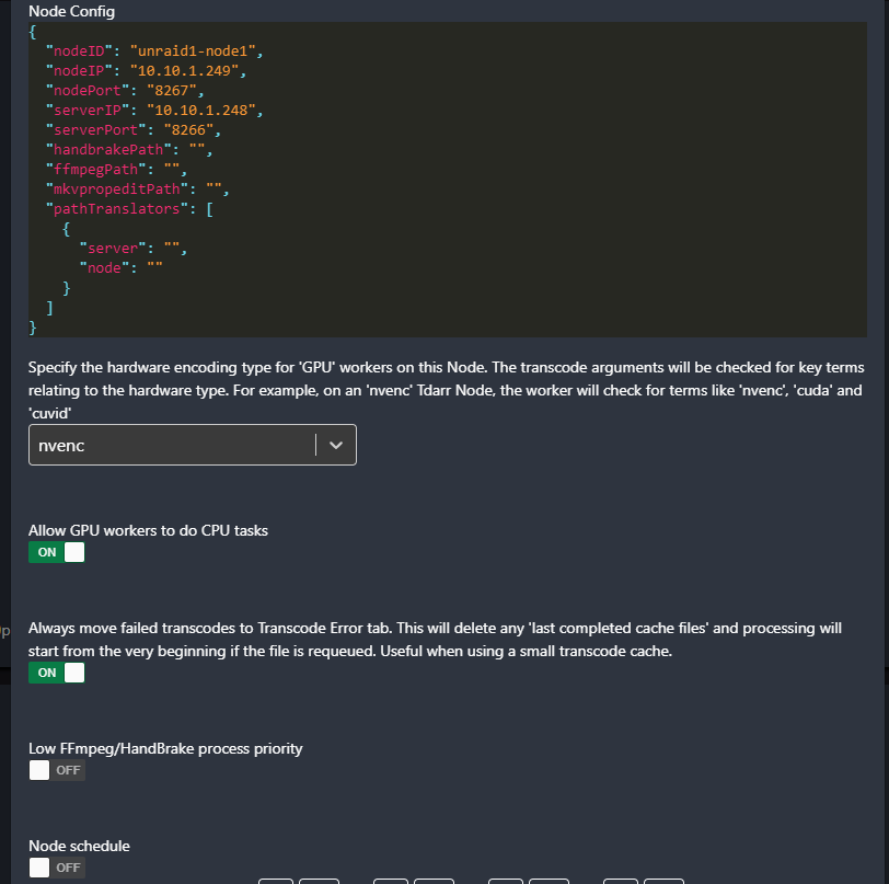

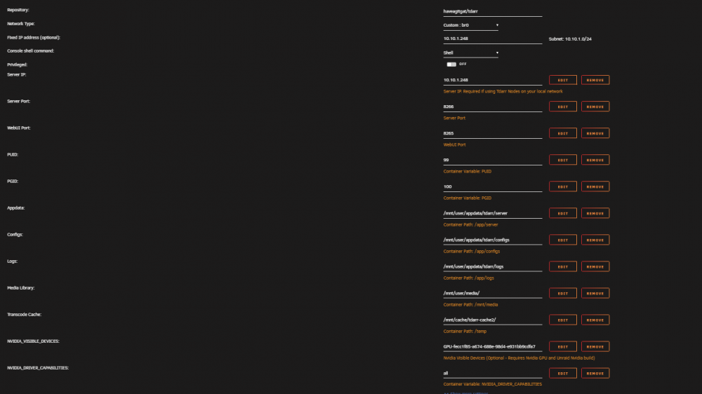

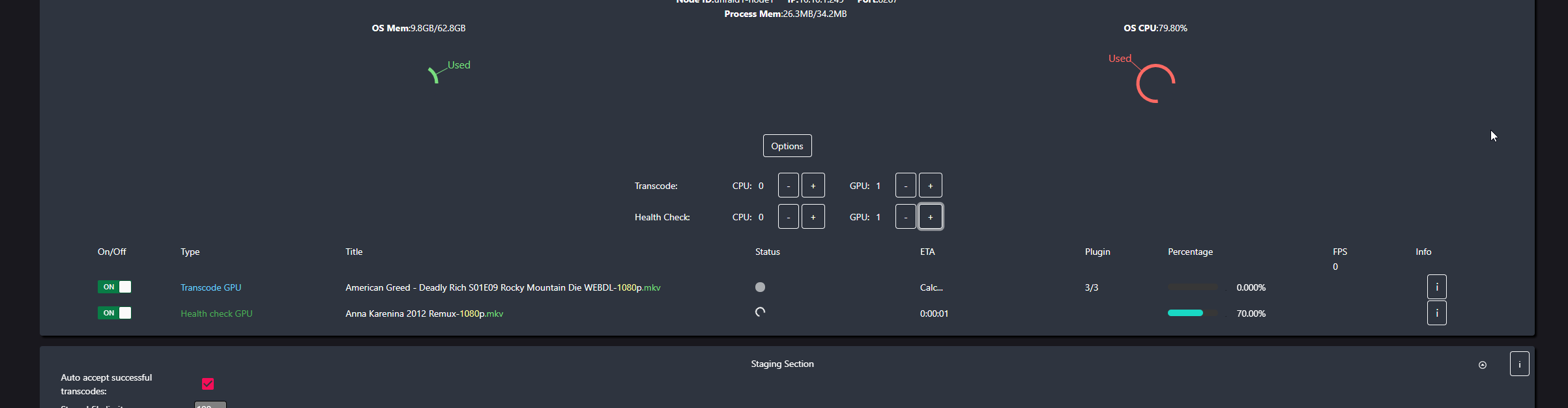

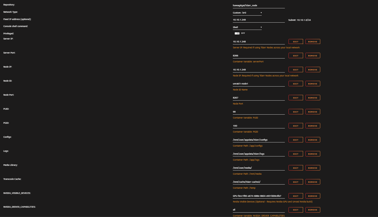

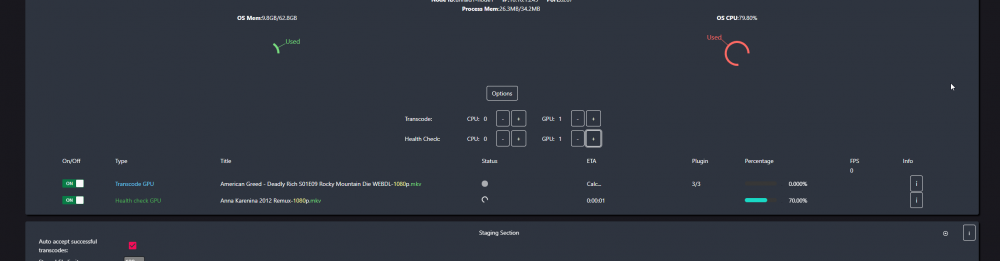

I have an nvidia 1660 SUPER GPU, it works fine with plex.
I cannot get tdarr to leverage it. I have it set to use the GPU only for both Health and Transcode tasks, it's not using the GPU for either.
I'm looking for any and all advice you are willing to offer.

On the docker settings page, toggle to Advanced View in the upper right.  Do you have --runtime=nvidia set in Extra Parameters

I have --runtime=nvidia set in Extra Parameters

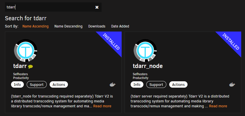

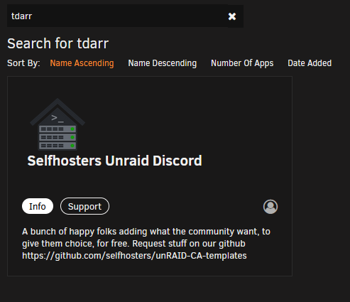

I'm just using the container from CA Apps found using seach for 'tadarr'
image.png.5e4d1f65ed8f93fefd47b6956a8af839.pngimage.thumb.png.0eb44326150884a0184e31ba4f4ba2e1.pngimage.png.aeacba8b435aeae3c1bc92f39df7b3a1.png

I just had the same issue with my GPU node not working.  I was able to resolve the issue with Spaceinvader One's video.
In addition to adding --runtime=nvidia to extra parameters, you need to add the following two variables.  The section of the video starts right at 14:48 https://youtu.be/U6UMjTlwrxs?t=888
Variables used in the template to add
GPU NVIDIA_VISIBLE_DEVICES value Your gpu id
NVIDIA_DRIVER_CAPABILITIES value
Hopefully this resolves your issues.
