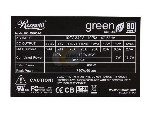

I bought this power supply a while ago.  I'm going to add
another drive so I thought I'd look into my PS to see if it could handle it.  I've got 4 rails @ 20A each..  but how do I know which cables go to which rails?  Attached is the PS ratings.
I currently have 8 drives and I want to go up to 12..  but for now I'm testing
#9 and it doesn't seem to be choking..

Are these all green drives?
If those rails are truly split at 20Amps each then you are going to have problems when you add 12 drives, even green ones.
My suggestion is to get a new single rail PSU like the corsair, seasonic, etc listed.
You have no way to balance the drives on the rails, just can't happen.
So there's no way of knowing which of my cable's go to which rails?
Not really
well..  maybe if I get bored I'll open up the PS and see if I can see what goes where!  ;D
Looks like I'll have to start scouring the good deals for power supplies in the next year or so..
I'm probably good for 10 drives since most (if not all) are green...  but I only have 9 for now...
Jim
In a multi-rail PSU generally only one rail goes to the hard drives.  Another will feed the CPU, and the last two are reserved for video cards.
Has anyone tried to hack their PS to move 1/2 of the disk cables to the PCIe rail?  Seems like it might be pretty easy (if
you have soldering skills..)
I'd hate to waste my 630W PS if it can be re-engineered ;D
