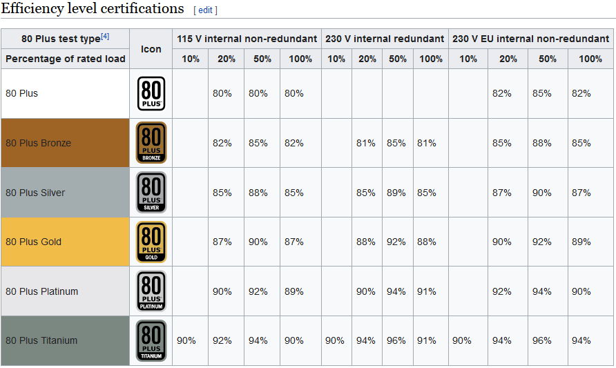

I do not understand this:
2. The minimum capacity that can power your build. Any more will just waste power.
If I have a 500W and only use 100W is the 400W difference going somewhere?
No, you're not wasting 400W, but a power supply is not running at its most efficient when on a light load.  So if you're pulling 100W, a 300W psu will take less power from the mains than would a 600W psu (all other factors being equal).
