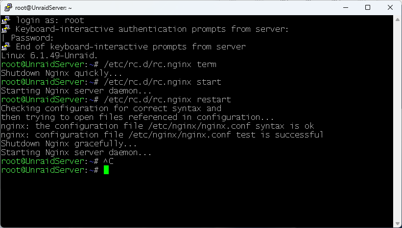

I think nginx is not stopping properly, which means it can't restart properly.  Please connect via SSH and type:
/etc/rc.d/rc.nginx term
followed by
/etc/rc.d/rc.nginx start
and paste the output of both commands back here.
If this doesn't solve the problem, please provide updated diagnostics as well (type "diagnostics" and then grab the latest zip from the logs directory on the flash drive)

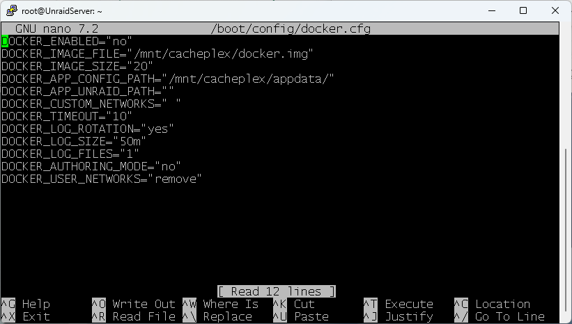

For this I changed the /boot/config/docker.cfg to docker_enabled ="no". Then rebooted. Still no effect.
I had tried the restart a number of times with no effect.

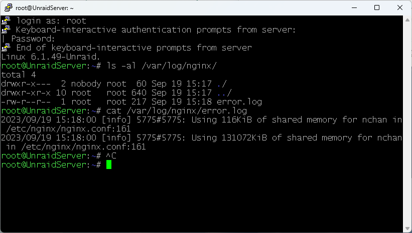

via SSH, type
ls -al /var/log/nginx/
This will show how big the nginx error log is.
Then type:
cat /var/log/nginx/error.log
to see the error messages and paste the results back here.
Hope this helps?
I am kind of stumped. So you are getting a 500 error but nothing is logged in syslog or errors.log.
Is Docker currently disabled? If not, please disable it and reboot. I just want to make sure there is not a Docker container responding on port 80.

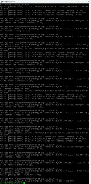

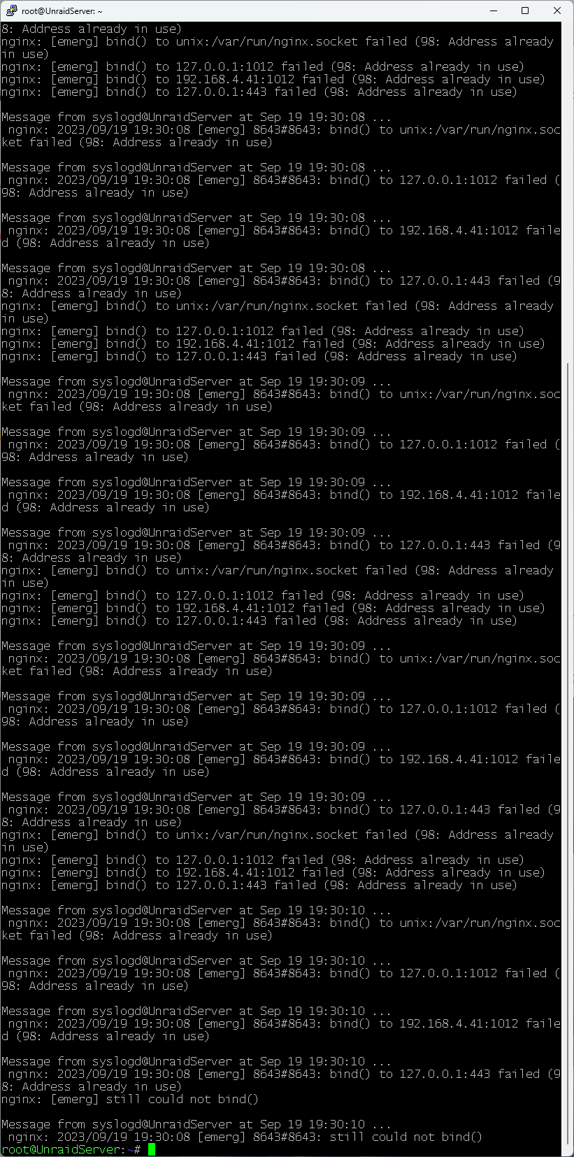

Here is what I get when I just run nginx. Not sure if this is helpful or not?
To clarify, what is the exact command you ran here?  Please run `/etc/rc.d/rc.nginx term` and then that command, to see if it is any different
Just typed "nginx" to get the output.
When I stop nginx and then type it I get nothing.

same problem and don't know what to do
in my case, the nginx service was not started after reboot, webui response 'ERR_CONNECTION_REFUSED'
then i start nginx by '/etc/rc.d/rc.nginx start', webui response '500 Internal Server Error'
