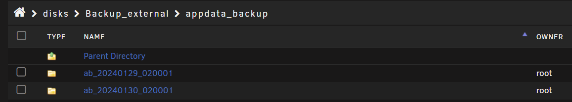

1 hour ago, DanielPT said:
But can i be that the "App data" plugin is been making the backuop with a user and when duplicacy is restoring its trying to set the owner that Appdata backup is using?
Dont know how duplicacy is working here. Appdata backup used to use root:root as user/group. The newest beta sets nobody:users as user/group. Maybe you could test the newest beta OR you set one test backup to nobody:users and test a backup/restore cycle.
HI :)
I cant change a backup owner?
image.thumb.png.fda7d712174e2da3f560affb6c2711b1.pngIs that becurse the folder "Backup_external" is owned by root?
@KluthR
AH okay i just tryed to make a restore of a file in my picture folder that has "owner" nobody and that worked! :)
When will the plugin be done and I can change it to "nobody" ? :)

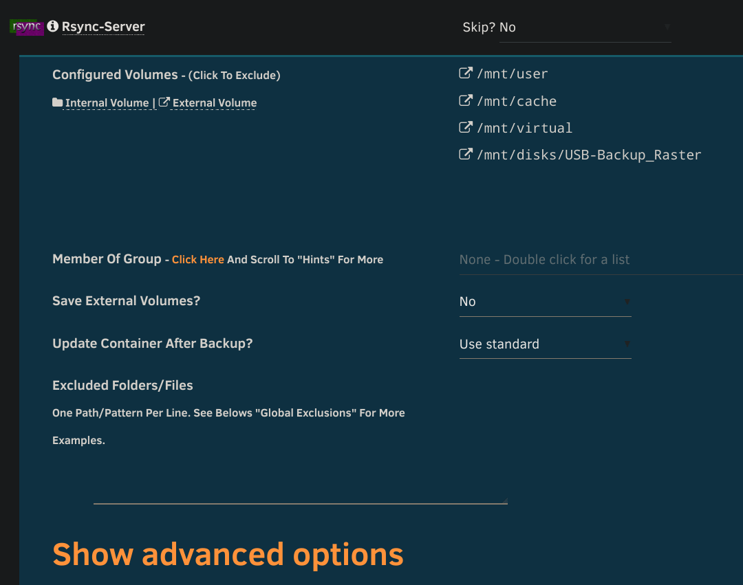

I have with the new Version from many Docker Containers Messages like this:
rsync-server does not have any volume to back up! Skipping. Please consider ignoring this container.
What's means Volumes?
Every? Docker Container have Volumes like appdata/Name or /mmt/user/xyz
Did you check? Not all do, and I only get that for those that don't.
Warning's a bit annoying though, it's not a problem that there isn't anything to back up and ignoring means unnecessary manual intervention times 20 for me, plus more any time something new that doesn't is installed.
The latest beta contains it. But its hardcoded to "nobody:users". The latest beta should go prod within the coming week
Yes. And knowing that this warning is being raised AFTER synitizing external volumes, its just here to inform you "Hey, you want a backup for this one..." (because its not being ignored) "... but the final detected volumes are empty". It could be something wrong.
So, if you EXPECT a container to be not being backed up, consider setting "Skip?" to yes or (if you want the container to be included in start/stops):

A Example for rsync Screenshot_20240210-190954_Firefox.thumb.png.4a37e31c6be9f2fd846c3a92edf54c4d.png
I don't know what wrong that's its triggered the Warning🤔
There is no internal volume, and external volumes are not backed up, so there's nothing to back up for that container.
OK, thanks for the clarify.
A Option to ignore this Warning what's great, than I will be Backup all Docker Container or his Config when his no self Data.
