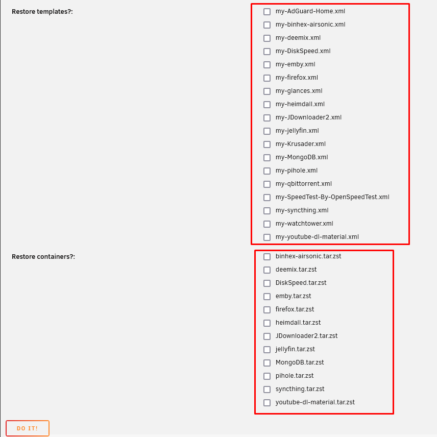

I am wondering what the process is for restoring, say Emby Server?
If I lose the appdata folder on my cache drives and the USB boot drive but I have my successful backups, after I create a replacement USB and install new cache drives and the appdata backup app.
Do I go to CA and install the Emby Server container then stop it, run AB restore? I have tried several different ways and I always have to start all over with Emby Server configuration (users/library/etc).
Help appreciated
You restore the appdata first then go to the Previous Apps page in CA and select/install those you want back.

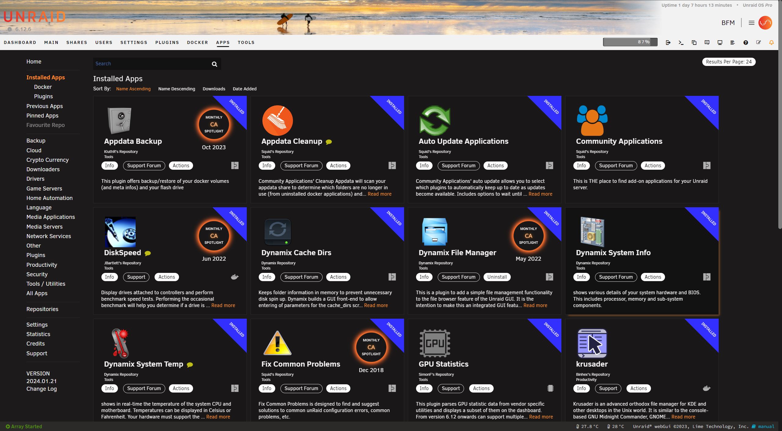

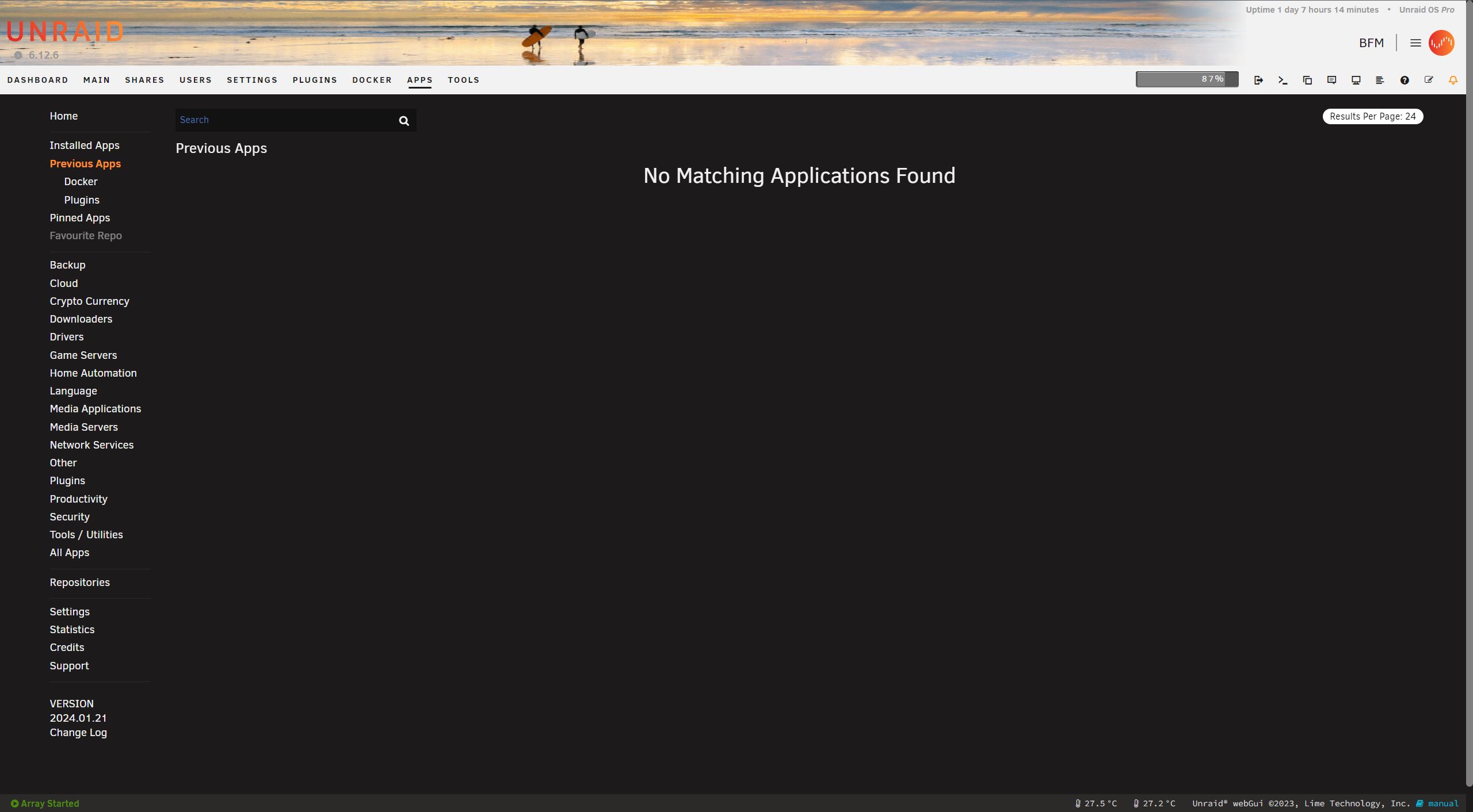

Hi! Thanks for the reply. That sounds great except Previous Apps in CA is empty.  Where does CA pull the list for Previous Apps?
From your USB drive in config/plugins/dockerMan/templates-user, if you properly restored a backup of that they should be there.
AB also backs the xmls up so you could put them back in there yourself.
Edited by Kilrah

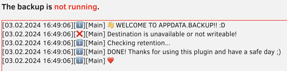

Hey I'm trying to setup appdata backup and when I run the manual backup to test out my config I'm getting an issue that the destination is unavailable or not writable [see attached picture].
I've tried setting the destination to another share that I know I can write to and I get the same error.
Any help would be appreciated! Thanks
App data work with direct path not share. So you must put the destination like /mnt/.... And the folder must exist
@Nodiaque that was it! I created the folder at this location and it's working!
/mnt/disk1/backup/appdata_backup
thank you
Something I did on my end, because targeting directly a disk could make your backup failed someday. I created a share so I target it in /mnt/user instead. And if your cache is big enough, I made it so it use the cache. With mover tuner, I scheduled the mover to run an hour after the backup (I could also trigger it with a post run backup script). This way, the backup is done very fast on the ssd and then moved to the safe HDD.
