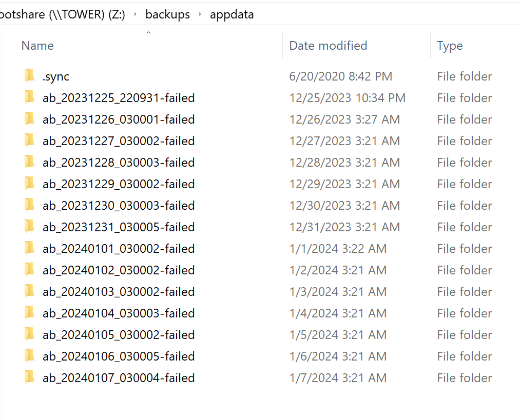

4 -> ab_20240104_000001 have no log but backups.
5, 6 and 7 have a log and backups.
Why are my backups not deleting?
Look into the latest folders logfile or view the log tab contents.
this one ? Is that referring to backups wont be check?
[07.01.2024 03:21:14][⚠️][Main] An error occurred during backup! RETENTION WILL NOT BE CHECKED! Please review the log. If you need further assistance, ask in the support forum.

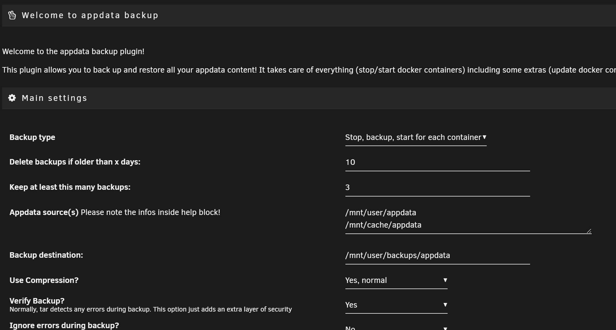

I have recently switched to this plugin and I was wondering where is the VM back stored? When I checked my backup folder I see everything is backed up in 1 folder. I see all the dockers and flash drive backed up in that folder but i do not see any VM backups, even though it is selected to be backed up. I only see VM_meta.tgz backed up, which is only 7.1 kb. I was hoping this would back up the VM images like previously there was libvirt back up with big .img file in GB.
Am i missing something or misunderstanding something in terms of VM backup? Could someone please point me into the right direction. I have attached my settings.
Thank you
Edited by GGabs
settings pic
VM disk images have never been backed up, only the libvirt.img file which contains the VM configs. That's only a few kB's worth, and the useful files are what's in vm_meta.tgz instead of wasting space with the entire image file that's mostly empty.

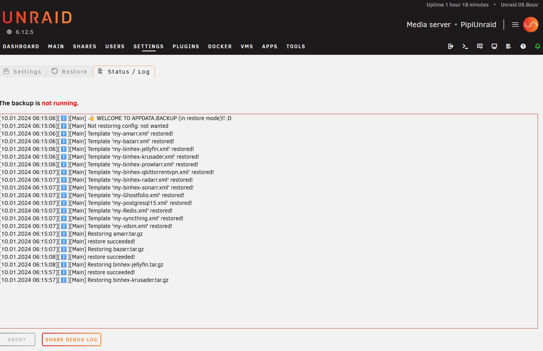

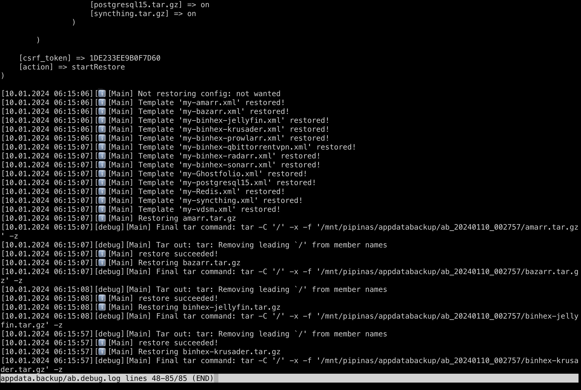

I've replaced my 2TB SSD cache drive for another with 4TB and after making the appdata backup with this tool I'm trying to restore it, but it seems to be forever working to restore the krusader template. It's been 15 minutes now and that template isn't that big so I think something is going wrong. Can I do something to solve this?
Edit: added another screenshot with the ab.debug.log. It seems something's happening with the tar command that decompress the krusader template.
nas-diagnostics-20240110-1550.zip
Edited by JaviPas
How big's the actual tar file?
4.9MB
It keeps there. I wonder if it would be a good idea to restart the restore process again. And if maybe having the tar.gz and xml files I could do the restore from Unraid's console.
Edited by JaviPas
