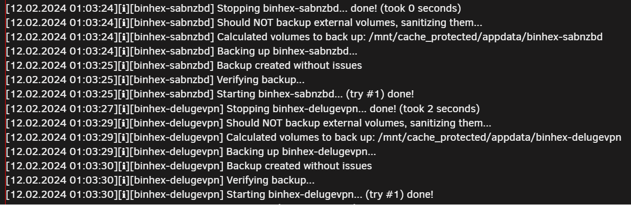

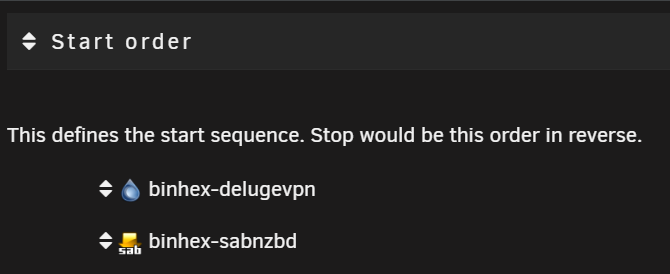

I'm also noticing this behavior where my containers are not started in the proper order. For example, I have binhex-delugevpn set to start before binhex-sabnzbd (which uses the VPN network of Deluge), but Sabnzbd attempts to start up first but is missing the proper network (Deluge does not start until after Sabnzbd).
The ordering bug (?) only affects containers with no group assignments.
Regardless, you should group these. Where container B depends on container A:
  • without groups: A is stopped for backup which may cause errors with B, before B is stopped for backup
  • with groups: B is stopped, then A is stopped, then both are backed up, then A's started, then B's started
Edited by CS01-HS
I'm a bit of a noob here, but I don't see any way to group containers in Unraid interface. I just assumed since one is assigned to use the network of the other that they would be "grouped". Any tips appreciated.
When you click a container's name in the appdata backup settings options for that container expand, including grouping.

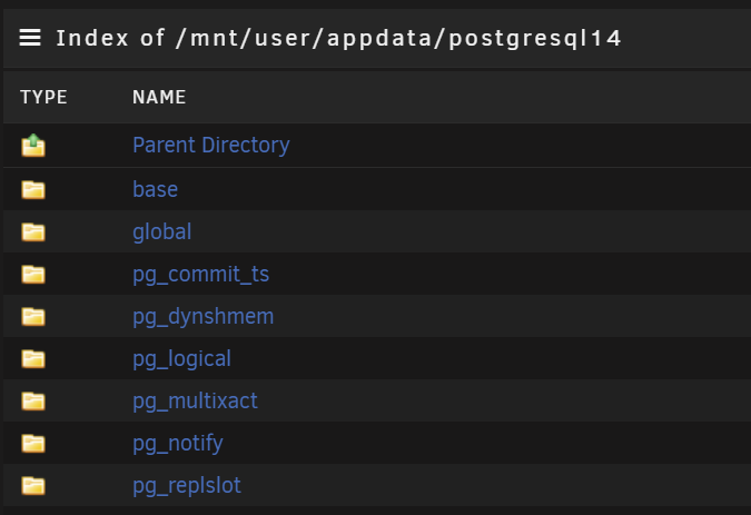

Hello. I'm getting a few of these warnings:
[⚠️][postgresql14] postgresql14 does not have any volume to back up! Skipping. Please consider ignoring this container.
[⚠️][Redis] Redis does not have any volume to back up! Skipping. Please consider ignoring this container.
[⚠️][duckdns] duckdns does not have any volume to back up! Skipping. Please consider ignoring this container.
While I do not have an appdate directory for Redis nor duckDNS (not sure why not) I do have one for Postgresql14.
1. Why is this happening with Postgresql14?
2. Would I not be able to restore Redis and DuckDNS with settings without including them somehow?
3. In the appdata backup directory I see files for old containers that I removed years ago. Why are these being backed up?
4. I assume the log note: "Should NOT backup external volumes, sanitizing them..." I get for every container is not important and can be ignored?
Debug ID: 2a4e4db7-239d-4f7d-a94f-00fc8562fb69
You are missing "/mnt/cache/appdata" as 2nd value for "Allowed source paths", which is currently only "/mnt/user/appdata". Like now, all container volume mappings are considered "external".
Ok thanks. I added /mnt/cache/appdate in the template. I still get a note: "Should NOT backup external volumes, sanitizing them..." for every container. I assume this can be ignored.
updated debug log: 7b56de88-4ccd-4c1d-83a8-48bd77ffdf47

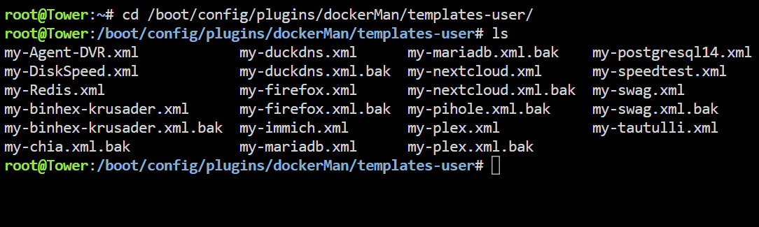

8 minutes ago, adminmat said:
In that directory these files are created upon running the backup:
my-chia.xml.bak
my-chia.xml
my-pihole.xml.bak
my-pihole.xml
Your post wasn't clear that it was xmls you were talking about, sounded like you had appdata archives for those old containers.
They should be in Previous apps and you can delete them from there.
The .xml.bak ones will have been backup copies made by... who knows what and they will not appear in previous apps, you can go clean them up yourself from the flash drive in /boot/config/plugins/dockerMan/templates-user
But yeah since someone else had the same question on Discord earlier it seems the plugin switched to copying the whole directory contents in the recent update.
Edited by Kilrah
Thanks., Do I need any of these .xml.bak files? Should I delete them all?
I don't have any, guess it was an old version of something that made them. do a ls -l to see the dates, but most likely it's all old stuff and you could remove them all.
Thanks for the help. I deleted all the old .bak files. I read it's from upgrading the OS. I think back in 2020.

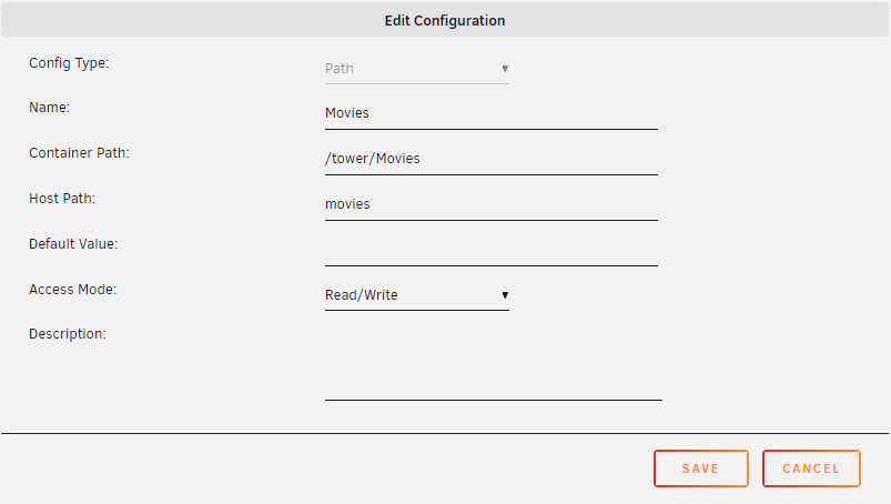

Right, the volumes were created in command line, but unraid's gui accepts them as the host path. Same with regular named volumes, if the host path does not begin with a forward slash, docker will use a named volume instead of a bind mount. Unraid's gui simply passes that value to docker run and does not interfere with the outcome.
Here's what the volume setting looks like:
