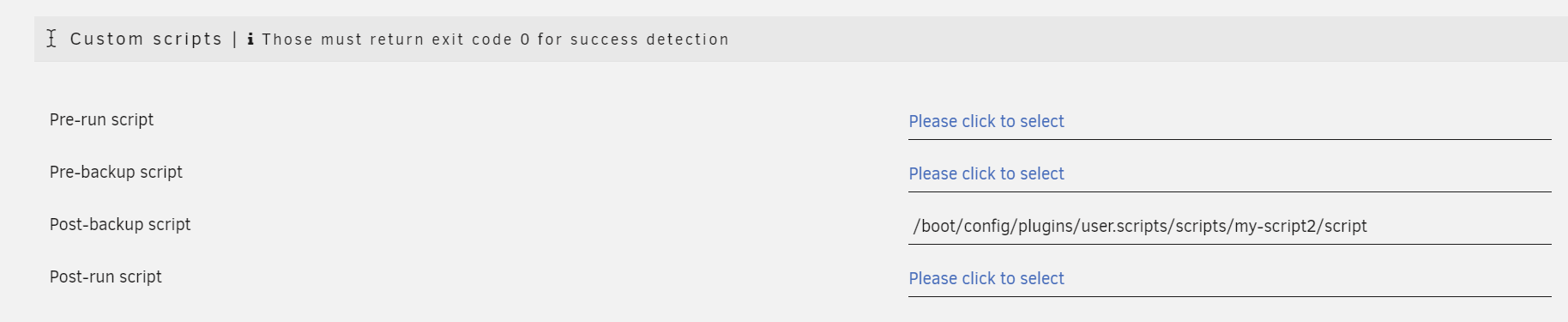

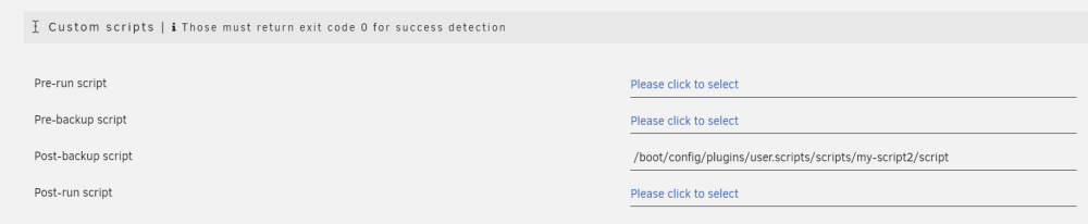

i am trying to run a Post-backup script (from the User-Scripts plugin), but the backup failed, because the script does not exists, which is not true, see:
[01.01.2024 03:29:34][][Main] /boot/config/plugins/user.scripts/scripts/my-script2/script is not existing! Skipping!
root@server:~# file /boot/config/plugins/user.scripts/scripts/my-script2/script
/boot/config/plugins/user.scripts/scripts/my-script2/script: Bourne-Again shell script, ASCII text executable
root@Home-Server:~# ls -la /boot/config/plugins/user.scripts/scripts/my-script2/script
-rw------- 1 root root 229 Dec 30 18:32 /boot/config/plugins/user.scripts/scripts/my-script2/script
Am I doing anything wrong with my configuration?

Scripts on the boot flash are not executable (FAT32 storage doesn't support linux permissions). The User Script plugin copies scripts to /tmp/user.scripts/tmpScripts/ before running them.

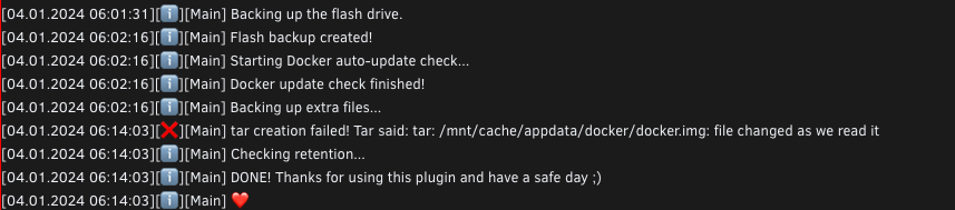

I have been getting errors for days/weeks with my backups saying that there's no space left on device, when I have over 1 TB free.
Debug key 372c1d4e-122a-4194-bf1c-a9189c65da2e
Example:
[02.01.2024 09:50:25][ℹ️][traefik] Stopping traefik... done! (took 13 seconds)
[02.01.2024 09:50:38][ℹ️][traefik] Should NOT backup external volumes, sanitizing them...
[02.01.2024 09:50:38][ℹ️][traefik] Calculated volumes to back up: /mnt/user/appdata/homelab/traefik-docker/certs, /mnt/user/appdata/homelab/traefik-docker/rules.yaml, /mnt/user/appdata/homelab/traefik-docker/letsencrypt
[02.01.2024 09:50:38][ℹ️][traefik] Backing up traefik...
[02.01.2024 09:50:38][][traefik] tar creation failed! Tar said: tar (child): /mnt/user/backups/homer/mnt/user/appdata/ab_20240102_094256/traefik.tar.gz: Cannot open: No space left on device; tar (child): Error is not recoverable: exiting now; tar: /mnt/user/backups/homer/mnt/user/appdata/ab_20240102_094256/traefik.tar.gz: Wrote only 4096 of 10240 bytes; tar: Child returned status 2; tar: Error is not recoverable: exiting now
[02.01.2024 09:50:40][ℹ️][traefik] Starting traefik... (try #1) done!
[02.01.2024 09:50:45][ℹ️][unifi] Stopping unifi... done! (took 6 seconds)
[02.01.2024 09:50:51][ℹ️][unifi] Should NOT backup external volumes, sanitizing them...
[02.01.2024 09:50:51][ℹ️][unifi] Calculated volumes to back up: /mnt/user/appdata/unifi, /mnt/user/appdata/homelab/unifi-docker/config.gateway.json
[02.01.2024 09:50:51][ℹ️][unifi] Backing up unifi...
[02.01.2024 09:50:51][][unifi] tar creation failed! Tar said: tar (child): /mnt/user/backups/homer/mnt/user/appdata/ab_20240102_094256/unifi.tar.gz: Cannot open: No space left on device; tar (child): Error is not recoverable: exiting now; tar: /mnt/user/backups/homer/mnt/user/appdata/ab_20240102_094256/unifi.tar.gz: Wrote only 4096 of 10240 bytes; tar: Child returned status 2; tar: Error is not recoverable: exiting now
[02.01.2024 09:50:53][ℹ️][unifi] Starting unifi... (try #1) done!
But looking at free space:
root@homer:~# df -h /mnt/user/backups/homer/mnt/user/appdata/
Filesystem      Size  Used Avail Use% Mounted on
shfs             11T   10T 1002G  92% /mnt/user
Check the Min Free Space setting on the share in question.

It's set to 390.5 GB.
EDIT: OK I think what's happening here is that I don't have more than that amount of space available on any of my disks. The language for free space makes it seem like it's at the share level, but because Unraid writes entire files to disk it needs to ensure that there is that much free space available on *some* disk in the array. I reduced this to 10 GB for all shares and will try again.
Edited by kstrike155
epiphany
It's a "for this share, don't fill any drive more than X"

I read that as: "if there's this much free space available on disks belonging to the share, allow writing".
Looks like that was the problem as now it's fixed, thanks for the tip!

Is there a way to backup the docker.img with the plugin?
I put the path in the extra folders but looks like it starts the docker service prior
