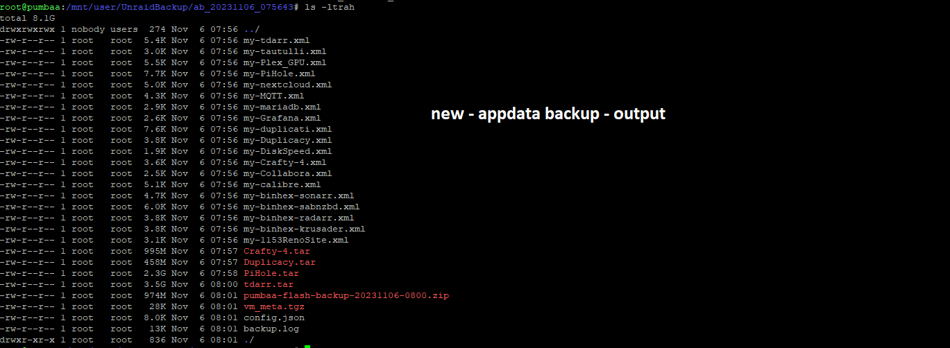

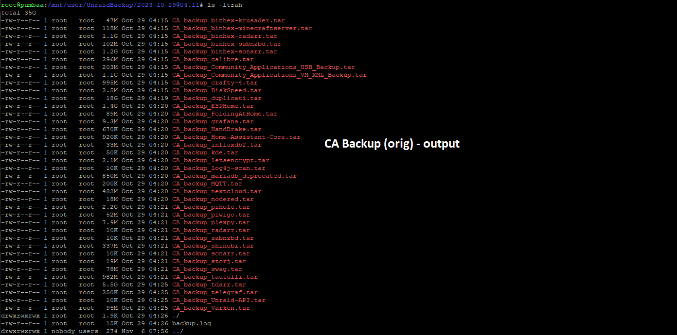

Hi @KluthR -- I'm still having some issues with the new appdata backup. Sorry if I'm missing something but below I've added a screenshot of the output of my old backups using CA_Backup plugin and another with the output of the new appdata backup. Am I doing something wrong? Notice how many /appdata/config folders don't seem to be getting backed up. I've also attached the config for you. Thank you.
config.json
What's the mess in the Appdata sources? Should typically only be
/mnt/user/appdata
/mnt/cache/appdata
and definitely not anything from specific containers
Right, I had it as /mnt/user/appdata and it was doing this same thing so I went ahead and checked each box explicitly hoping it would change something, it did not.
Share a log, not a config. The new plugin only creates archives when there is something to back up.
