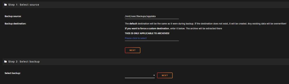

I attached the debug log. Also, If I try to restore via the plug-in , I do not see any back-up
If I'm not mistaken, even though I got that warning, back-ups are successfully done and I could restore manually, correct?

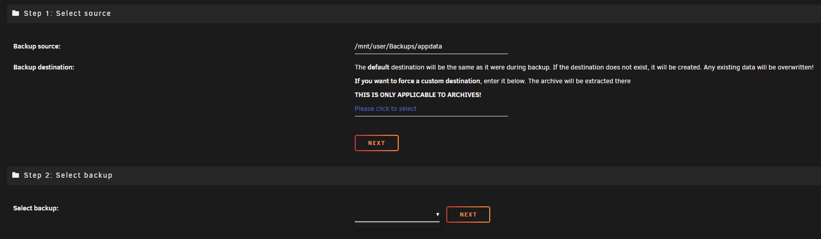

On 10/21/2023 at 4:14 PM, KluthR said:
So, simple pngs. I will check this.
Did you found some issue? Can I help you with more informations?
Do you have https for your Unraid UI enabled? This would prevent the browser from loading mixed content then, because the png storage is http-only.
Yes. This was the problem.  Thank you very mutch for your support!!!!
