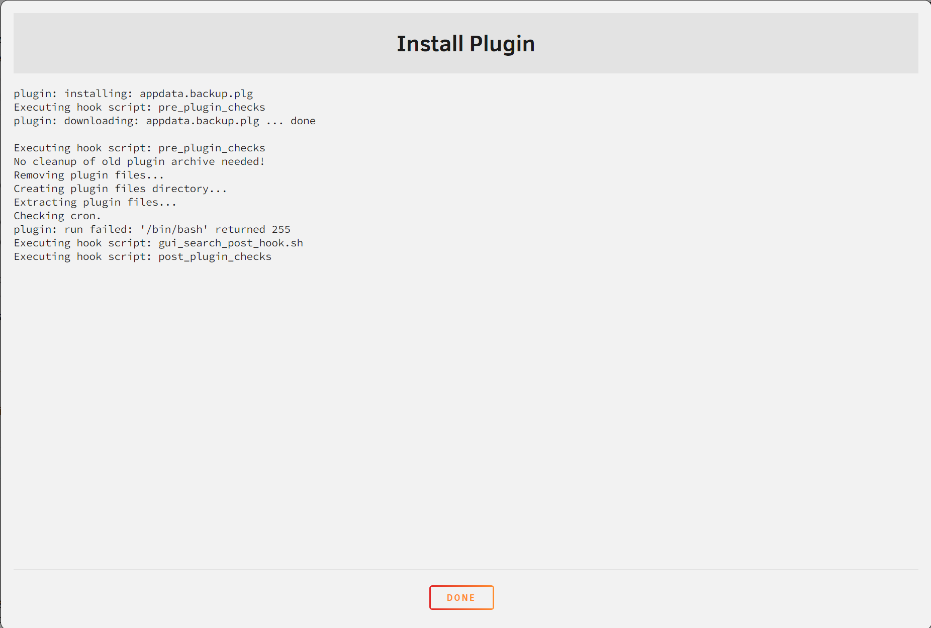

I have been trying to update to this plugin from the previous but can't seem to get it installed.  When I attempt to install it I see the following error:
plugin: installing: appdata.backup.plg
Executing hook script: pre_plugin_checks
plugin: downloading: appdata.backup.plg ... done
No cleanup of old plugin archive needed!
Removing plugin files...
plugin: downloading: appdata.backup-2023.09.12.tgz ... done
Extracting plugin files...
Checking cron.
plugin: run failed: '/bin/bash' returned 255
Executing hook script: gui_search_post_hook.sh
Executing hook script: post_plugin_checks
I've tried rebooting Unraid as well but always end up seeing the run failed '/bin/bash' error when attempting to install it.  Any thoughts?

Still seeing the same I think
Creating plugin files directory...
Checking cron.
On 6.12.4? What other plugins are installed? Maybe add a diagnostic file.

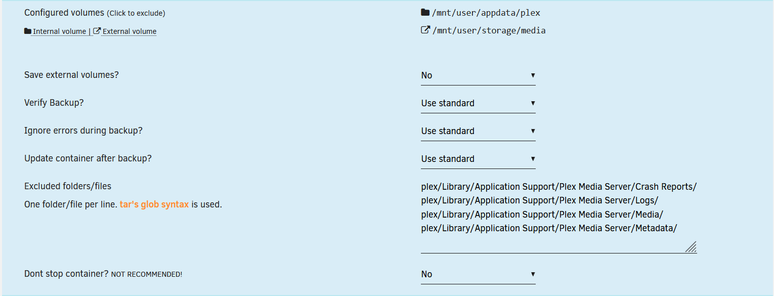

Anyone else having problems with the "excluded folders" being ignored on the latest version?  Sometime in Sept my backup size increased dramatically, looked at the .tar.gz files and my Photoprism cache folder is now being backed up even though I have it excluded.
Does this make sense for excluded folders for Plex?
Try using /mnt/cache/appdata instead of /mnt/user.
You have to use absolute paths. But yes, then it would work
Edited by KluthR
Oh I should have '/mnt/cache/appdata/' in front of each line, that's a dumb mistake.
Does it include subfolders in that format? For example if I use the GUI to add the '/Plex Media Server/Media/' folder, then the Plugin adds two lines to that text field:
/mnt/cache/appdata/plex/Library/Application Support/Plex Media Server/Media/
/mnt/cache/appdata/plex/Library/Application Support/Plex Media Server/Media/localhost/
Are both lines needed or can I get rid of the second/localhost one?
The last one can be ommited. And yes, that includes all subfolders as well.
Thanks. Lots of housekeeping now that I'm finally brave enough to leave 6.11.5

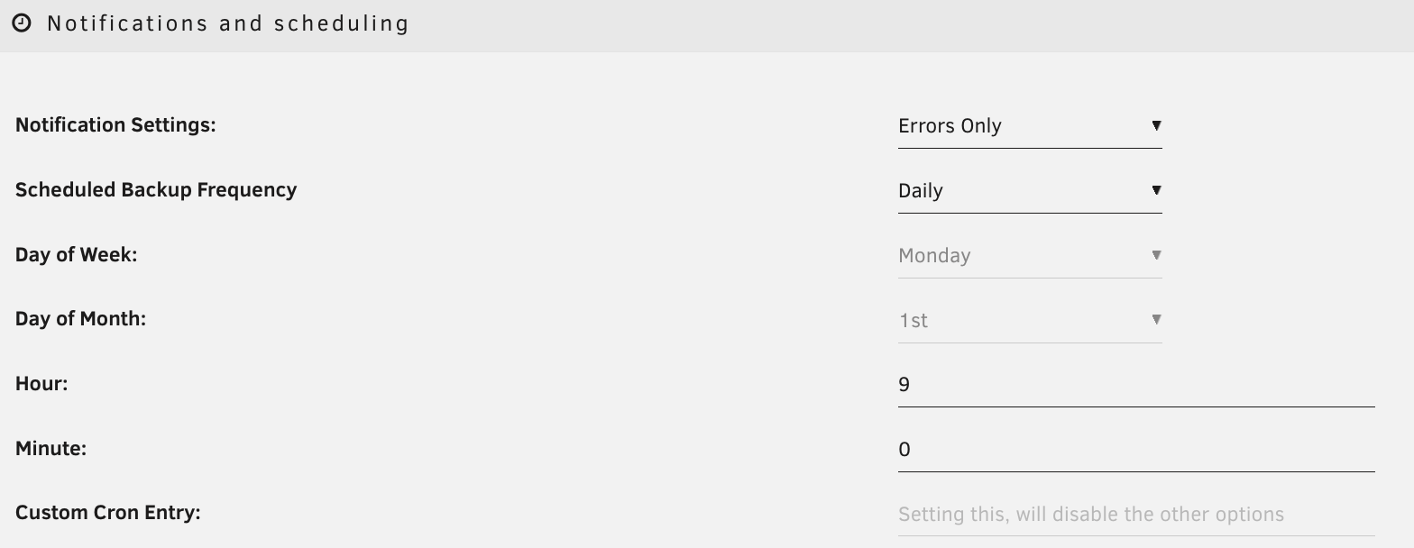

Hi!
I'm loving the plugin, it completely replaced my custom script. I'm only having a little issue about the notification settings, it doesn't seem to work?
1926689879_Screenshot2023-10-02at17_37_12.thumb.png.ca3f1e3749db180593462bd750a37993.png
I still receive a summary message:
Thank you!

The log window shows the following when trying to install it.
Oct  2 17:43:19 Tower root: plugin: running: anonymous
Oct  2 17:43:19 Tower root: plugin: checking: /boot/config/plugins/appdata.backup/appdata.backup-2023.09.27.tgz - SHA256
Oct  2 17:43:19 Tower root: plugin: skipping: /boot/config/plugins/appdata.backup/appdata.backup-2023.09.27.tgz already exists
I also tried deleting that file and then reinstalling it and get the following.
Oct  2 17:44:20 Tower root: plugin: running: anonymous
Oct  2 17:44:20 Tower root: plugin: creating: /boot/config/plugins/appdata.backup/appdata.backup-2023.09.27.tgz - downloading from URL https://github.com/Commifreak/unraid-appdata.backup/releases/download/2023.09.27/appdata.backup-2023.09.27.tgz
Oct  2 17:44:20 Tower root: plugin: checking: /boot/config/plugins/appdata.backup/appdata.backup-2023.09.27.tgz - SHA256
With both instances I still see the same error (plugin: run failed: '/bin/bash' returned 255) in the install window.

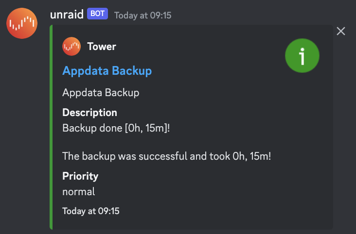

The final message is new and is triggered always, just for information, like a normal success-notification. If this really causes flood messages, I would bring in an option to disable it?
Those messages are ok. I still dont get whats causing the error. Never seen that before :/
Thank you for your reply!
It doesn't cause any issues/flood, I just thought that "Errors only" would not send any other notification; I am a "no news is good news" type of person.
Again, thank you for your work!

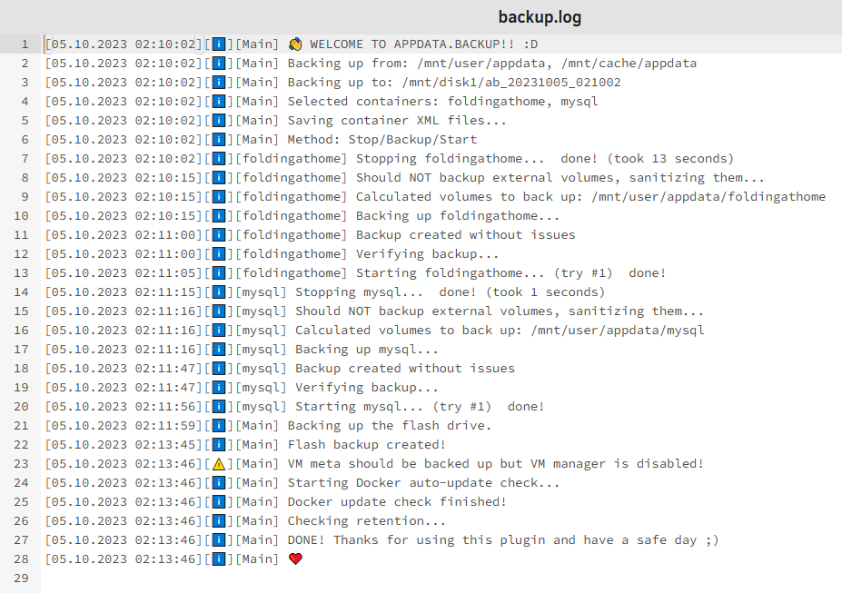

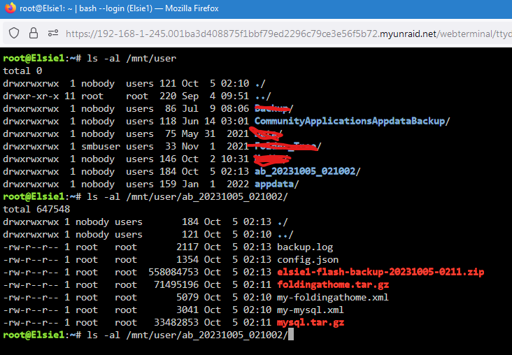

What is going on.  I found this on both of my Unraid servers today!
And here is the contents of backup.log file:
I really don't like that Share, ab_20231005_0211002, being created as root share!   IT is non-descriptive and should not be at this point in the tree structure!
Edited by Frank1940
