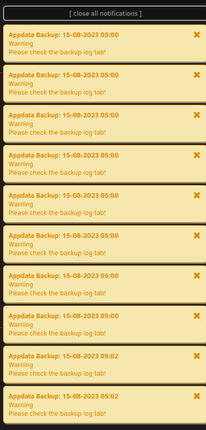

Last update has an issue with notifications, woke up to a slew of "warning: skipping verification for this container because its not wanted!" on unraid and discord just because the

Also got some "XML file for [container] was not found!", those are from compose stacks.
These should be at most info and not trigger the notification system as they are normal and will just spam everyday.
I would say, Warning is ok. It warns you, that it might be an issue, that some XMLs are missing. But I agree with the "not wanted" entry, that could go into the Info section. Maybe switching to error level for notifications is better for your setup?
EDIT: I believe I got you wrong. Your setting IS errors only, right? There is a bug, that also sends warnings out. I'll fix that.
Yep my setting is "Errors only". Didn't remember it was there, but yes :D
