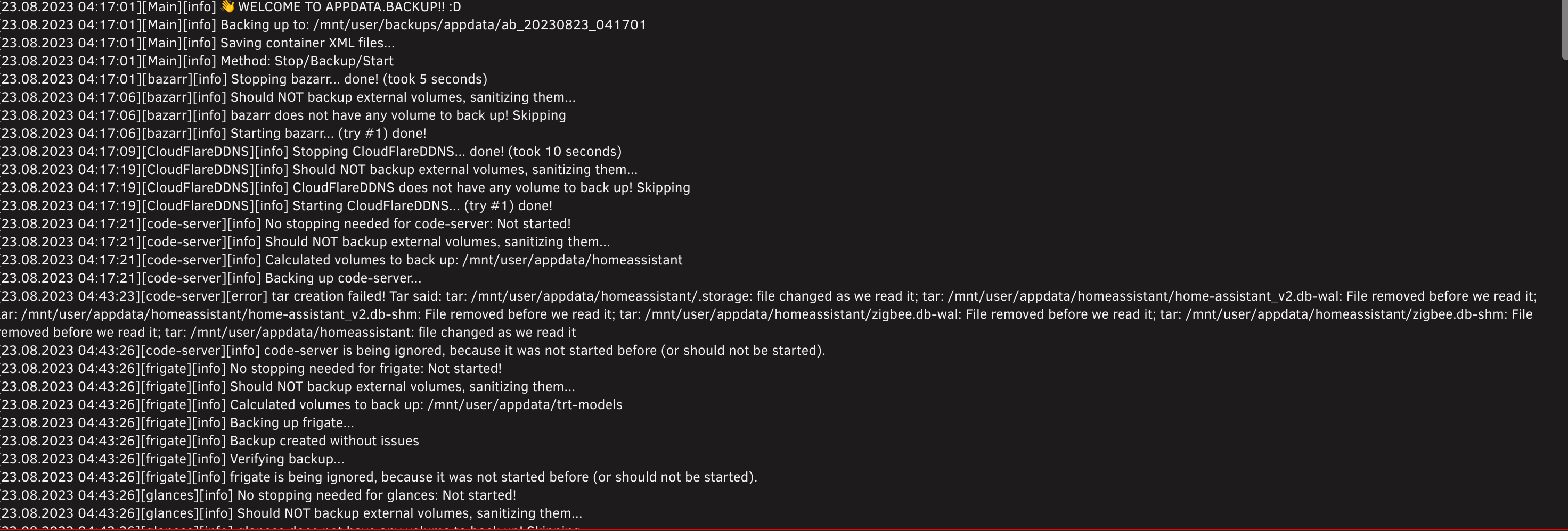

On 8/26/2023 at 5:30 AM, jbrown705 said:
and usually something about a file within a docker changing before it was read
Either allow the container to stop or set the plugin to ignore errors for those containers, knowing the backup for those won't be consistent.

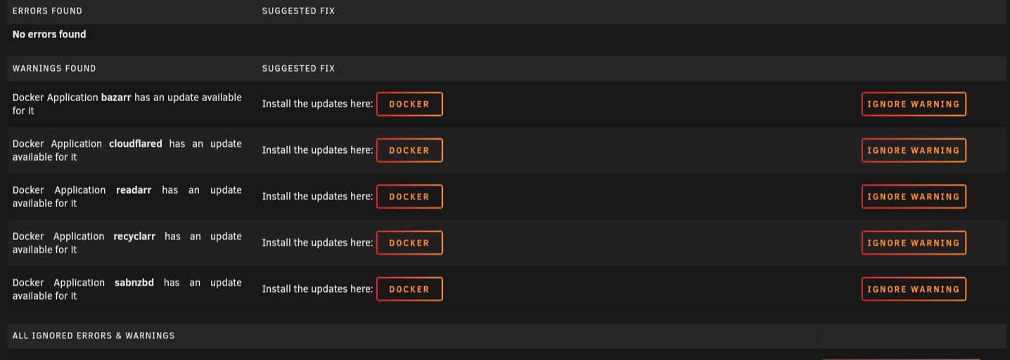

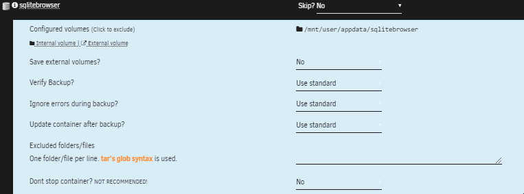

- is there an issue with the docker-update functionality ??
i have a few dockers that is not updating,, sqlitebrowser as an example:
Appdata backup has run after this,, finding no update:
in Appdata-settings i have the "update containers after backup" set to YES , and this is the specific:
Sometimes i just click the updates when doing other stuff,, so not really sure if it has worked at all after updating to 6.12?
Is there something else I need to configure or any other checks to do??
4 hours ago, ArveVM said:
Version: 6.12.3, AppdataBackup 2023.08.16

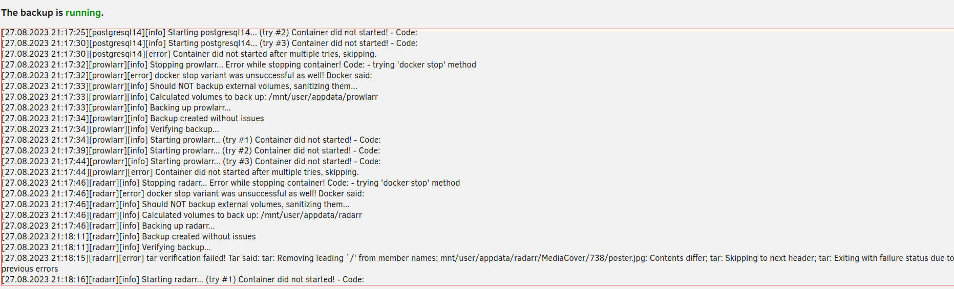

I am having an issue with getting any backup to complete.
Seems, that the mentioned container is accessing data from Home-Assistant which, I guess, is running? If so, please exclude the HA mapping from that metioned container.

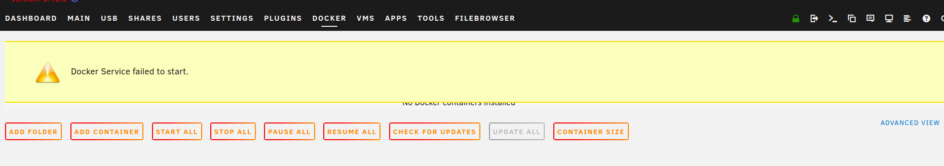

13 hours ago, MarianKoniuszko said:
Hello, everytime Appdata Backup plugin do the job my docker service stop working
The plugin does NOT touch the docker service itself in any way! Please share a debug lof for further inspection.
Yep, see above. Im on it.
