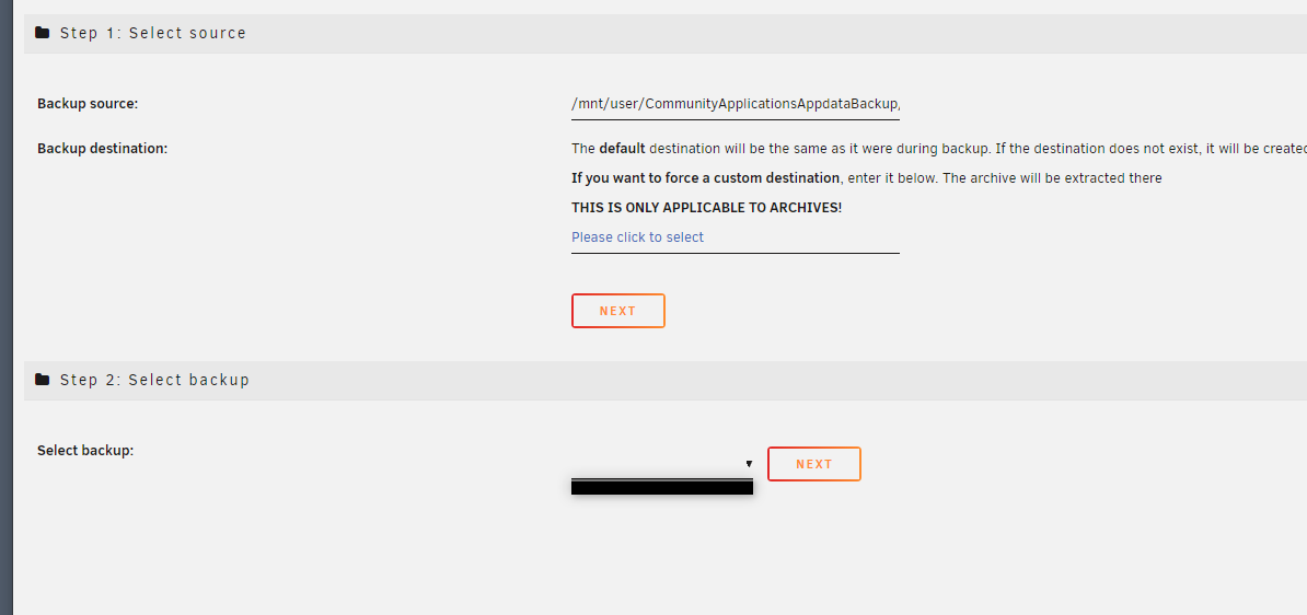

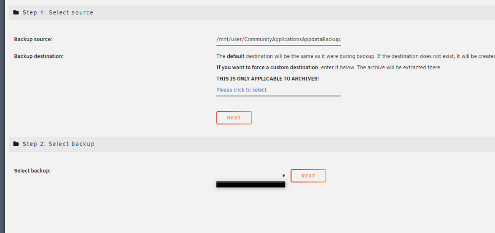

Trying to restore for the first time today and I'm having issues.  When I try to select the backup to restore, I get an empty dropdown.
What am I missing here?  I have plenty of backups to choose from.
Thanks!
Old backups from the older plugin version are not supported. And all newer have -failed suffix and are not available either.
(i.e. you'll have to manually extract what you need from the archives in the backup folder and put it in the right place).
Edited by Kilrah
Exactly. And check whats wrong with your backup by checking the backup log.
