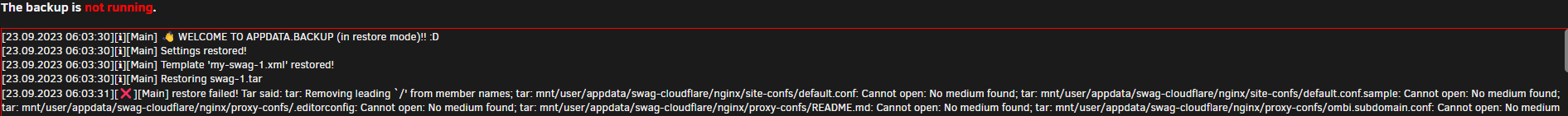

So I have moved to a new unraid system and needed to restore my appdata (fresh install of everything) I have my backupd from just before I decommissioned my old server, restore sees them and tried to restore them, but I get an error when I do.
I have tried one at a time also and get the same errors. Here is the log from when I tried to restore swag.
(it just repeats the same message for all the files.
Debug log ID: d4fa841f-c17f-4dd1-b7bc-d435c0372cb4
So I figured out my issue. My New setup is zfs and datasets not folders, renamed the dataset appdata to appdata1 and then ran the restore and it work great.
So incase people run into the issue, you cant restore the folders if they were converted to datasets. (and I am sure vs versa)
