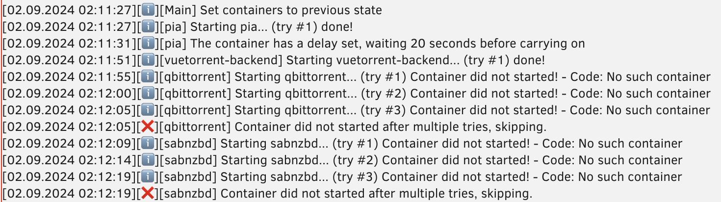

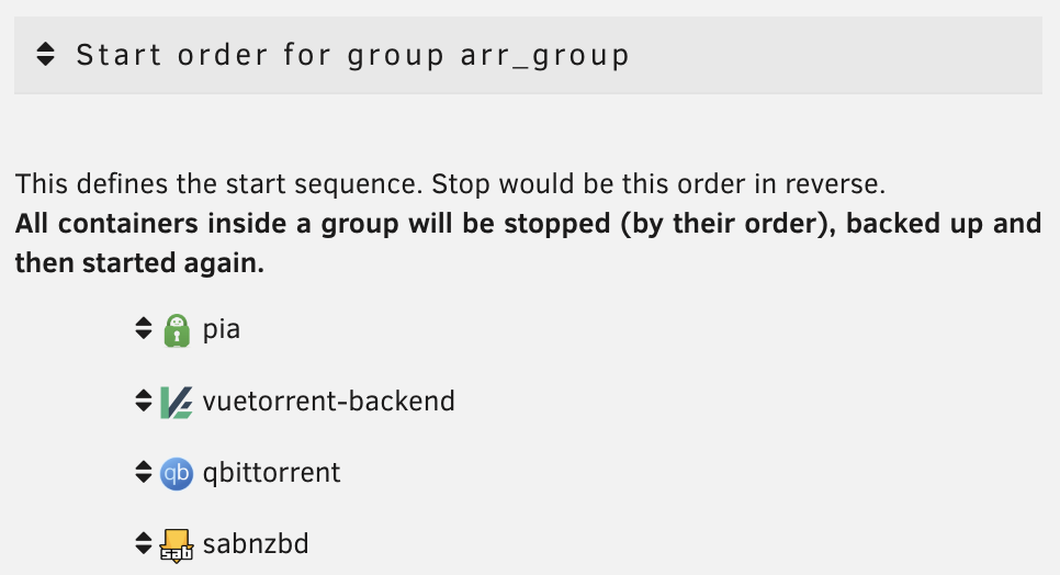

pfdt Posted September 8 Share Posted September 8 (edited) Hello, I always have the same problem with my backups and cannot find a solution : my containers which depends on another container (a vpn network) failed to restart. I have these containers : PIA : my vpn app (with a starting delay of 20 seconds) qbittorrent : depends on the network of PIA (--net=container:pia) sabnzbd : depends on the network of PIA (--net=container:pia) In the plugin, these 3 containers are grouped in a dedicated folder : During backup : 🟢 All the containers stop well (in the reverse order) 🟢 All the containers backup and update well 🟢 PIA restart successfully and then wait for 20 seconds 🔴 qbittorrent and sabnzbd failed to restart, even after 3 tries The stop and restart orders seem OK but I don't understand the problem. PIA only needs 5s to start, after 20s it is fully working. I have tried with a higher starting delay after PIA but the problem is the same. I've find discussions with this problem in the forum but the solution was to create a group which is already done here. Here is an extract of the log : Please can you tell me what I am doing wrong ? Edited September 8 by pfdt Quote Link to comment
KluthR Posted September 8 Author Share Posted September 8 The error says it all „No such container“ I dont know why docker thinks its not there. I would need to vuilt in more debug infos here. But for now: please do a „docker ps -a“ when this happens. Quote Link to comment
Kilrah Posted September 8 Share Posted September 8 Have you set AB to update your containers, and would by any chance one of them have been updated in parts of the logs you truncated? Quote Link to comment

pfdt Posted September 9 Share Posted September 9 On 9/8/2024 at 4:40 PM, KluthR said: The error says it all „No such container“ I dont know why docker thinks its not there. I would need to vuilt in more debug infos here. But for now: please do a „docker ps -a“ when this happens. Hello KluthR, ok I will do a docker ps -a next time. But it it helps : when it happened I can easily start the stopped containers in the Unraid UI. 20 hours ago, Kilrah said: Have you set AB to update your containers, and would by any chance one of them have been updated in parts of the logs you truncated? Thank you Kilrah, I've checked and yes : PIA have been updated the last times. I've made a couple of test and discovered that no : the problem doesn't occur every time. My 2 manual backups of the day finished without any problem. So the update of the vpn container is a good lead... Quote Link to comment
JonathanM Posted September 9 Share Posted September 9 3 minutes ago, pfdt said: when it happened I can easily start the stopped containers in the Unraid UI. Probably because the Unraid container page tracks them by name, which doesn't change when updated. The actual container ID does change. Run the docker ps -a before and after an update, and compare the first value in each line. You can do docker ps -a>>/boot/list.txt which will write list.txt to the root of the flash drive if you want a more permanent copy, plus you can cut n paste to here easier. Quote Link to comment
KluthR Posted September 9 Author Share Posted September 9 2 hours ago, JonathanM said: Run the docker ps -a before and after an update, and compare the first value in each line. You can do Yea, that makes sense 2 hours ago, JonathanM said: Probably because the Unraid container page tracks them by name, which doesn't change The same way I do. I also use the exact same method to start the containers. Quote Link to comment
pfdt Posted September 9 Share Posted September 9 3 hours ago, JonathanM said: Run the docker ps -a before and after an update, and compare the first value in each line. You can do docker ps -a>>/boot/list.txt which will write list.txt to the root of the flash drive if you want a more permanent copy, plus you can cut n paste to here easier. Ok done, I let you know when it happens again Quote Link to comment
Kilrah Posted September 9 Share Posted September 9 4 hours ago, pfdt said: Thank you Kilrah, I've checked and yes : PIA have been updated the last times. That'll be it, when it gets updated it gets deleted and recreated, its ID changes, so now the container the others reference for their network is gone. Best not to do autoupdates when there are dependencies like this. Quote Link to comment
