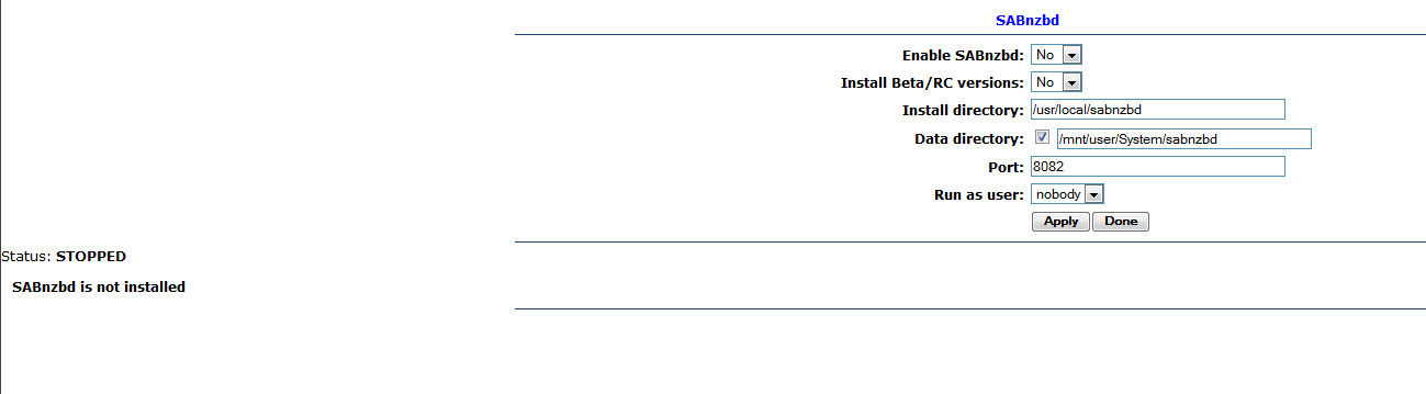

I'm using Influencer's last branch version from the github that is before those changes were made.
https://github.com/W-W/unRAID/tree/Influencer  (Have to copy and paste code, raw takes you master with newer changes)
Has the new SAB download fix for the latest version dir change on sourceforge but none of the newer code that appears to be broken. (attached)
My config still looks like this:
# sabnzbd configuration
SERVICE="disable"
INSTALLDIR="/usr/local/sabnzbd"
DATADIR="/mnt/user/System/sabnzbd"
PORT="8082"
RUNAS="nobody"
INSTALLBETA="no"
Data is installed to a regular array drive (not a cache)
Like I said worked perfectly on first use day before yesterday but then started hanging on install after a reboot with no changes to my system.
Appeared to be the same issues you guys are having with the latest ww so I thought maybe the SAB guys did something with the download url again.
But maybe my issues are different so you might try this one.
sabnzbd_mod-influencer-062512.plg.txt

A little update on the problem with sab, it seems sourceforge has changed how the downloads work, there is a "token" of sorts issued with each download, so there is no way to directly get the file without being redirected.
wget still downloads the file fine, but looks like it doesn't close the connection afterwards so the rest of the script never runs

Quick fix to get everyone up and running, this is an older version, don't bother using the installbeta, I completely disabled it for this release.
This release is hardcoded to use 0.7.0 for now, and I am ONLY releasing this as a temporary fix until it can be fixed elegantly.
Just remove your current plg(or rename it to something other than .plg) and put this one in, reboot or run:
installplg /boot/config/plugins/sabnzbd_hardcoded.plg
Again, this is a temp fix, using an old (but known stable) version I have saved.
