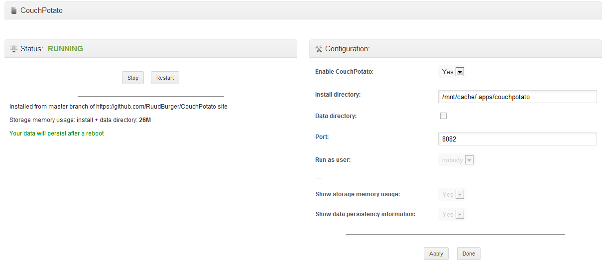

In SABnzbd i added START/STOP and RESTART buttons. I also added showing data size and data persistency informations only on user demand.
In other plugins (SickBeard, CouchPotato v1/v2) i added ability to install from different GitHub sites and branches - these settings are in advance configuration section.
Appearance of the plugins was changed - see attachment.
