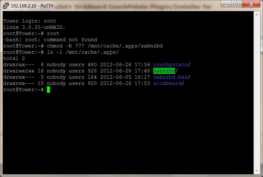

EDIT: Dammit, still getting this issue:
Installing latest version of SABnzbd...
... OK
Starting SABnzbd: sudo -u nobody python yes/SABnzbd.py --daemon --server 0.0.0.0:/usr/local/sabnzbd --config-file yes --pid /var/run/sabnzbd/ 2>&1 >/dev/null
EDIT2: Well, it decided to tell me it was uninstalled and after a bit of persistence, despite it being not enabled, it's now running :S

i am away on a business trip week and don't have actual access to my unraid console. i've got everything working just perfect except for plex.
i login to the http://myip.com:43200/manage and i'm asked for a user / pass combo. I found a plex_settings.cfg file where one might expect a username variable to reside but can find no documentation anywhere for what the variables are.
i don't have vpn access (nor do i want it) so i figure the only way to resolve this issue for now is to set the user / pass manually. please could someone enligthen me as to how to do this??
for some odd reason I can't update to the 0.7.0 version probably some permissions thing yet again.... my sab folder looks different than the others now... :(
-=Jason=-
I guess I can manually download the update, and extract them????
