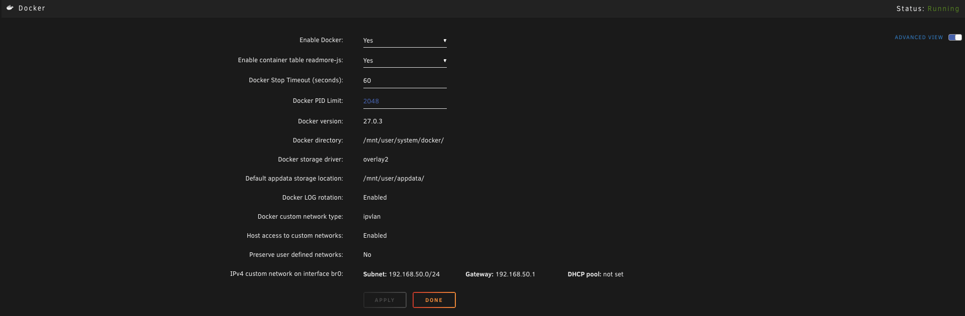

Followed the suggestion to move to overlay2 as I have a ZFS cache pool that holds the docker images. Docker containers seem quite slow to download however. This issue is compounded because it seems while a docker image is being pulled I can't access the frontend from another tab.
Edit: looks like pulling a docker container via CLI does not block the UI in the same way
These are my docker settingsScreenShot2025-01-10at14_02_01PM.thumb.png.a5eca3e161775787455614708302d086.png

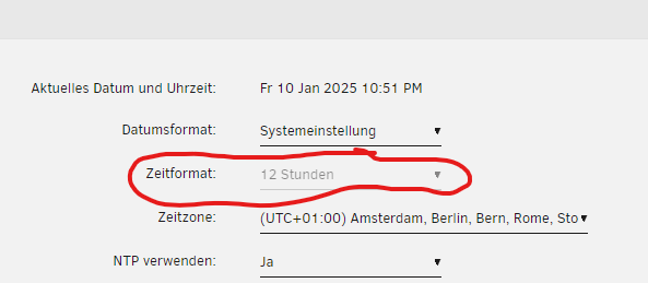

Just updated to 7.0.0 .
Any idea why i can't set the time format to 24 hours (selection is set to 12 hours and is grey / unselectable)?
This happened to me on Unraid 6.12 with data directory + zfs pool. I already posted earlier in this thread but I am not sure this is resolved with overlay2. Docker official docs seem to say overlay2 + docker are not a match:
https://docs.docker.com/engine/storage/drivers/select-storage-driver/#supported-backing-filesystems
The UI in Unraid is also confusing as it offers native vs overlay2 but native says docker directory will use the supported file system (i.e. zfs).
I'm stuck waiting on more official news but your note has me paused given it's the exact behavior I experienced (blocked web UI when docker download/unpacking was occurring, slow docker changes/apps, and docker operations causing lockups on docker apps).
15 minutes ago, ich777 said:
This is often times a issue with the routing from your ISP or even Docker Hub itself, my downloads today from GitHub are sometimes around under 1MB/s
Yeah that is fair, after getting all 24 of my containers pulled, it does actually seem faster at extracting the layers than it was before. So main thing I am curious about is why the frontend won't load in other tabs while one tab is running the docker container command.
First set the "date format" field above it to something other than "system setting"

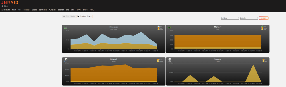

4 hours ago, NoRaid99 said:
The only thing what is not working is the "stats page". I deleted cookies and browser cache, but this didn't help. Could it be that stats is not working because of the "none" array drives?
Sorry... anybody a idea?

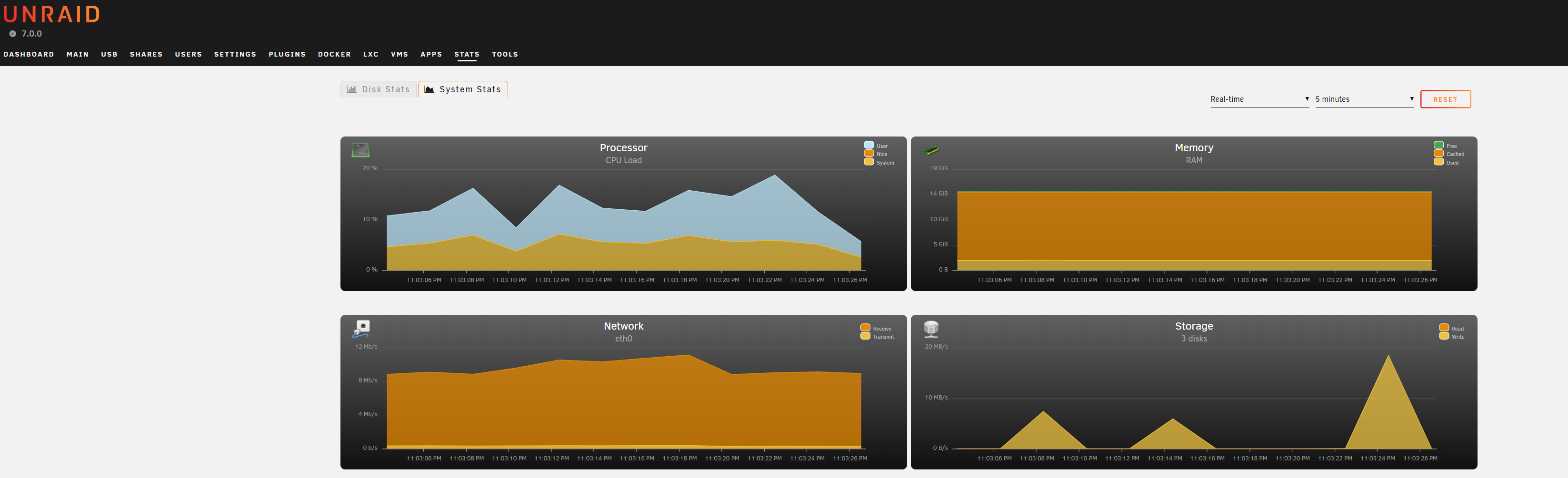

Stats is a plugin and not part of core Unraid post in the plugin support page.
