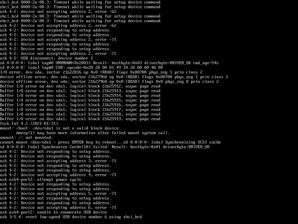

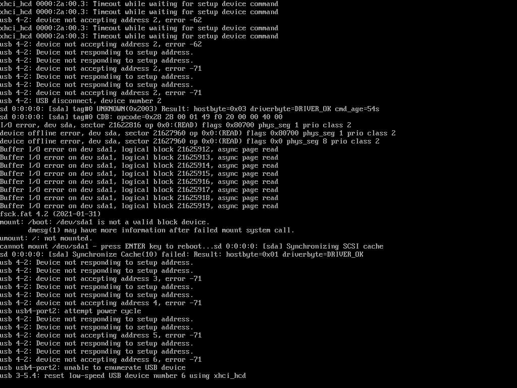

Main system upgrade from 6.12.14 so far is failing to boot and looking like something hosed on the flash drive. This is an AMD 5600x on x570-d4u - initially looks like it's failing to mount /dev/sda1 and it gets stuck here. Starting investigation and will open a separate thread if I can't figure this out.
update 1: There are two other USB devices attached - the UPS (Cyberpower) , and a Rainforest EMU-2. Disconnecting both devices allowed the system to boot without issue, though oddly the HomeAssistant docker did not start (and had no unusual logs). Manually started just fine. Plugged both USB devices back in - the Rainforest is working properly. NUT plugin is not starting yet, but that's probably because the UPS wasn't there at boot so chasing that now.
Still very confused by why this happened, but at least it was relatively straight-forward to troubleshoot and get to a better place.
update 2: Rebooted again with both USB devices attached. This time, it automatically rebooted somewhere in the startup process (I was distracted and did not see it happen, only noticed when it went back to POST) but then that second boot worked through cleanly and the system is back up fully, NUT sees the battery, HomeAssistant started up automatically, and everything seems back to working properly. Meanwhile, this has reinforced the value of IPMI for me...
update 3: It turns out usb 4-2 is in fact the flash drive. I did not change ports. I did, however, unplug the flash drive and attach it to a Windows computer to check it wasn't showing errors there or anything, and I did this before the successful boot without the other two USB devices. It took an unusual amount of time to unmount. Makes me wonder if Windows quietly did something. It DID successfully start to boot,  Unraid though, so really no idea at this point. Very weird.
