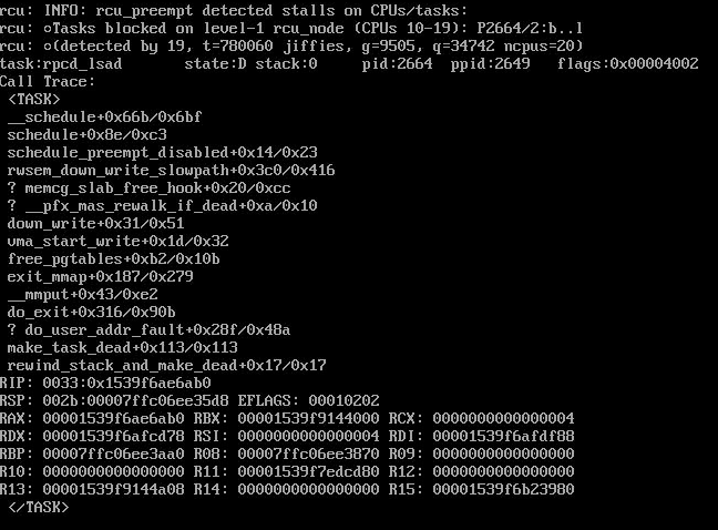

Upgrading from 6.12.10 to 7. 12700K | Asus Pro WS W680-ACE IPMI | 4060
I'm watching the upgrade through the IPMI and this part keeps looping. 30~ minutes so far.
Would someone be able to point me in the correct direction? Thanks!
Please create a new thread in the general support forum, but I would start by recreating the flash drive:
First backup the current one, then recreate it using the USB tool, confirm the flash drive boots with the stock install, and if yes, restore only the /config folder from the backup overwriting any existing files.

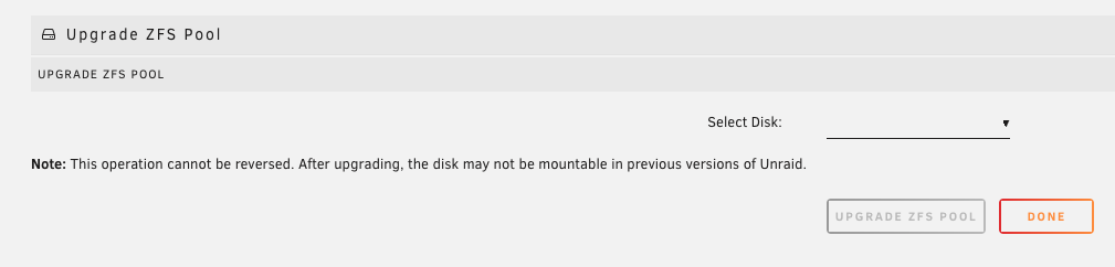

I am not seeing a way to upgrade my ZFS pool and cache (not array). I have two NVMe mirrored and two SATA SSD mirrored using the 6.12.x version of ZFS, but when I search for upgrade this is what I find. I cannot select any disks.
So I'm not sure what the steps are to upgrade my ZFS version.
in terminal what is the output of
zpool status
if it can be updated it will say so there... IF yes. then run the command manual...
zpool upgrade <poolname>
Replace pool name with info of pool to be upgraded...
it may have already been upgraded or unneeded...
Thanks, I can do it that way I guess, but the FAQ mentioned a button. It would be helpful to know where that is or at least what it looks like as I prefer to do these sorts of things per the manual.
ie "A button will appear letting you upgrade a pool to support the new ZFS features"
Click the pool name.
