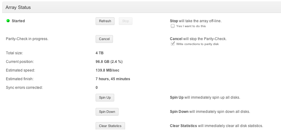

With v5.0-rc5 i've had parity check speeds in excess of 110MB/s, with rc11 it doesn't go faster then about 80MB/s. I've just went back to rc5, and i am now doing a parity check at almost 140MB/s :o bringing the time back from over 12 hours to under 8 hours... I know, the parity check speed is just one aspect of the total system, but i think it's a huge difference in speed, i dont know why this is? Shouldnt it be just the same on both versions?

Did you perform these parity checks under both versions without any addons? As far as I know all of your addons will continue to run during parity checks and any read/writes they are doing will affect the parity check performance. To really eliminate everything except the unRAID versions you should test parity check speed without addons.
For the record, i'm back to v5.0-rc5...
Same situation, all plugins/addons enabled, but not in an active state (e.g. not actually downloading or serving music etc).
Basically a normal situation... dont tell me you disable all plugins before doing the standard weekly/monthly check... ;)
No I don't disable anything normally, but a performance test is not a normal situation.
Then again, this wasnt a performance test... just a normal situation, one on rc11, one on rc5... same context, same circumstances.
I'm getting 110+MB/s on rc11, just like I've seen on most other releases.
That's very good - those drives must be fast, because parity check speed is more-or-less determined by the speed of your slowest drive and is, obviously, affected by any addon, or client application, which may decide to wake up and access drives during the check.
For instance, I see the speed drop by around 10MB/s if Transmission is running on my desktop machine (all my torrent files are held on unRAID).
All 7 disk are the same 4TB 7200rpm Hitachi's. For some reason, using rc11 the parity check is about 40% slower compared to rc5 on the same system. Would be nice to know why.
