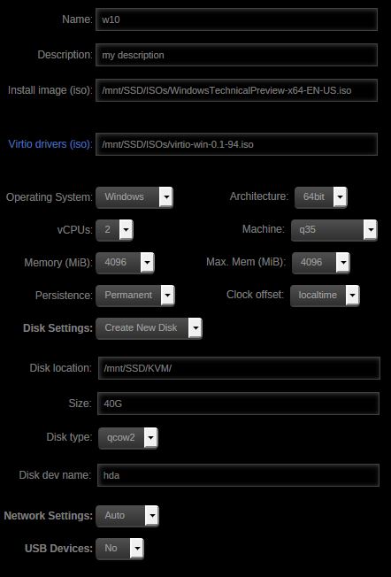

I setup my spare USB flash drive with a fresh copy of unRAID 6b12 and the latest Virtman and KVM Manager. The create VM tab doesn't seem to setup VM's properly. It creates the sub-folder and qcow2 image but doesn't actually create the VM as there are no VM's listed under the Virtual Machines tab after clicking the Create VM button.
Here is my error:
Warning: libvirt_domain_create_xml(): internal error: early end of file from monitor: possible problem: 2014-12-25T04:32:52.796650Z qemu-system-x86_64: -device ide-cd,bus=ide.1,unit=1,drive=drive-ide0-1-1,id=ide0-1-1: Can't create IDE unit 1, bus supports only 1 units 2014-12-25T04:32:52.796671Z qemu-system-x86_64: -device ide-cd,bus=ide.1,unit=1,drive=drive-ide0-1-1,id=ide0-1-1: Device initialization failed. 2014-12-25T04:32:52.796679Z qemu-system-x86_64: -device ide-cd,bus=ide.1,unit=1,drive=drive-ide0-1-1,id=ide0-1-1: Device 'ide-cd' could not be initialized in /usr/local/emhttp/plugins/dynamix.kvm.manager/classes/libvirt.php on line 173
I've tried several times using different iso files and locations.
Gary

Which of your systems is this on?  Can you give me an example of a working config? Did you get an error with a name only? Maybe I can specify the bus in the create xml.
No, I didn't get an error with a name only when creating a vm. Here is a screenshot of my info using the create vm tab that throws the error. This is a working xml config with Windows 10 and GPU, mouse, and keyboard pass-through.
