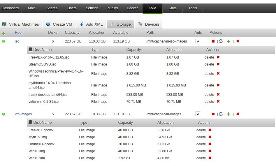

Do you have anything created under the storage tab?
Picture below is how my storage is organized - might not be the ideal scenario.
Also you need to create the img file before you can create a VM.
Thanks, that's the ticket.....figured it was something simple.

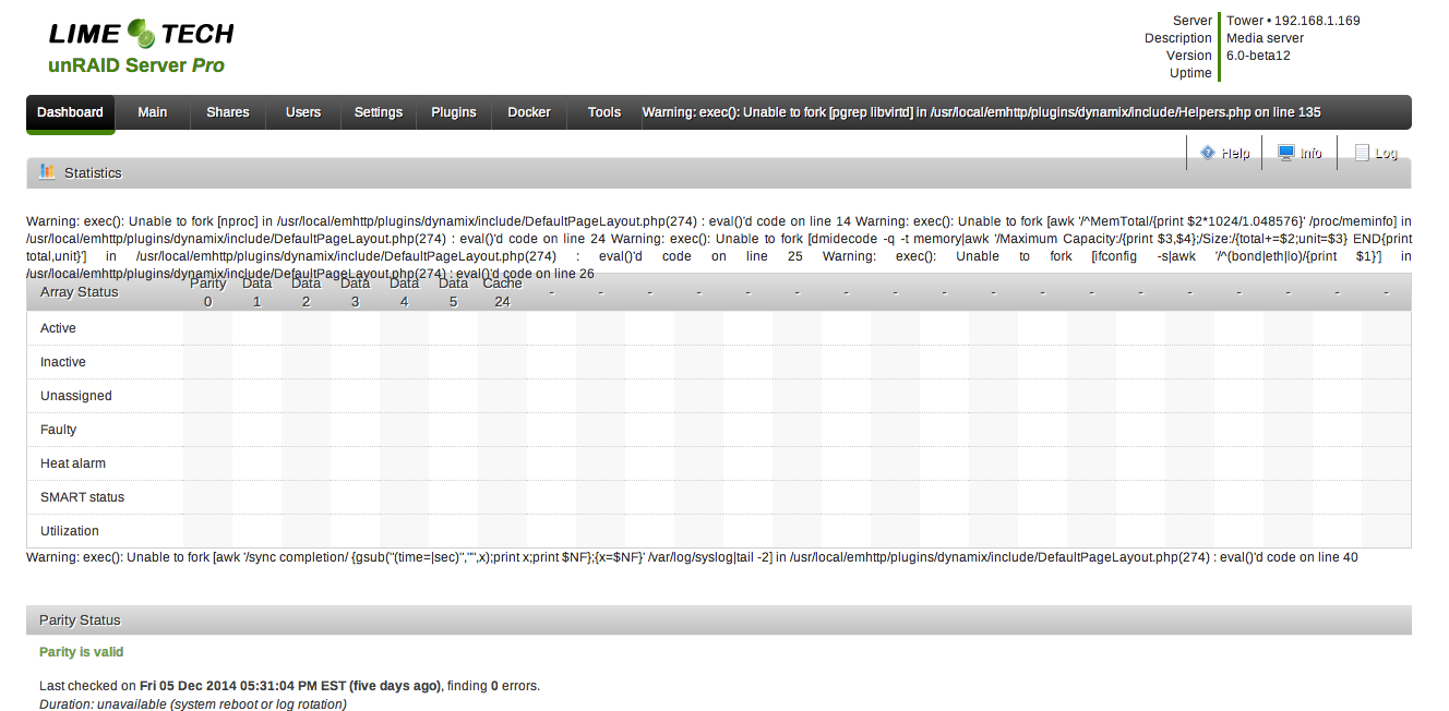

2. Stability - I find that the Win8.1 VM seems to crash fairly regularly and when it does it seems to effect the operation of the rest of the unRaid server. There have been a number of errors showing up regarding memory allocation in the dashboard window (see attachment). I am also attaching the syslog which shows similar errors. These errors only occur when the VM is operating or being suspended or shutdown. If I don't start the VM then the server runs error free.
Most of the time once the VM crashes I cannot restart it without rebooting the entire system. The server itself generally regains full operability without a reboot but this takes some time.
I have also noticed that SABnzbd threw out an error code while this was occuring
Error [Errno 12] Cannot allocate memory while running par2_repair on set 222982
This is not something that I have seen before and it definitely seems to be related.

1. Initially I started out with a .qcow2 disk that was 16GB now when I check it shows as slightly over 24GB. Is this because it is able to automatically resize?

You may want to post an issue under the unRAID version 6/defects section about the memory problem.  I haven't seen that before.  It may be when it's crashing the resources aren't being returned to the system or not returned right away. So if you can figure out the vm crashing part then the memory problem may go away. Restarting libvirt when it crashes may help so you don't have to restart the server.

Just tried restarting Libvirt from the plugin settings. Took about 5 minutes, during which time the unRaid GUI was unavailable. After Libvirt restarted all operability of the GUI came back. When I try restarting the VM it just comes up with error on the bottom of the page. Looks like it will need a full server restart.
Thinking back I may have  clicked on add snapshot so this might account for the increase in size. After checking Windows states 1.11 GB free of 15.6GB.

I will post the memory errors to the defects section and see in anyone has any insights.
