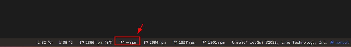

Sorry, I mean I have tow Fan, one is cpu heat sink. It working fine about auto rpm base on cpu temperture.
But my issue is the second Fan. it is my system fan . After boot to os. I try to get cpu temp high. it working fine about auto rpm base on cpu temperture.
And ........ after a while about 30mins or 1 hours, My system fan it wont auto speed rpm. and stock rpm. maybe is 2400 RPM.
BTW my system fan max speed rpm is 3000rpm.
And I need know. maybe is install this plugin effect my system fan auto speed rpm.
I remove the plugin. but it work the same issue...
BTW. I tring to using this plugin to setting my system fan auto rpm base on HDD temperture.
But it no work !!
So I try to uninstall this plugin. but issue still ....
Do you know how to uninstall about all about fan setting in terminal?

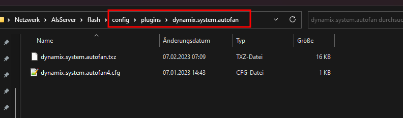

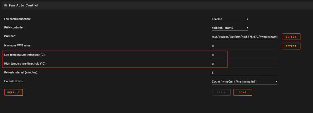

usually, you just uninstallt it
you can also remove from your USB drive this folder (which shouldbr necessarry)
after a reboot (uninstalling) all is gone ... and your BIOS Fan settings should do the job ... instead of the plugin.

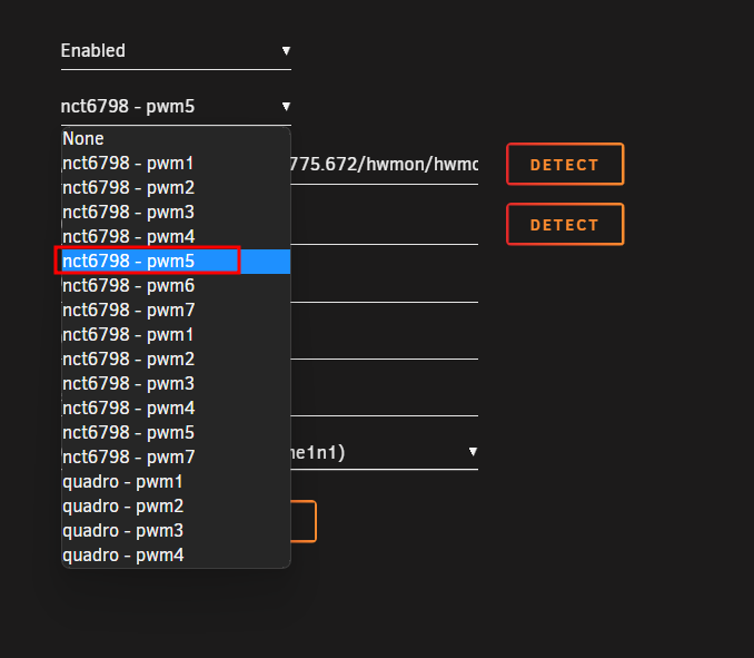

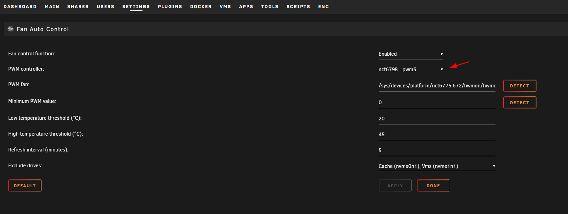

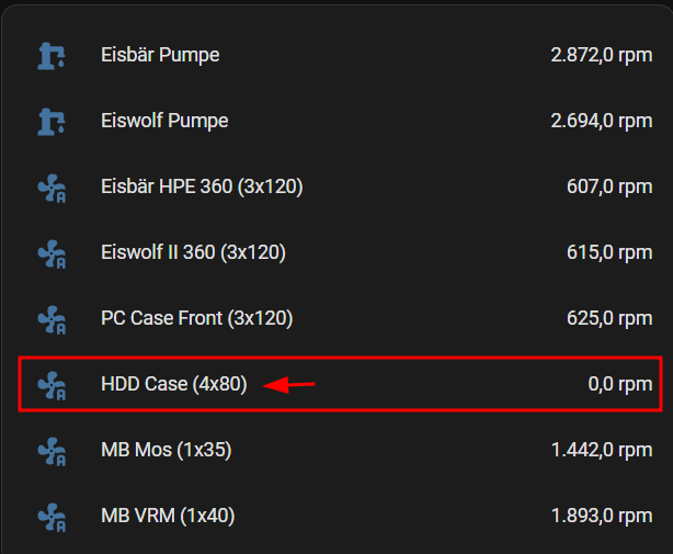

but in terms you want your fans controlled through unraid (HDD Fans !!!) rather look where may your configuration error is.
i also had to go through all possible fans and test them
you can pretty easy do so by run the detect and watch the fan speeds if they change so you know you really have the proper one selected, as sample in the buttom line (here currently OFF as HDD's are in spindown)
so, if i now change the Low / High Treehold's for testing its the correct sensor
and the syslog
Mar 15 12:29:38 AlsServer autofan: autofan process ID 1361 started, To terminate it, type: autofan -q -c /sys/devices/platform/nct6775.672/hwmon/hwmon4/pwm5 -f /sys/devices/platform/nct6775.672/hwmon/hwmon4/fan3_input
Mar 15 12:29:38 AlsServer autofan: autofan excluding drives nvme0n1,nvme1n1 from max temp calculations
so, its working ;)
i went through all my controllers to figure it ... and i have some ...
in the end, alot of trial & error in the beginning, but then its working flawlessly ...

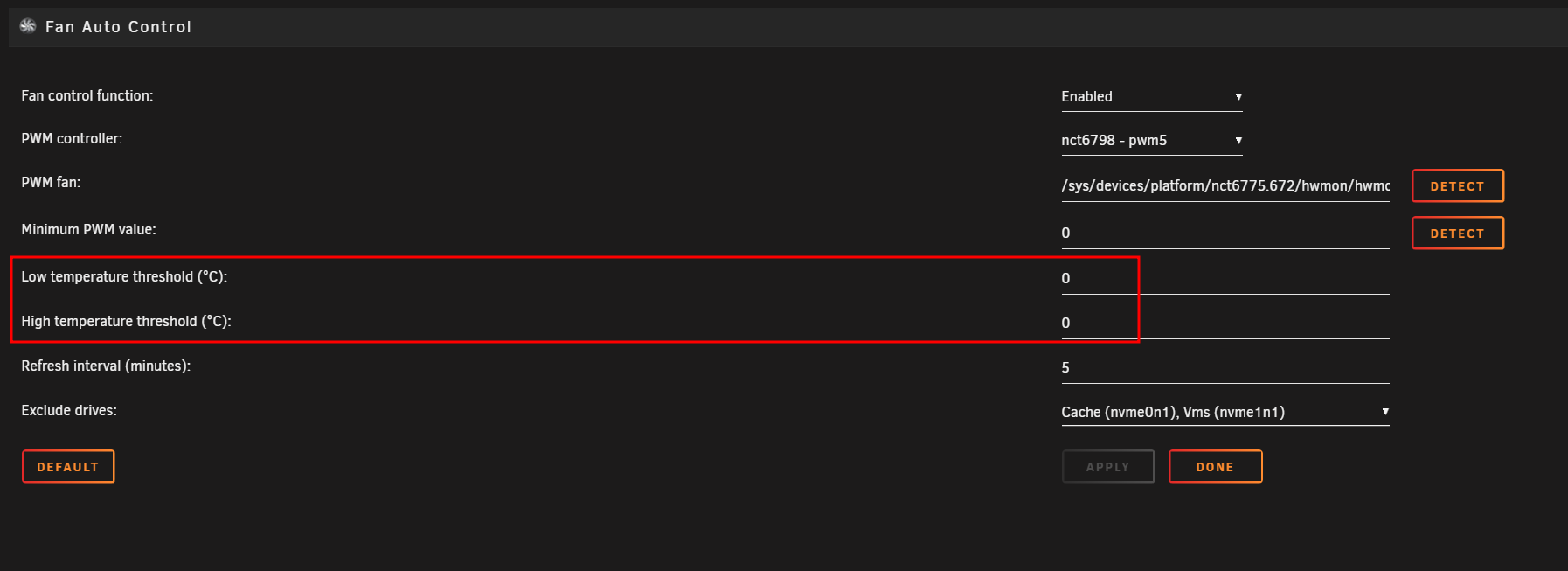

Dear Sir,
Thanks for your reply. I just check my flash USB, the folder directory no have that two config(txz、cfg)
I think it already delete by before.
I need check this working fine . after that at all , I will using your mothed try to base on HDD temperture
but I got a question. You said had to go through all possible fans and test them.
including CPU FAN? is it possible just setting some fans not all fans to base on hdd temperture?
I try to figure out my question. is here to setting which I wont make a group fans to base on hdd temperture?
Thanks again.
Edited by Bcy
exactly, when you uninstalled it they shoul dbe gone, as mentioned ... uninstalling is enough, this was just "in case" ...
CPU Fan ... like mentioned, sure you could include your CPU Fan, but your triggers are ONLY HDD Temps ... and thats for sure not what you want to achieve ... so keep the CPU Fan "out" and let this be controlled by your BIOS Fan curve.
some Fans ... sure, thats how its supposed to be ... fan1, fan2, ... different rules ... you set them individually while they reside on individual sockets on your mainboard, here in my sample i have 4 fans which are using a split cable on 1 controller, so i only need 1 socket on the mainboard and 1 rule, if they all would set seperate on the mainboard i would have to set 4 rules ...
How to set fan rules .......

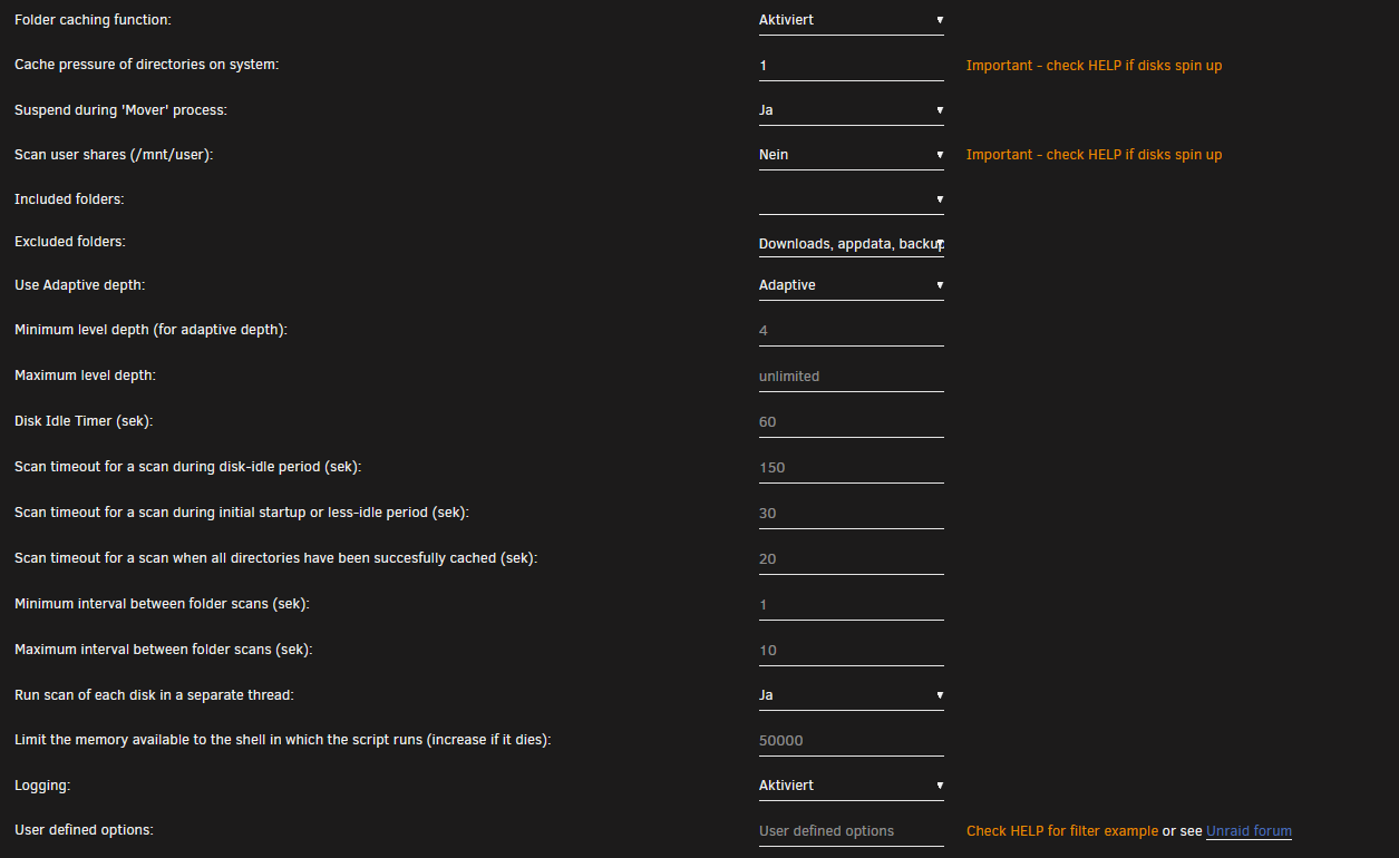

I'm not sure if my expectations are wrong as how cache directories is working. But, as I said, in the past I had the feeling that it is working as I expect it.
Above are my settings for the plugin. While all drives are spun down I navigate to any directory on any share. After a depth of 2 to 3 directories I can see that the drive is spinning up. After 20 minutes the drive is spun down again and I wait say another 10 minutes and go to the exact same location and at the drive is spun up again.
I though I've read somewhere that while the drive is spun up, I navigate through directories and while I navigate these paths/files are added to the cache. So file locatoins that I never opened are not added to the cache unless I go there. Is that wrong?
Where can I find the HELP docs for the Cache Dirs plugin? There are several settings that say "Important - check HELP if disks spin up", but I can't find where that document might be. At the bottom there's a link to a forum topic, but it's a dead link.
Ultimately, what I hope to accomplish is to allow the server to respond very quickly when directory information is requested, but also to take that as a hint that access to the underlying files is likely to be coming soon, so start spinning up the related drives now.
