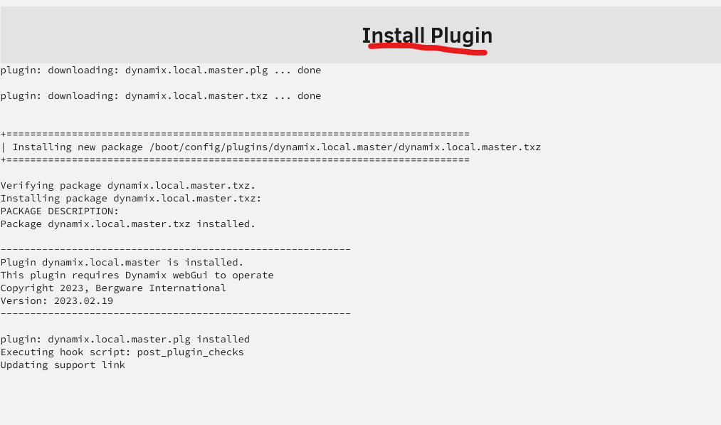

I uninstalled it and used 'APPS' to reinstall as follows:

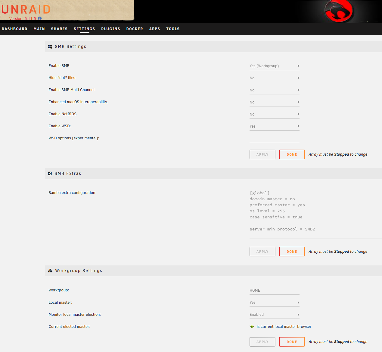

Still the same.  I do have the following in my smb-extras.conf as a global parameter:
server min protocol = SMB2
Previous experimentation has shown (to my satisfaction) that once SMBv1 is disabled the name of the Local Master can not be resolved by the Local Master plugin.  I have googled this problem (as a Windows utility --- LANscanner v2.02 - ScottiesTech.Info does not resolve it either once SMBv1 is disabled) and I have found no one else apparently has an solution to the question of how to identify which SMB server is the Local Master.

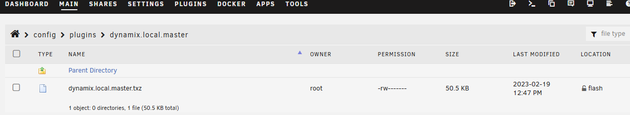

EDIT:   I just checked and the file was updated:
Edited by Frank1940

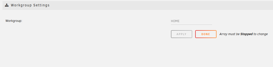

@Frank1940 thanks for your explanation, I see what is happening.
The newer version checks the activation of netBIOS and hides settings when netBIOS is not active. I added WSD as an alternative.
Please update to version 2023.02.19a

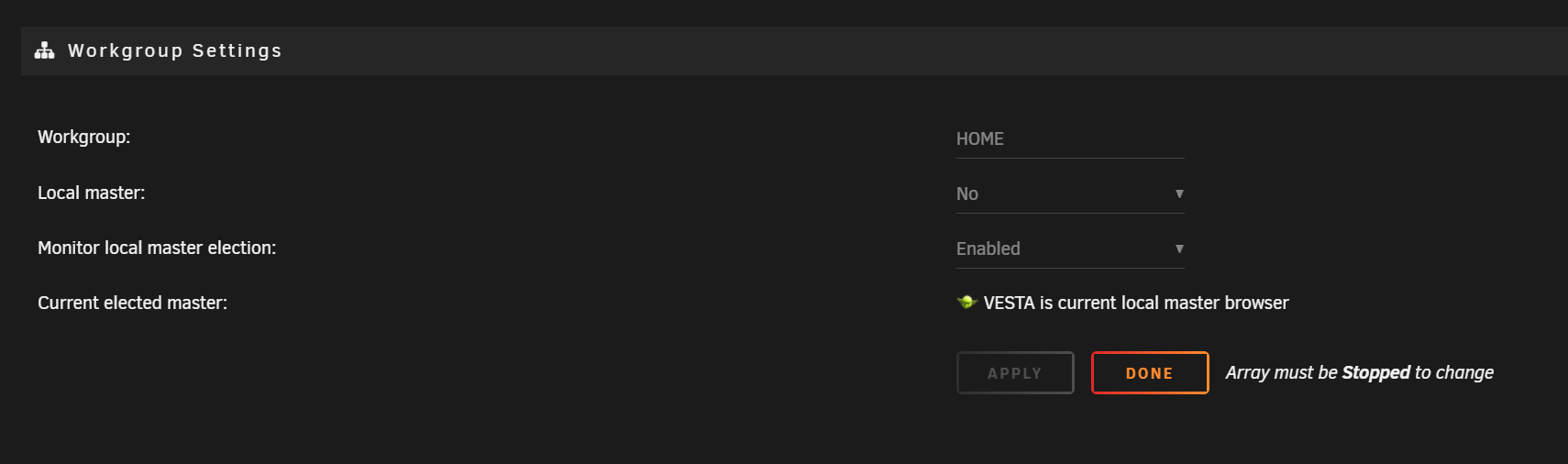

Done.  However, I can tell you that it does not provide the server name of the Local Master.  Here is the Workgroup settings of my 'Media' server which is (most likely) the Local Master:
Notice that the 'Name' of the Local Master does not appear in either the upper left banner or under Workgroup settings-- only the Yoda head.
For completeness, here is the Workgroup Settings of my 'Test Bed' server )which should never be the Local Master):
I suspect that this is because I have turned off SMBv1 completely.  I also seem to recall that the parameter server min protocol = SMB2  actually selects a fairly late version of SMBv2 which locks out all vestiges of SMBv1.
Have a look into whether you can, at least, determine if an Unraid server is the Local Master and use that to flag that server properly.  If you can't find a way to do this, please consider amending the Help text to alert the user to situation and the reason why.
I, personally, don't care if a server which can never become a Local Master 'knows' which server is the Local Master.  By the same token, I would like any server which I expect to be the Local Master and that server is not the Local Master be aware of that fact when I look at that server's GUI.
