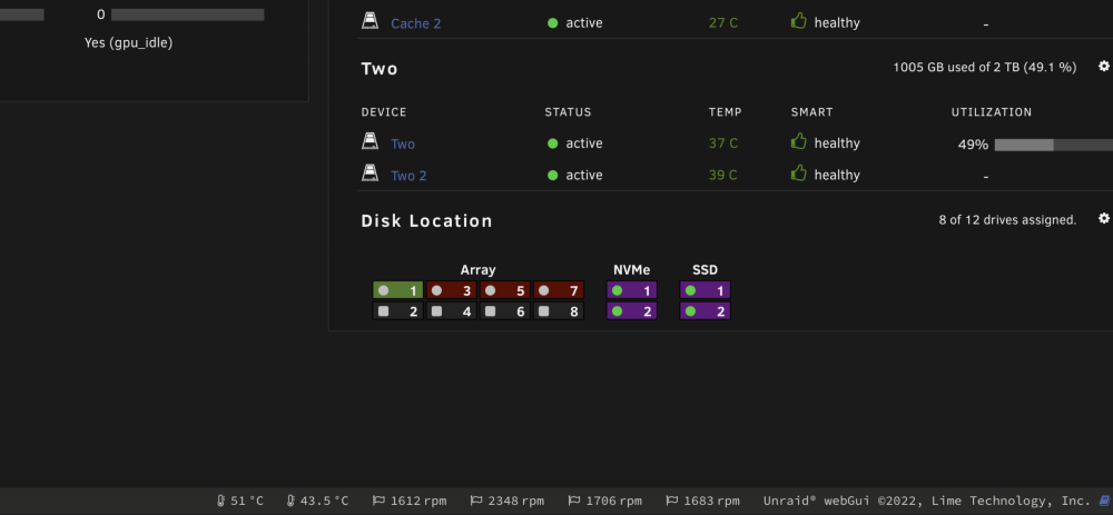

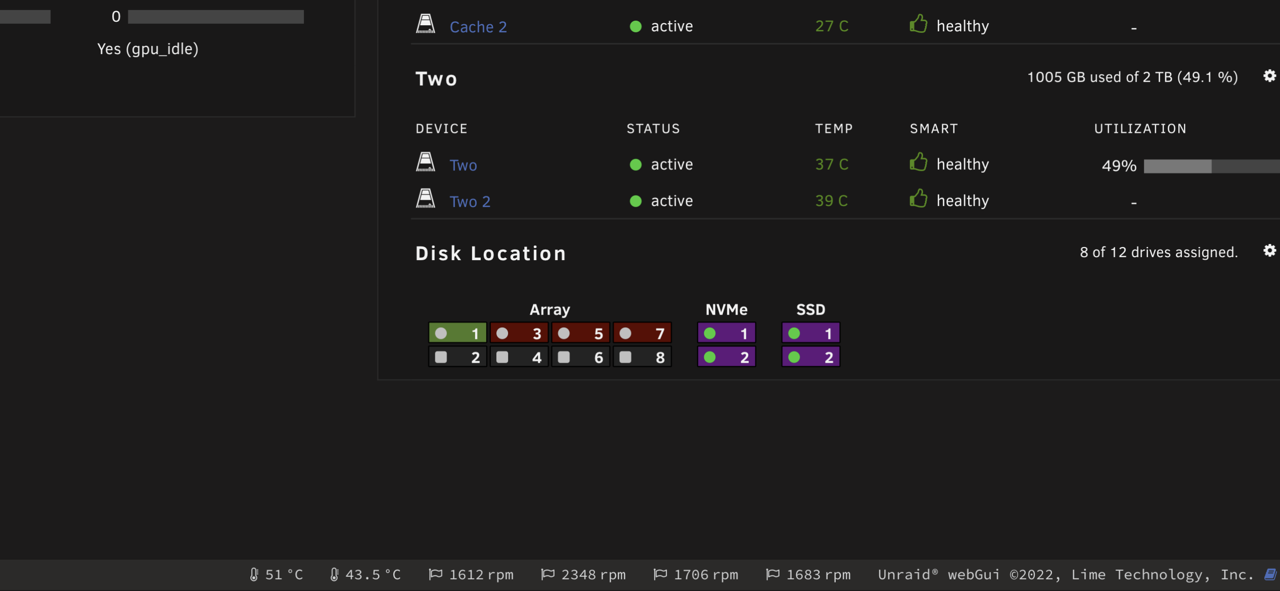

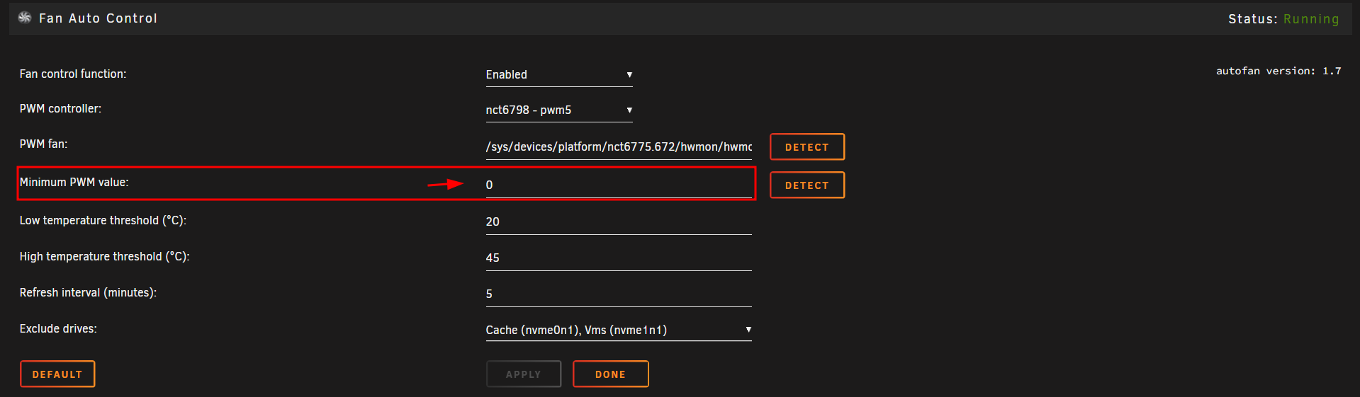

Question about Dynamix System Autofan: Is there a way to fully disable turn off a FAN?
I have a set of Fans to cool the HDDs. They also indirectly help to cool other components.
When the HDDs sleep, the auto fan turns the FANs off and I would like instead to just slow them down instead of turning them off.
may take a closer look at the settings of your fan
this should be set to "something" which should be then the lowest run speed ...

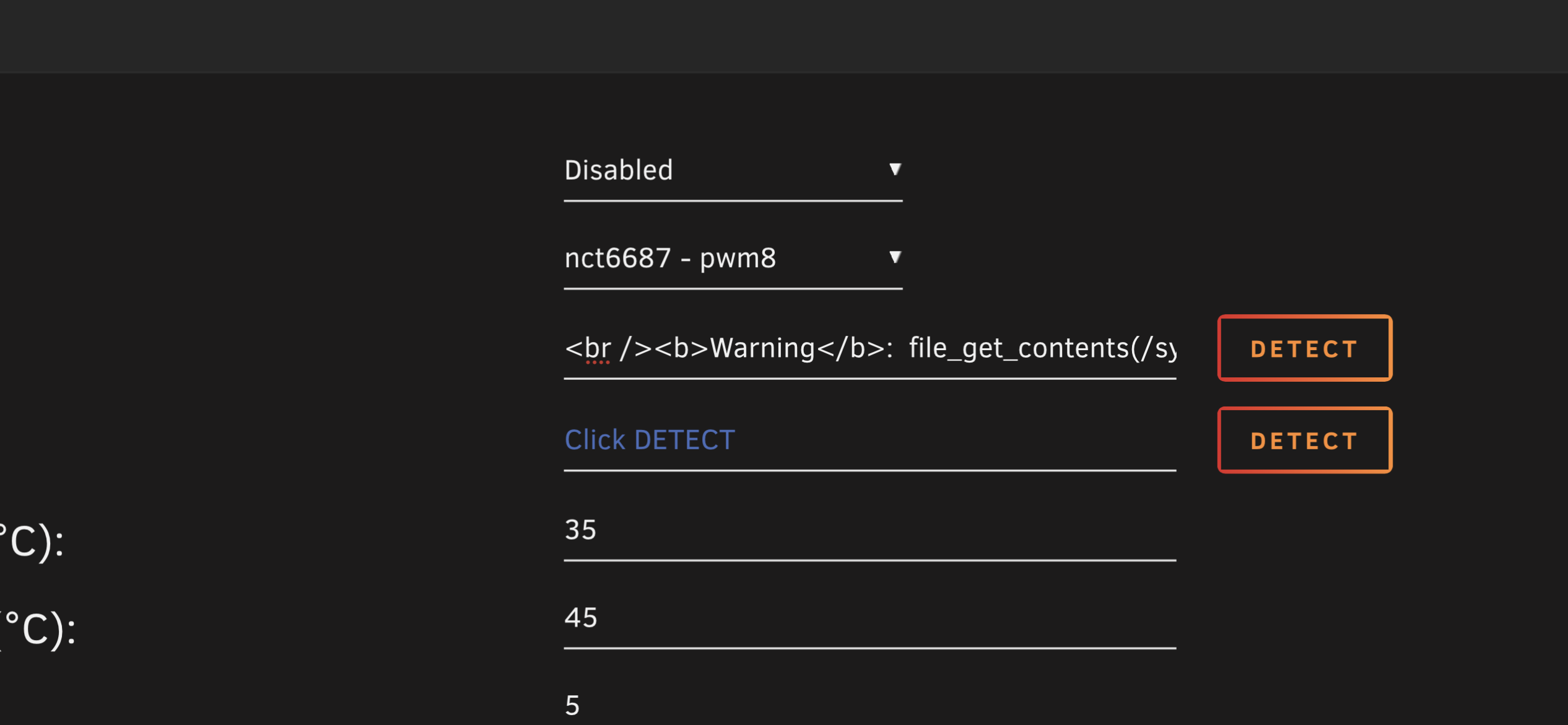

Hi just completed a new build using a MSI B760 motherboard.
I can't seem to get Auto Fan and System Temps to detect. According to nerd tools my perl packages are up to date. Do I need install anything in addition for this to be detected?
Sent from my SM-G991B using Tapatalk

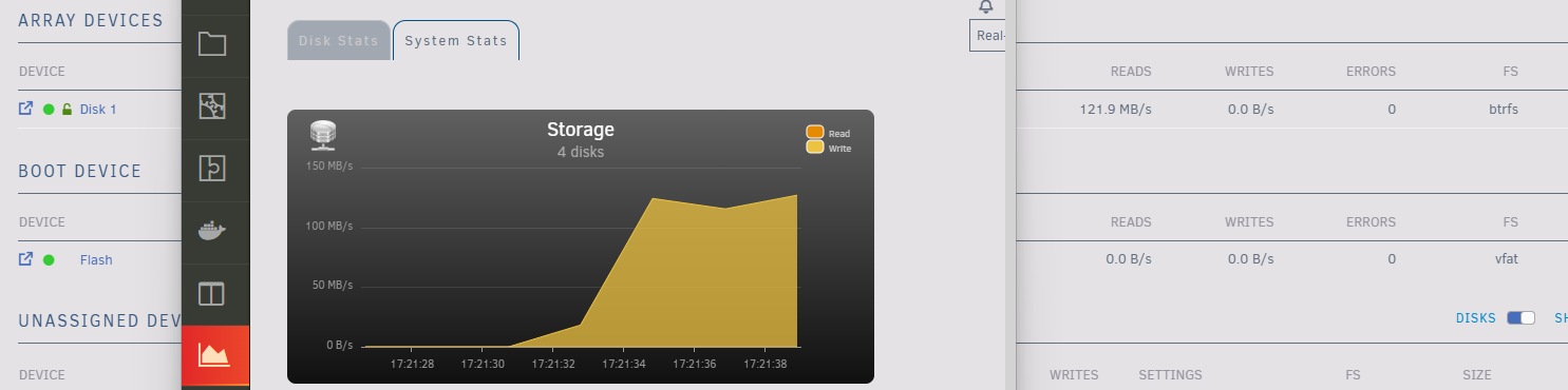

System stats plugin have swap read / write reading in 6.12rc6 & 7, have try server reboot. But no problem on 6.11.5
Below are reading on array disk, but STATS show it is writing, same on UD disk.
Edited by Vr2Io

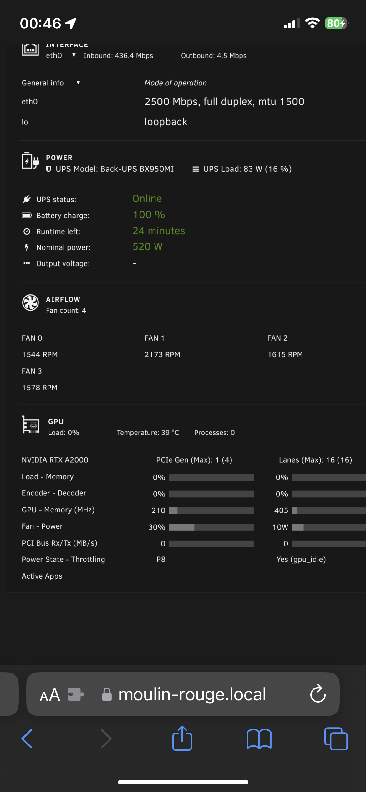

Auto fan plug-in .. error when detecting.
but fan temps & rpm show up fine in the other temp plug-in.
IMG_3912.thumb.png.764e932ec90e943e9b51ffcd7c594011.pngIMG_3914.thumb.png.44913ad9fbdcf602f3a1d193edd1aa8f.png
any idea how to fix?
currently fan rpm controller by bios
motherboard is MSI b560 mortar wifi
Edited by dopeytree

Probably a stupid question, but I'm trying to get auto fan configured. The dropdown in the settings screen identifies 3 fan controllers on my system - how do I know which one to specify for auto fan to take control of?

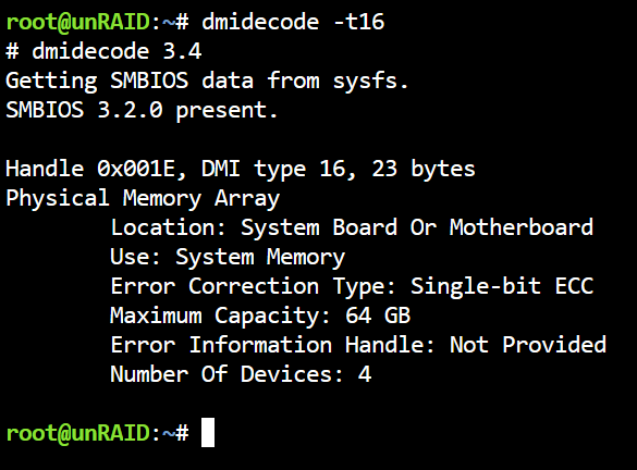

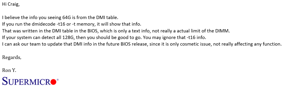

Wondering about System Info.  It reports the maximum capacity for RAM on my Supermicro X11SCZ-F as 64GB.  When the MB was originally released this was true, but for many years it's supported 128GB after firmware upgrade.  Is this something that can be fixed in System Info, or is this what my MB is reporting to System Info?
I just jumped from 64GB to 128GB in my server.  System Info still says max capacity 64GB and in the System Overview tab I now get:
Memory:	128 GiB DDR4 Single-bit ECC (max. installable capacity 128 GiB*)
I think the * is new and probably there because in the Memory Summary tab we have:
Maximum Capacity:	64 GB
Not a big deal, just wondering if it might be fixed?
Thanks for all the great apps and dockers!
The capacity is as reported by your BIOS, only a fix in the BIOS of your motherboard can resolve it.
As I presumed, just thought I'd ask.  I doubt SuperMicro will address this as my MB is nearing EOL and they have had years to make the change.  Perhaps the 64GB max capacity is stored somewhere their BIOS updates can't reach.  However, they do have updates occasionally that require jumper changes so factory sections can be reprogrammed.  I'll send them a note and see if maybe they will fix it.
Thank you again for all your outstanding work!  I use sooo many of your dockers and plugins.
EDIT: Sent Supermicro a message.
I hope they fix their DMI table info on the next firmware...  maybe I'm a little too detail oriented 🤪

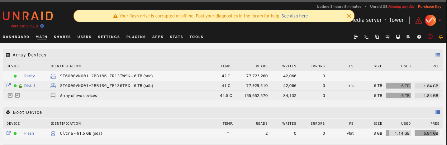

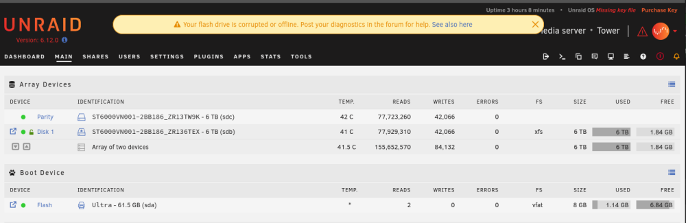

Anybody using 6.12 or 6.12.1 with S3 sleep plugin ? I wanted to give this plugin a try on my NAS on my QNAP.
Seems this hardware support S3 :
dmesg : [    0.704022] ACPI: PM: (supports S0 S3 S5)
I used a basic S3 configuration and I can wake up my device -  I installed  this program : https://github.com/sabhiram/go-wol
to send WOL packet. But only ping is working (the Web interface / and i guess other processes) when server wakes up.
I had unfortunately no logs after reboot. Issue occured 3 times I tried to use sleep.
I gave it another try  - after changing configuration to keep logs on USB key, and got can see the following message :
Looking at logs I see :
Jun 19 15:50:13 Tower kernel: usb 2-1: USB disconnect, device number 2
Jun 19 15:50:13 Tower kernel: device offline error, dev sda, sector 5802129 op 0x1:(WRITE) flags 0x0 phys_seg 7 prio class 2
Jun 19 15:50:13 Tower kernel: Buffer I/O error on dev sda2, logical block 5800081, lost async page write
Jun 19 15:50:13 Tower kernel: Buffer I/O error on dev sda2, logical block 5800082, lost async page write
Jun 19 15:50:13 Tower kernel: Buffer I/O error on dev sda2, logical block 5800083, lost async page write
Jun 19 15:50:13 Tower kernel: Buffer I/O error on dev sda2, logical block 5800084, lost async page write
Jun 19 15:50:13 Tower kernel: Buffer I/O error on dev sda2, logical block 5800085, lost async page write
Jun 19 15:50:13 Tower kernel: Buffer I/O error on dev sda2, logical block 5800086, lost async page write
Jun 19 15:50:13 Tower kernel: Buffer I/O error on dev sda2, logical block 5800087, lost async page write
Jun 19 15:50:13 Tower kernel: device offline error, dev sda, sector 5802456 op 0x1:(WRITE) flags 0x0 phys_seg 1 prio class 2
Jun 19 15:50:13 Tower kernel: device offline error, dev sda, sector 2049 op 0x1:(WRITE) flags 0x100000 phys_seg 1 prio class 2
Jun 19 15:50:13 Tower kernel: Buffer I/O error on dev sda2, logical block 1, lost async page write
Jun 19 15:50:13 Tower kernel: device offline error, dev sda, sector 7714 op 0x1:(WRITE) flags 0x100000 phys_seg 1 prio class 2
Jun 19 15:50:13 Tower kernel: Buffer I/O error on dev sda2, logical block 5666, lost async page write
Jun 19 15:50:13 Tower kernel: device offline error, dev sda, sector 22946 op 0x1:(WRITE) flags 0x100000 phys_seg 1 prio class 2
Jun 19 15:50:13 Tower kernel: Buffer I/O error on dev sda2, logical block 20898, lost async page write
Jun 19 15:50:13 Tower kernel: device offline error, dev sda, sector 160848 op 0x1:(WRITE) flags 0x100000 phys_seg 1 prio class 2
Jun 19 15:50:13 Tower kernel: device offline error, dev sda, sector 160848 op 0x0:(READ) flags 0x0 phys_seg 1 prio class 2
Jun 19 15:50:13 Tower kernel: device offline error, dev sda, sector 5802456 op 0x1:(WRITE) flags 0x800 phys_seg 1 prio class 2
Jun 19 15:50:13 Tower kernel: FAT-fs (sda2): unable to read inode block for updating (i_pos 2540807)
My USB key is no faulty :  there is an Unraid 6.12 (kernel 6.1.x)  + plugin combination  issue ?
Seems like USB disconnect/connect issue . I didn't have any issue with my key previously.
My key still appears through lsusb : Bus 002 Device 004: ID 0781:558a SanDisk Corp. Ultra but there is no /dev/sda after suspend  :
root@Tower:~# fdisk  -l /dev/sda
fdisk: cannot open /dev/sda: No such file or directory
Logs I gathered :
[ 2150.829940] PM: suspend exit
[ 2150.886828] sda: detected capacity change from 120176640 to 0
[ 2151.035860] usb 2-1: USB disconnect, device number 2
[ 2151.037738] device offline error, dev sda, sector 6693673 op 0x1:(WRITE) flags 0x0 phys_seg 7 prio class 2
I tried the following  USB with no success :
echo -1 > /sys/module/usbcore/parameters/autosuspend
and also adding  usbcore.autosuspend=-1 as boot option.
I don't know how to solve this USB key & sleep issue.
