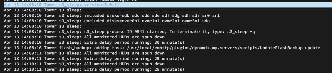

For me the s3 sleep plugin is still broken. (Unraid 6.11.5)
I currently use the Fork from Bjorn.
https://blog.sengotta.net/dynamix-s3-sleep-script-fork-fuer-unraid/
Main Problem on my side is, the TCP activity counter in this current version is not working at all.
Second Problem is, the "outside Array" Feature still wont see my nvmes. It was working when it was included in the updates the first time, since then, not anymore.
I Backuped the Bjorn Plugin just in case because the main forum (Kodinerds.net) from this guy seems to be offline since weeks and i was able to get it from is github.
tower-diagnostics-20230413-1423.zip
Edited by Kasjo
add diagnostics

Apr 14 14:31:21 Horus kernel: sd 7:0:2:0: task abort: SUCCESS scmd(0x0000000080da7ace)
Apr 14 14:31:21 Horus kernel: sd 7:0:2:0: Power-on or device reset occurred
Apr 14 14:31:21 Horus kernel: sd 7:0:2:0: [sdf] Synchronize Cache(10) failed: Result: hostbyte=0x00 driverbyte=DRIVER_OK
Apr 14 14:31:21 Horus kernel: sd 7:0:2:0: [sdf] Sense Key : 0x6 [current]
Apr 14 14:31:21 Horus kernel: sd 7:0:2:0: [sdf] ASC=0x29 ASCQ=0x0
Apr 14 14:31:21 Horus kernel: sd 7:0:2:0: PM: dpm_run_callback(): scsi_bus_suspend+0x0/0x11 returns -5
Apr 14 14:31:21 Horus kernel: sd 7:0:2:0: PM: failed to suspend async: error -5
Apr 14 14:31:21 Horus kernel: PM: Some devices failed to suspend, or early wake event detected
Apr 14 14:31:21 Horus kernel: OOM killer enabled.
Apr 14 14:31:21 Horus kernel: Restarting tasks ... done.
Apr 14 14:31:21 Horus kernel: random: crng reseeded on system resumption
Apr 14 14:31:21 Horus kernel: video LNXVIDEO:00: Restoring backlight state
Apr 14 14:31:21 Horus kernel: PM: suspend exit
Apr 14 14:31:21 Horus s3_sleep: Wake-up from sleep mode
I can't put the server to sleep anymore...
So, how can i get back the older "working" version of this plugin?
I think it was 3.0.8 or so...
How did you fix the problem with the NVMe's?
I have the same issue...
Edited by Zonediver
there is No fix. Instead use a older version without this feature. It need to be fixed on the other side.
