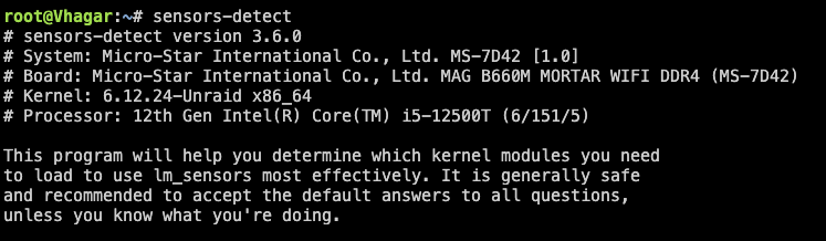

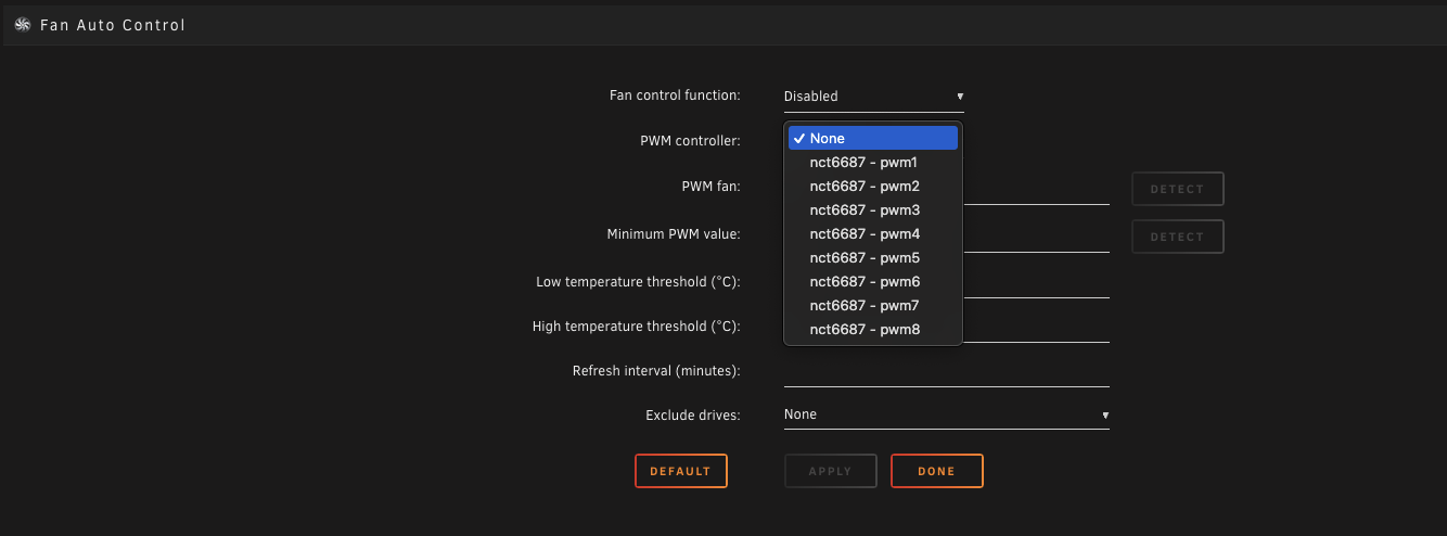

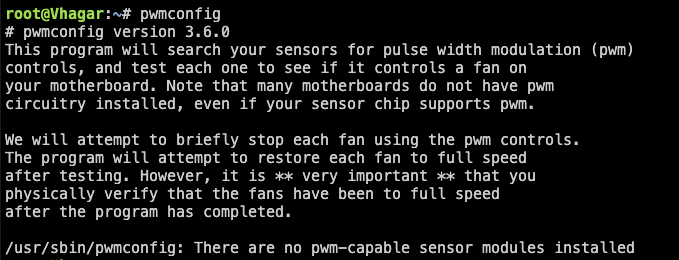

i've already run it, it was to show that no pwm fan was detected.

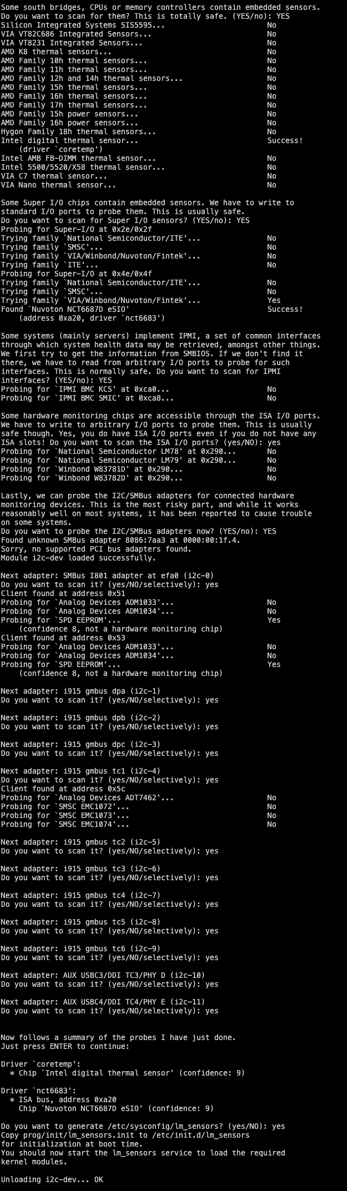

but i've run sensors-detect again, here's the result
your answer is right there. at the bottom it tells you the drivers you need to load.
nct6687
coretemp
nct6687
coretemp
Thanks for your feedback, I've installed the nct6687 driver and now I have my fans which seem to come up in the plugin, I'll identify them.
I couldn't find the coretemp plugin though, I don't know if it's necessary.

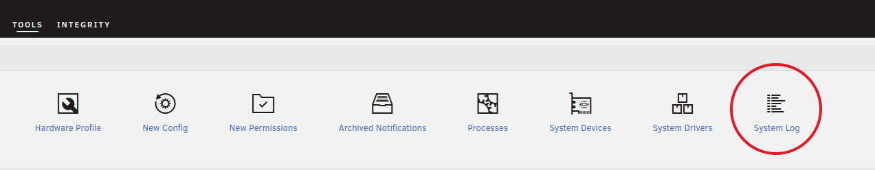

Or on command line you can filter for logs like e.g.:
less /var/log/syslog.2 | grep autofan

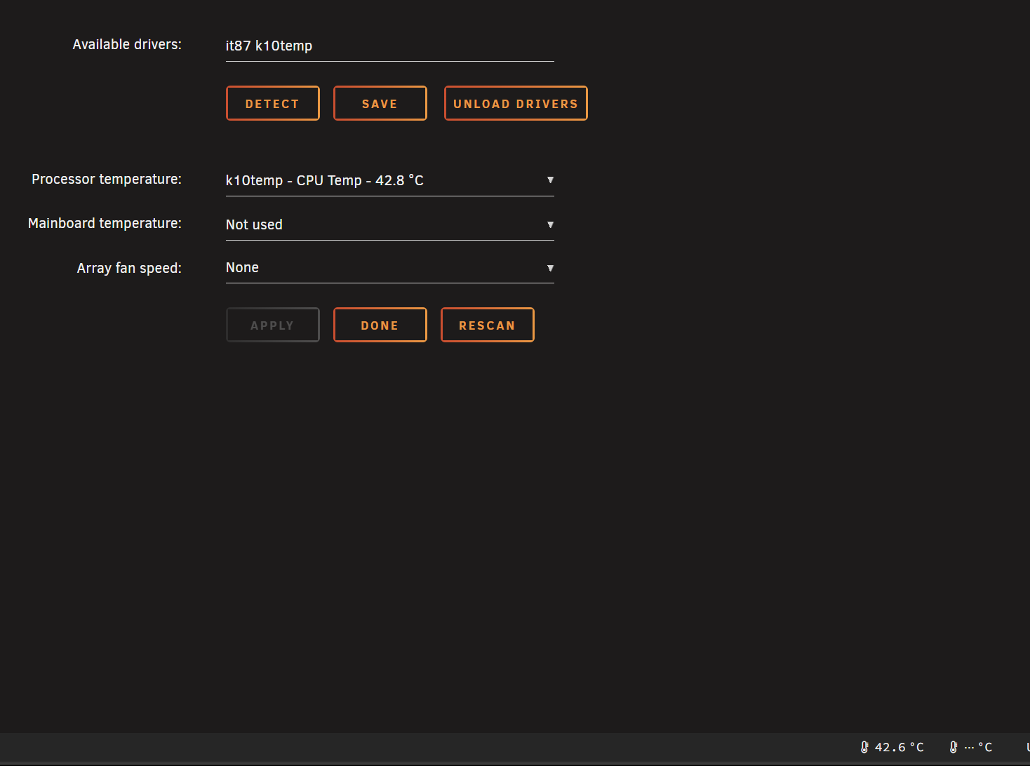

According to the help tooltip, it says if you set one to 'not used' it should hide that on the toolbar. However as you can see, it still displays it, just with a "--" so is there some way to remove that?

If anyone got the same issue, I found the driver, it's called IT87 Driver plugin.
