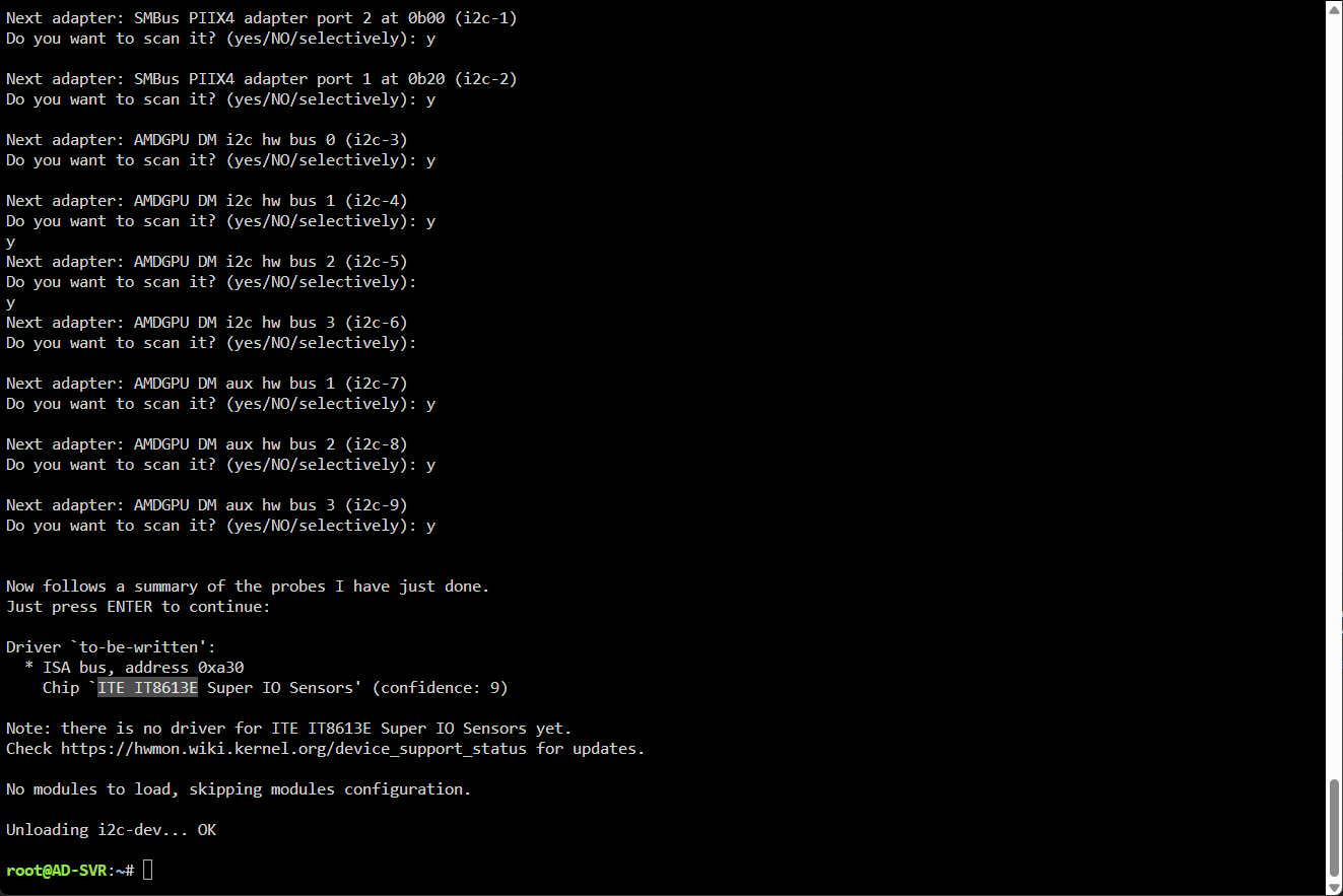

System Temp can't detect, driver is missing and couldn't find it. ITE IT8613E
I'm using AOOSTAR WTR PRO AMD Ryzen 7 5825u 4 Bay Nas Mini PC
any idea?
any idea?
your answer is right here:
Driver
"to-be-written':
* ISA bus, address 0xa30
Chip 'ITE IT8613E Super IO Sensors' (confidence: 9)
Note: there is no driver for ITE IT8613E Super IO Sensors yet.
Check https://hwmon.wiki.kernel.org/device_support_status for updates.

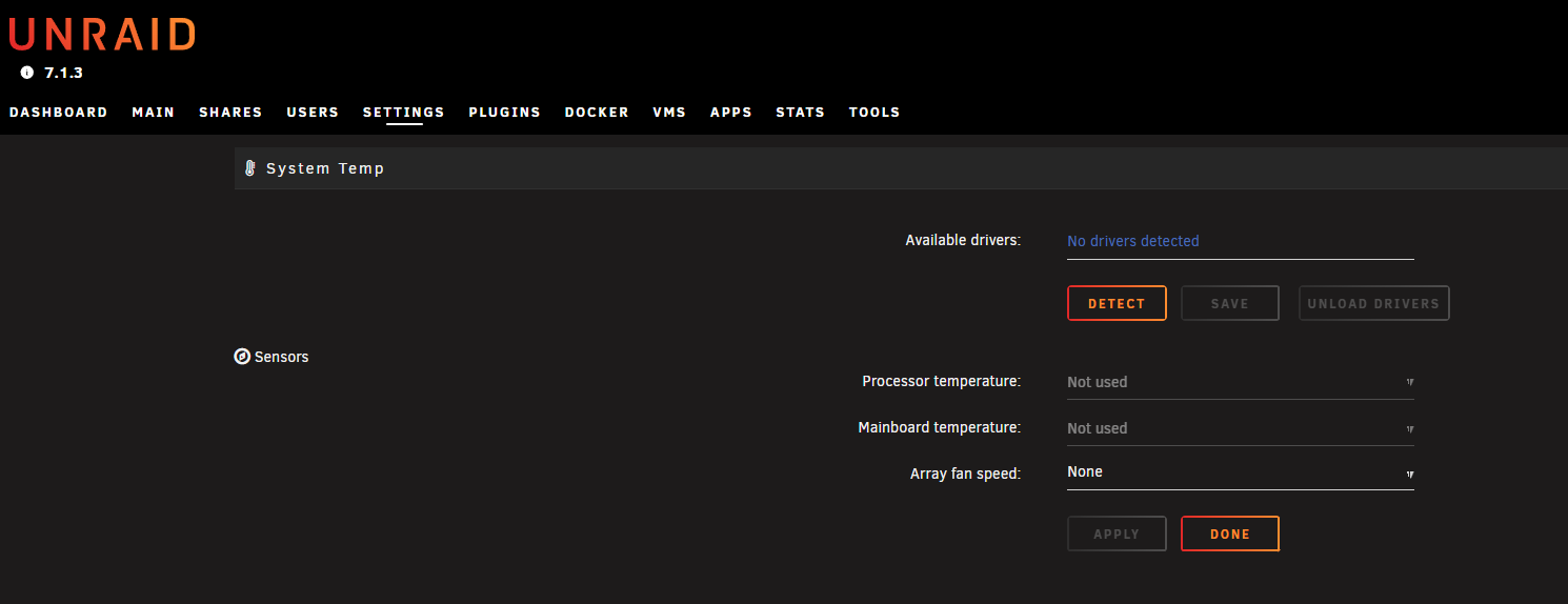

Hi All. I noticed that for the Dynamix System Temp plugin it requires Perl. I also saw a note about it being needed for V6 and below? Maybe?
I do not see a package or plugin for PERL. Is this what everyone is noticing? Are we installing temporarily via CLI?
Thanks for your input.
Been automatically installed by the plugin for quite a while, don't need to care about it.

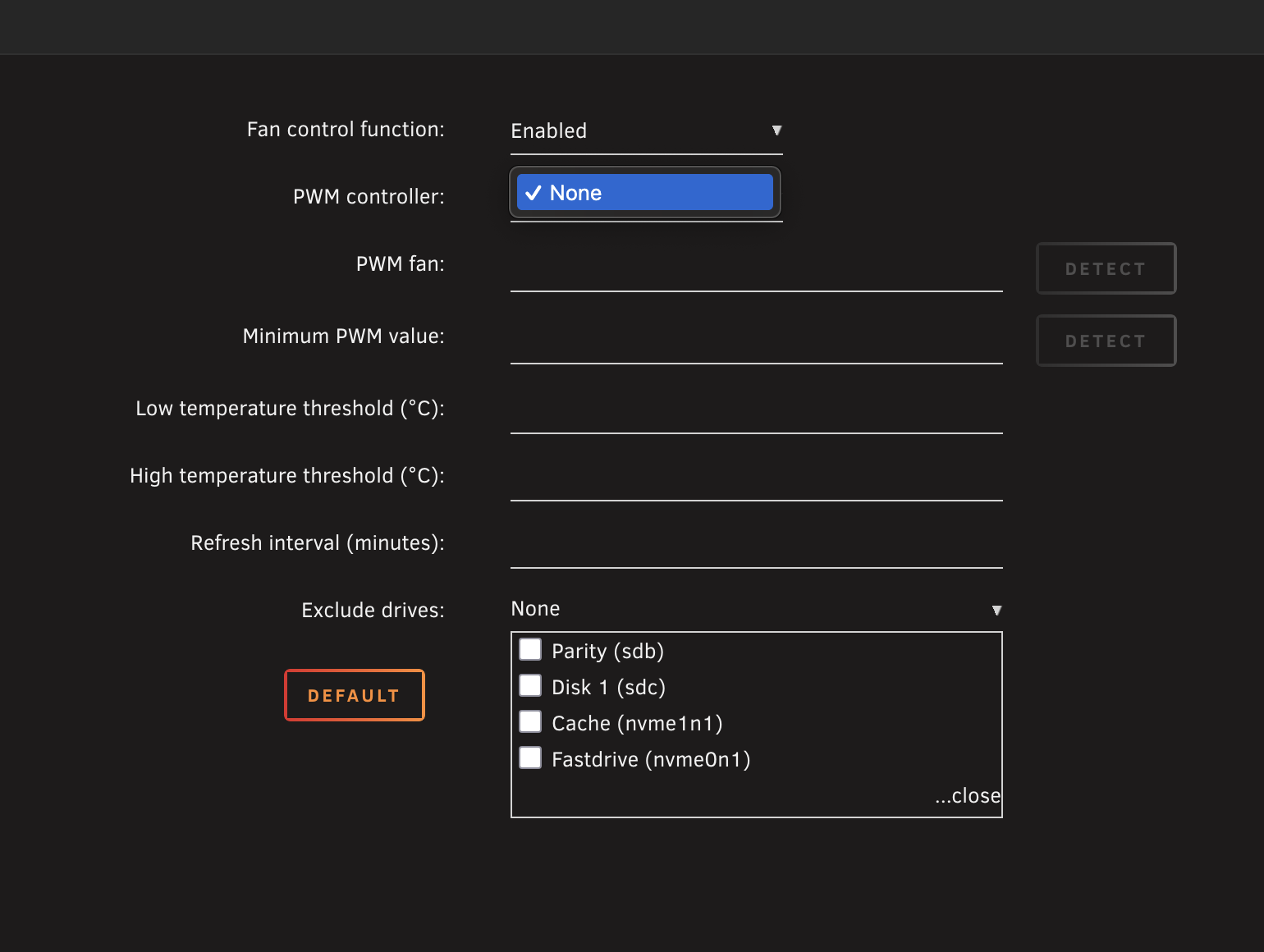

Hi guys, I installed the autofan plugin but it doesn't show any PWM controller, my motherboard is: Asus B550-XE
Is this normal?
Thanks!
i had to install the driver package to see my pwms, but ive got some and i dont know how to control all of them instead of just one
Check for the ITE IT87 Driver - maybe that applies to your mainboard, too

Hello,
I just installed the plugin but no PWM controller is detected.
In my BIOS, I have set both the CPU FAN and SYS_FAN2 to PWM mode. SYS_FAN2 is connected to three PWM fans.
However, nothing is being detected by the plugin.
Any ideas or suggestions would be much appreciated!
Thank you!

Have you run sensors-detect?
Edited by spl147
Yes, I just ran it again, selecting YES for each prompt and restarted Unraid afterward
However, I still don't have any controllers detected
Install the ITE IT87 Driver if applicable for your board
