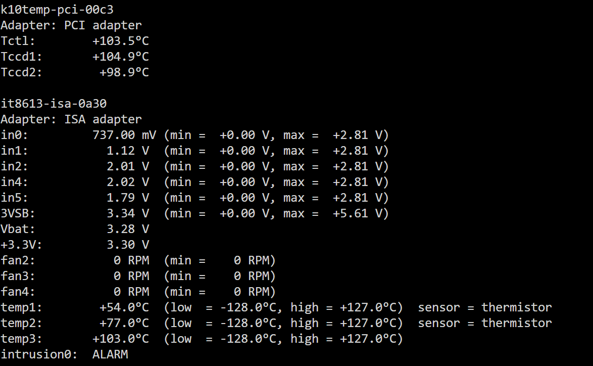

Hi there,
I'm running Unraid 7.0.0 on a Ryzen 5 4600G. When I first installed, I installed Dynamic System Temperature and it detected drivers automatically. I could see CPU and mainboard temperatures, among others.
At some point, after a restart or two, all temperatures have disappeared. Now, I go into the plugin, click "detect," and it returns no results.
I can run sensors-detect, but that returns the same result.
I have reseated the CPU fan header to no avail. Temperatures are being reported to BIOS just fine. I do some heavy workloads and have recently moved to a new case and cooling setup, so really need to know what my temperatures are looking like.
The problem has persisted across Unraid 7.0.0 and 7.0.1.

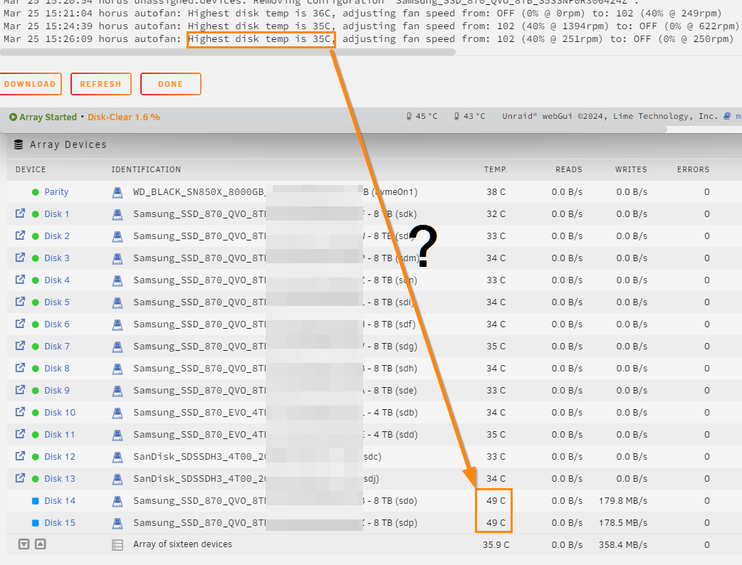

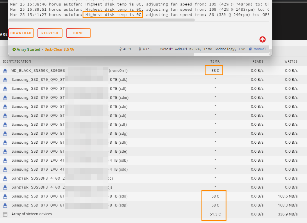

The Auto Fan Control plugin does not recognize the correct maximum temperature?!
EDIT: Ok, this is really bad:

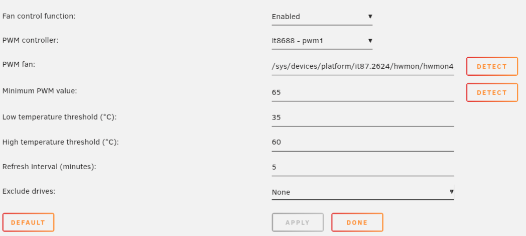

post your settings page
After disable and enable the first sensor it works as expected again. Settings:
I would say the plugin does not recognize hot swapped disks?!

Your refresh interval is way to long, 5 mins between checks could overheat a drive, especially during a parity check. 1 min. max
I already tested this. No problem so far as those QVO SSDs have a low power consumption and in addition the default airflow keeps them already cool enough. But I repeat the test next week as then 6 additional SSDs will be connected since the last test.
