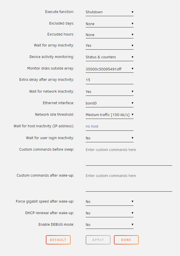

The S3 sleep plugin keeps shutting down my server backup while there is a backup running and the parity drive is active.
What am I doing wrong?
Settings:
Hey, first of all thank you for your awesome plugins. Do you know when we will get systems temperature on X670e mobos. Thank you in advance. I am on Unraid 7.0.0 beta 4
