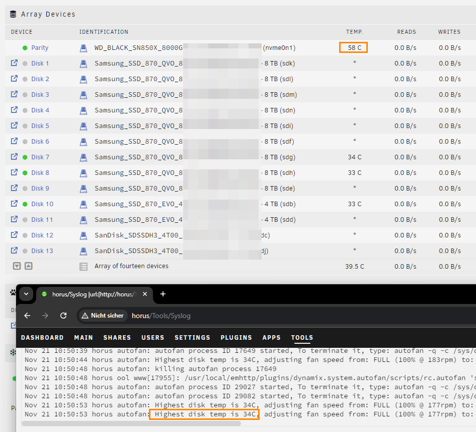

- it seems not to monitor the parity temp:

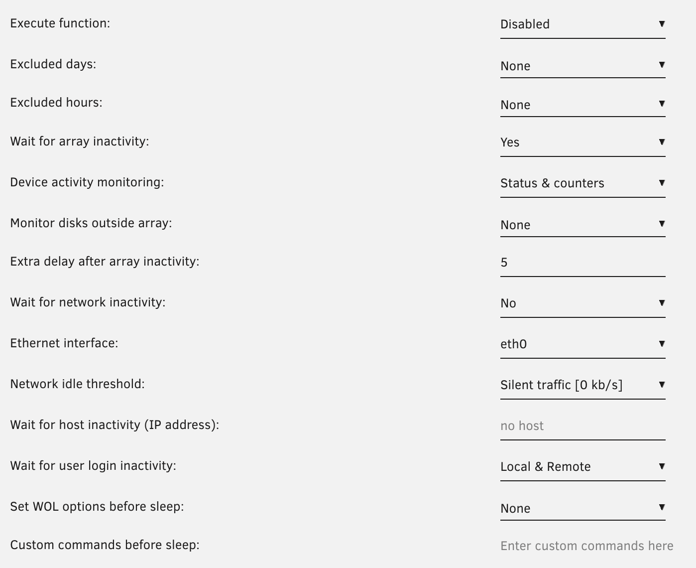

I am currently running a trial for a 3rd backup option for my data. An important part of this setup is that it is able to sleep between backups (power is very expensive at the location), so I use the s3sleep.
When using the plugin, the machine will go to s3 sleep, even when parity calculations are under way. Is this intended behaviour?
Unraid: 6.12.14 2024-11-26
S3sleep: 2023.03.23
S3sleep: 2023.03.23
There's a bug in the current detection mechanism. You need to put your disks in the "Monitor disks outside array" tab.
The activity checker is broken and the dev is MIA.  I don't think the "monitor disks outside array" setting fixes it.  But try and see.
If it doesn't, someone has created a fork of the sleep add on that should work.  I haven't tested it.

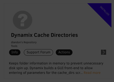

When running "fix common problems" it mentioned I should switch to a fork of the Cache directories plugin due compatibility issues with current unRAID.  Is it in the store?  I didn't see it.

Ok so it was that plugin.  I thought the one there was literally the one I just removed since the name didn't change
https://forums.unraid.net/topic/34889-dynamix-v6-plugins/page/159/#findComment-1364337
This seemed to work. I think I will try and work on the idle power consumption, so the need for sleep is limited to disks. I did not try the fork mentioned by Marc_G2.
Thanks for the great help and feedback, all!
