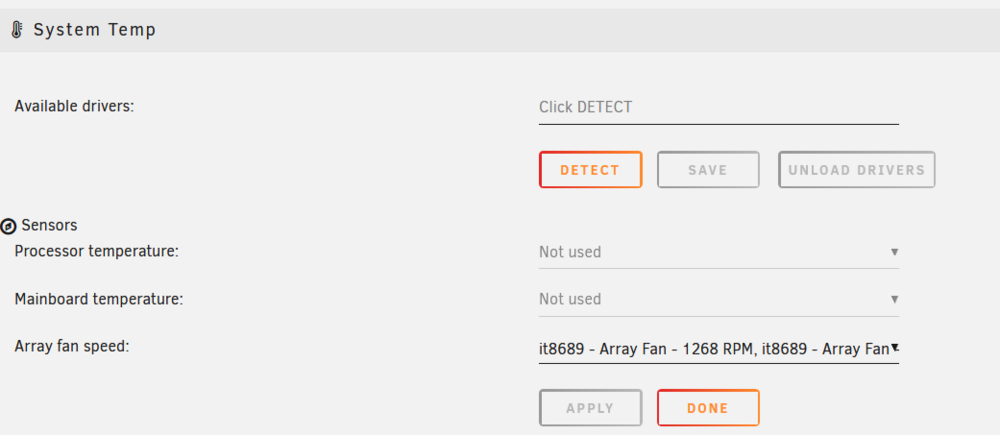

On 12/15/2024 at 10:33 AM, ChirpyTurnip said:
So I have two interesting problems - I have installed it87 and Dynamix System Temperature on a Gigabyte B650M Gaming Plus Wifi board.
PROBLEM #1:
If I run sensors I get this:
root@Skadi:~# sensors
amdgpu-pci-1000
Adapter: PCI adapter
vddgfx:        1.25 V
vddnb:         1.02 V
edge:         +37.0°C
PPT:          29.17 W
nvme-pci-0200
Composite:    +34.9°C  (low  = -20.1°C, high = +83.8°C)
                       (crit = +88.8°C)
Sensor 2:     +45.9°C
k10temp-pci-00c3
Tctl:         +39.6°C
Tccd1:        +30.0°C
it8689-isa-0a40
Adapter: ISA adapter
in0:         780.00 mV (min =  +0.00 V, max =  +3.06 V)
in1:           1.99 V  (min =  +0.00 V, max =  +3.06 V)
in2:           2.02 V  (min =  +0.00 V, max =  +3.06 V)
in3:           2.03 V  (min =  +0.00 V, max =  +3.06 V)
in4:           1.03 V  (min =  +0.00 V, max =  +3.06 V)
in5:           1.12 V  (min =  +0.00 V, max =  +3.06 V)
in6:           1.99 V  (min =  +0.00 V, max =  +3.06 V)
3VSB:          3.31 V  (min =  +0.00 V, max =  +6.12 V)
Vbat:          3.12 V
fan1:        1352 RPM  (min =   10 RPM)
Array Fan:   1268 RPM  (min =    0 RPM)
Array Fan:   1013 RPM  (min =    0 RPM)
temp1:        +31.0°C  (low  = +127.0°C, high = +127.0°C)  sensor = thermistor
temp2:        +54.0°C  (low  = +127.0°C, high = +127.0°C)  sensor = thermistor
temp3:        +39.0°C  (low  = +127.0°C, high = +127.0°C)  sensor = AMD AMDSI
temp4:        +34.0°C  (low  =  +0.0°C, high = +127.0°C)  sensor = thermistor
temp5:        +37.0°C  (low  =  +0.0°C, high = -125.0°C)  sensor = thermistor
temp6:        +39.0°C  (low  =  +0.0°C, high = -125.0°C)  sensor = thermistor
intrusion0:  ALARM
acpitz-acpi-0
Adapter: ACPI interface
temp1:        +16.8°C  (crit = +20.8°C)
nvme-pci-0d00
Composite:    +39.9°C  (low  = -273.1°C, high = +81.8°C)
                       (crit = +84.8°C)
Sensor 1:     +39.9°C  (low  = -273.1°C, high = +65261.8°C)
Sensor 2:     +44.9°C  (low  = -273.1°C, high = +65261.8°C)
But Dynamix System Temp returns nada:
I would have expected it to detect something since sensors definitely returns a pile of data!  What am I missing?

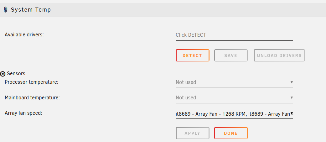

PROBLEM #2:
I had a go at Dynamix Fan Control:
  1. Set BIOS fan mode to PWM
  2. Set Fan speed to Full
  3. Set Fan Stop = Disabled
  4. Set Fan Alarm = Disabled
In system Temp (as per above) it detects the CPU fan and the two case fans. I can click Detect on PWM2 and PWM3 and it finds the fans, and turns then down to 0. And then nothing....but fat nothing. Fans will not come back to any sort of speed.
I have tried setting a minimum PWM of 50 or 128 - it will always spin the fan down and then stop. So, it definitely can control, but it doesn't succeed in restarting the fan, or reducing it down to a lower speed (like it ramps down, but it doesn't hold at say 50 or 128). I've tried with Fan Alarm Enabled/Disabled and Fan Stop Enabled/Disabled. The result is always the same.
Other interesting points to note:
  1. Once the fan drops to zero Dynamic System Temp loses the two array fans (it shows only CPU).
  2. Dynamix Fan Controller will continue to try and control fans (spin up to some value like 63%), but this always fails. In addition it actually starts (unsuccessfully) trying to play with PWM1 - the CPU fan. This is the only fan still reporting rpm at this point....but why does it try to control the wrong fan?
I get the sense that this should work....but I'm not having a lot of luck!
if you increase the minimum PWM value they will start to spin again.
