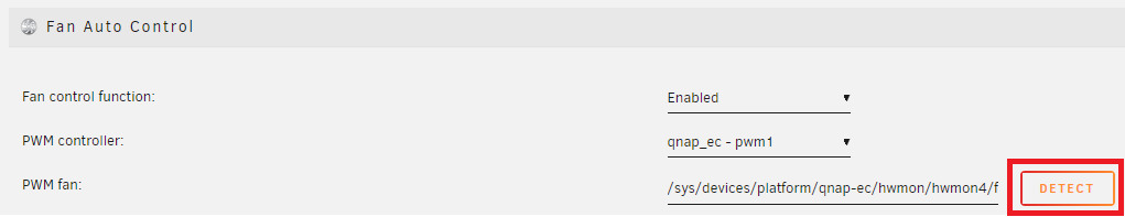

So I believe I spoke too soon...  this problem is persisting.  I'm only able to fix it by selecting 'DETECT' under the PWM fan setting and then choosing apply.  The value in the settings doesn't change when I re-detect it, but it seems to update the setting in the running app.
What I noticed, is that the value in the settings doesn't match what's in the config file.  Settings shows 'hwmon4' while the config file shows 'hwmon2'.  It's as if the settings are not being pushed to the startup config file, although the settings page shows the correct values after a reboot.
I tried to modify the config to match what's in the settings page, but then it returns a permissions denied error when starting.
Any ideas?
Hello, I'm facing the exact same issue (no fan after a reboot until I click on Detect button to force it to start even if the plugin is in working state).
Anybody was able to find a solution ?
Thanks

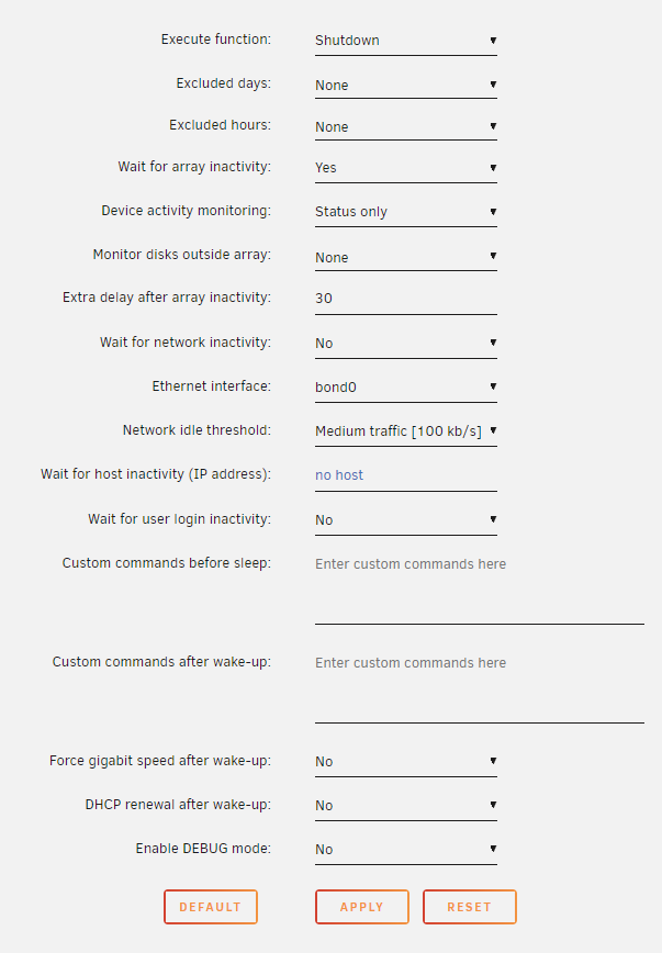

Hi!
Maybe someone can clarify whats going on with my Unraid because i been trying to figure this out for almost 3 days now without luck.
I managed to setup a backup script with user scripts, set mount/unmount scripts and also set a WOL cronjob on my UDM.
I tested manually and it worked fine, BUT only when i put Unraid to sleep with the "Sleep" button in dashboard. This way i can send WOL fine and it wakes up as needed.
But when i use S3sleep plugin, for whatever reason it does not work. I have to press the physical button on the device to wake up again.
i made sure that the NIC is using "g" and everything seems to be set correctly but still i cant get it to work.
Does the plugin do something different besides monitoring activity etc. rather than using the sleep button?
Maybe i could get it to work with userscripts and have it monitor array and network activity as well but i dont know how to script that tbh..
ANY advice appreciated.
TIA!

I might be wrong with my assumption - i think it is related to how long sleep mode is active. If the server is in sleep for like 30-50mins i noticed the WOL is not working. When i check ARP table on my UDM i can see that the server is showing up with the IP but in "HWadress" it shows incomplete.
i assume that the NIC is going in a sort of sleep mode? I know how to prevent this in windows but how do i do it in Unraid?
S3 is enabled but i have not found a specific WOL setting in this bios. i am using a Mini PC from CWWK and it actually has a ton of BIOS options but no WOL setting. It should be enabled tho since it works if Unraid is not in sleep for that long.
Edited by rho
18 hours ago, jojo345 said:
@rho
Since a long time allready I do have following code in the go file to resolve a wol problem with wol.
Didn`t test if it`s still needed, it`s just there since.
ethtool -s eth0 wol g
And as well I found a user script with this code running at startup of the array. 😁
So there was a problem with not setted "g" in the past.
thanks for your input!
altough i think the plugin is doing that already since there is an option in the settings to set it to "g" before sleep.
I will try it still and see if it helps for sure, thank you.
I also tried to add a custom command in the plugin settings before it triggers sleep, which sets a RTC wake up.
Same here - working for like 50mins after sleep but after that it stops working.
I have a strong feeling that my NIC is going to full powersaving / sleep mode or something because in my routers ARP table i can see that there is no arp reply of the unraid machine...
Will post results once tested!🫡

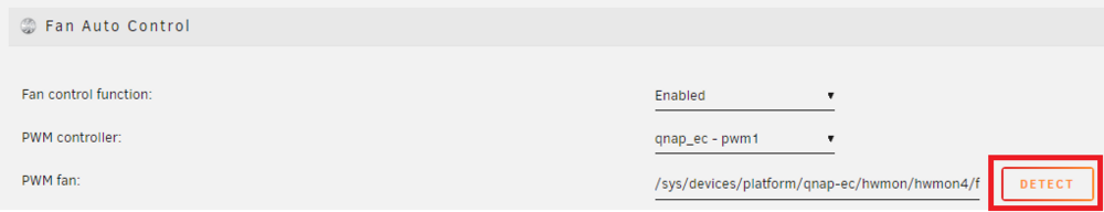

Hey there
Whenever I boot up my machine, the plugin doesn't run (it says "Status: Stopped") until I change something in one of the configurations and click apply.
Is that a bug or is it intended behavior?
