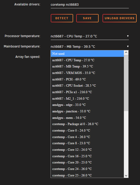

I have also an odd problem with System Temperature plugin, it puzzles me a bit.
It was working for a short time but suddenly after a reboot (I think I was installing the newest intel microcode that time) I see the fans twice and some temperatures look wrong:
216 °C for PICe x1 and M2_1?
Here are the fans:
I can uncheck either the upper or the lower 2 but they are checked automatically again.
If I uncheck all 4, they stay unchecked.
Now, if I unload the driver above, I still see temperatures that I can select, but only 2 fans are left. Some temperature entries are missing with unloaded driver.
To actually see anything in the drop down menus I had to install the Nuvoton NCT6687 Driver first, but now it somehow works without loading it?

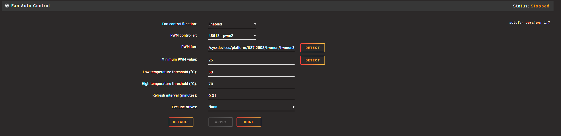

Hi, I'm having problems with system auto fan on Lincstation N1.
Whenever I shutdown/power on or reboot the device the fan doesn't work until I fake a modification in the Dynamix Auto fan plugin settings
The auto fan plugin starts at power on, because I've added the following script to the go file:
# Start Dynamix Auto Fan Control plugin
/usr/local/emhttp/plugins/dynamix.system.autofan/scripts/rc.autofan start &>/dev/null.
Under /boot/config/plugins/dynamix.system.autofan/ i have the config file dynamix.system.autofan1.cfg, with the following configuration (thanks to the forum i know pwm3 is the right one to use):
options="-c /sys/devices/platform/it87.2608/hwmon/hwmon6/pwm3 -f /sys/devices/platform/it87.2608/hwmon/hwmon6/fan3_input -l 5 -t 33 -T 60 -m 5 -e sdc"
service="1"
controller="/sys/devices/platform/it87.2608/hwmon/hwmon6/pwm3"
fan="/sys/devices/platform/it87.2608/hwmon/hwmon6/fan3_input"
pwm="5"
low="33"
high="60"
interval="5"
exclude="sdc"
The cfg file is automatically named "dynamix.system.autofan1.cfg" because there is a pwm2 before the one in use.
I did try to fake a configuration of the pwm2 (read somewhere that the plugin doesn't work if the first pwm of the list is not configured), but it didn't work.
Uninstalled, cleared the config files, installed again and configured, still no joy.
Is there a solution or an alternative plugin to manage the fan?
Is there any hope for this bug being patched anytime soon? Or is adding a script to the go file the only solution? Same issue where I have to manually start auto fan whenever the system reboots.
@mattalat I temporarily solved the problem following the solution provided by @spl147
On 1/31/2025 at 2:40 PM, spl147 said:
stop fan control, delete dynamix.system.autofan2.cfg rename dynamix.system.autofan1.cfg to dynamix.system.autofan.cfg, remove the line from the go script. then reboot, then start fan control
Sadly is not working anymore. Only a manual intervention restores the fan behaviour. Probably something changed after the last unraid update.
Edited by kaneda79

plugin seemed to stop working since the last 7.1.0 update. fans do not stop spinning. did not change anything else except update unraid.
I can confirm the update broke this great plugin (at least for me) and it does not control the fans anymore.
maybe @bonienl can take a look at this issue?
Edited by naddel81

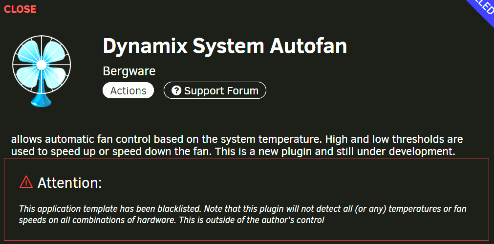

This specific "app" has now been Blacklisted and will not function.
It certainly isn't, and checking it is available without any blacklist...
Checking back on the history, and the reason for the spurious blacklist flag was due to a GitHub issue where it (for 2 hours) didn't follow a redirected URL.
